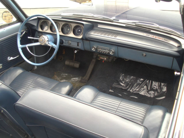

  3. squirrel
    Joined: Sep 23, 2004
    Posts: 59,871
    squirrel
    try 63 Pontiac Tempest LeMans

  7. Lloyd's paint & glass
    Joined: Nov 16, 2019
    Posts: 10,864
    It's the tempest seats that squirrel posted

    I'm trying to recollect where the shift lever was on these Tempests with the trans-axles. I'm not seeing it on the floor or RH side of the column. Did they use a dash mounted lever like the Corvairs? :confused:
  10. squirrel
    Posts: 59,871
    squirrel
    It was dash mounted, similar to the Corvair, but different. The chrome knob is the shifter, the little window tells what gear you might have selected.
    David Gersic and ClayMart like this.

  13. squirrel
    Posts: 59,871
    squirrel
    Not really, it's just a vague shifter with a long cable.
