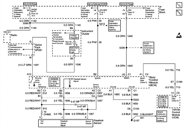

    OK, since you didn't mention what year this thing is, here is the schematic for a 2000 M van with "passlock" security. It doesn't read a chip, it just takes a signal from the ignition lock cylinder so if some underhanded crook busts out the lock cylinder, it won't start. There are no paralell circuits, just the harness from the passlock sensor to the BCM, the BCM uses class 2 data to the VCM to inhibit start. If you have the original key that should be ok. This isn't an alarm system.
