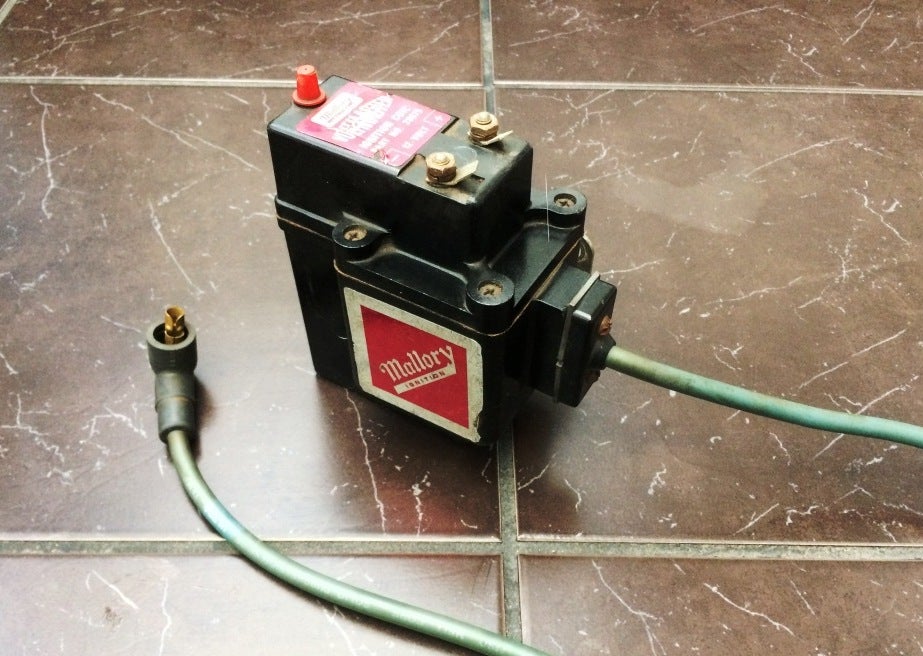

  9. Elcohaulic
    Joined: Dec 27, 2017
    Posts: 2,213
    Elcohaulic
    I like the Mallory Volt Master coil..
    #28675 for regular 12 volt coils with points..
    #28880 for CD ignitions.
    #28670 for 6 volt cars..
