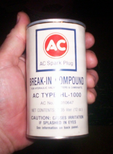

    I've always used AC Break In Compound (PN 25010647). It's a division of GM,so I figured it'd be pretty good stuff. Since I saw this thread, I ordered another case.
    I'll agree with Bruce, since GM engines all come with hydraulic roller lifters now and anything over ten years old is obsolete, they're not gonna stock break in lube. The aftermarket cam manufacturers will have to step up and sell the break in lube for their cams, or deal with the flat lobe problem. Looks like Crane has stepped in and sells Zinc additive.

    I don't know how to tell you this, but that one's been discontinued as well.

    Larry T
    If they don't have a case of it at the warehouse, I guess I'll get the Crane additive (when I've used the case of AC I have on the shelf now).
