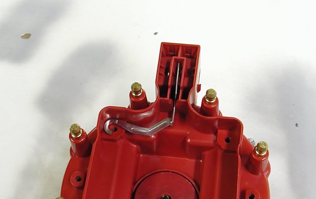

    Here is a picture of the often missing ground strap. End of the strap goes into the middle hole on the HEI wire plug. I stole the picture off the internet (from a Jeep forum, no less) but it is the best one I could find. :)
