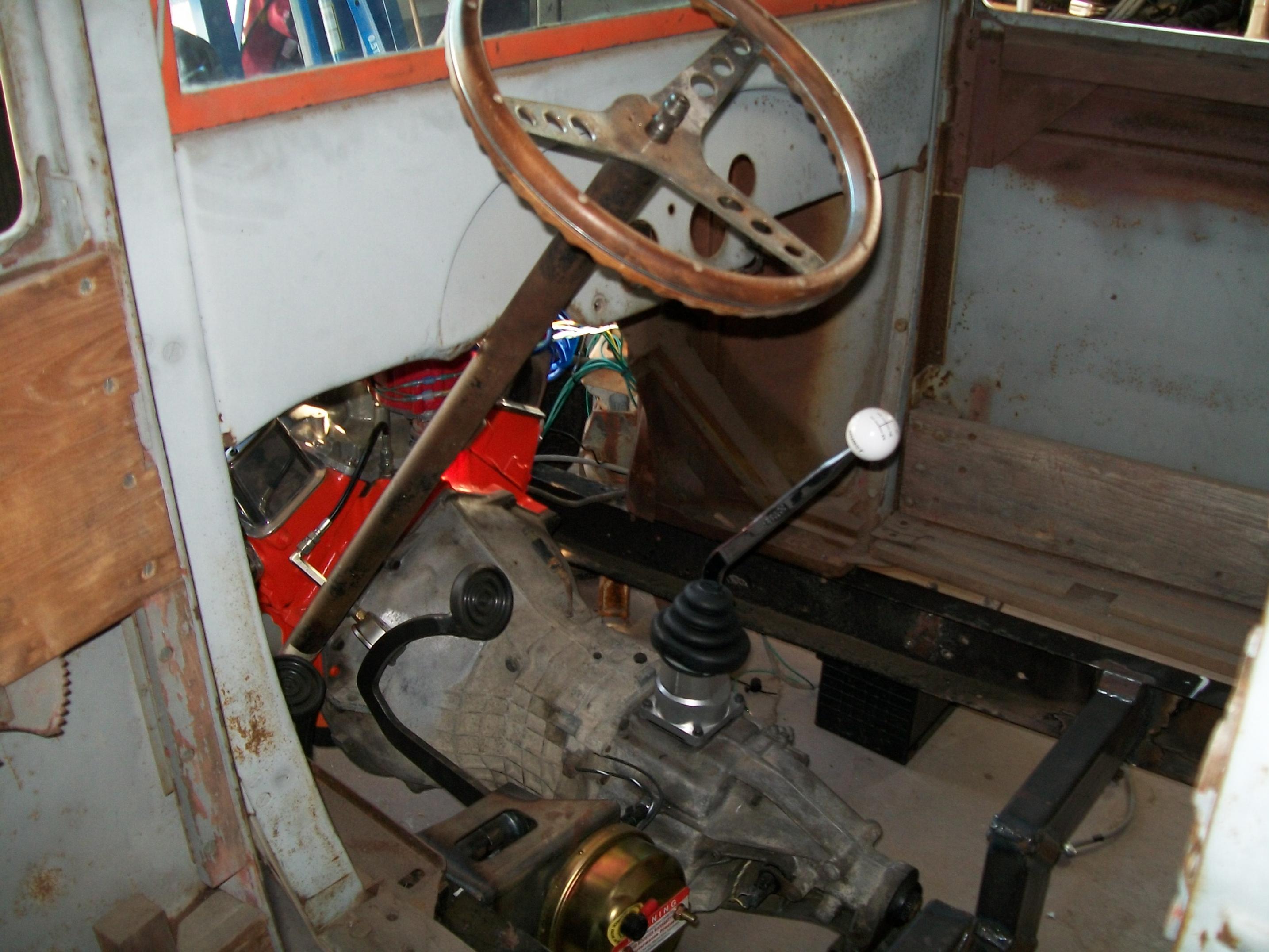

    I am just putting my set up together here is what I used,
    1. 2004 GTO throwout bearing
    2. pre 86 168 tooth flywheel and clutch kit
    3. Pete & Jakes model A brake and clutch pedal kit(2040?) with a wilwood mc with a 3/4" bore. stock on the GTO was .70 so I am at .75 should work fine.
    4. trans is out of a 1999 S-10.
    I'll post pictures when I get it all installed, the shifter falls right where I need it in my 31 A coupe. I payed more for the pete & jakes stuff than the trans. This all on a sbc 350.
