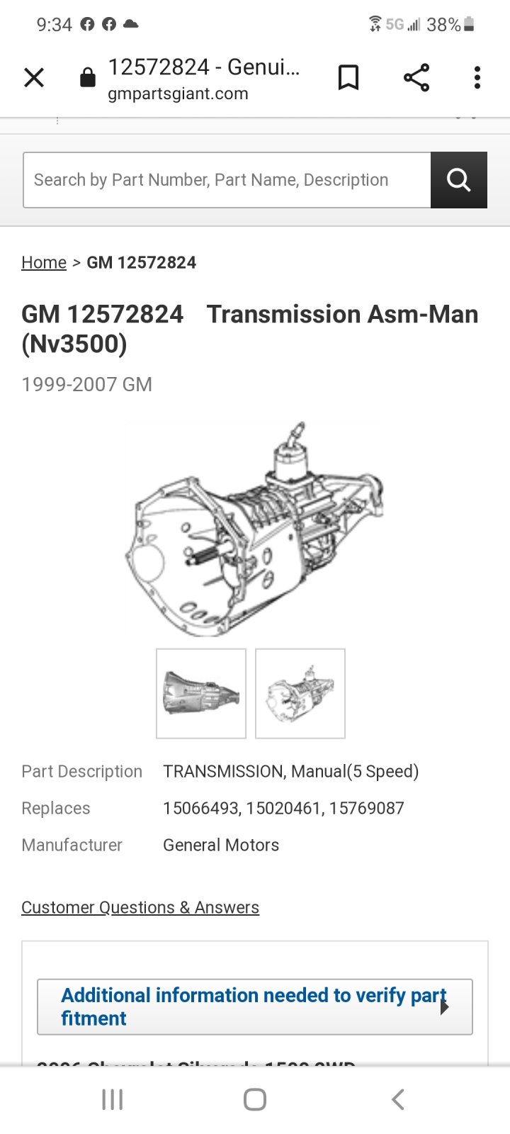

    I went based off of this application chart when I ordered. I thought the earlier versions had the slave cylinder and the 99-06 have the internal setup but the rest was the same.
  12. gimpyshotrods
    Joined: May 20, 2009
    Posts: 24,378
    gimpyshotrods
    V8 pattern has not changed. Some have an extra bolt at the peak, an some are missing a bolt at the 1 o'clock position.
    Stuff got a little weird in the LS era, but the basic pattern is the same.
    Over-the-counter replacement transmissions, if I remember correctly, have all the bolt holes, so they can have one part fit everything.

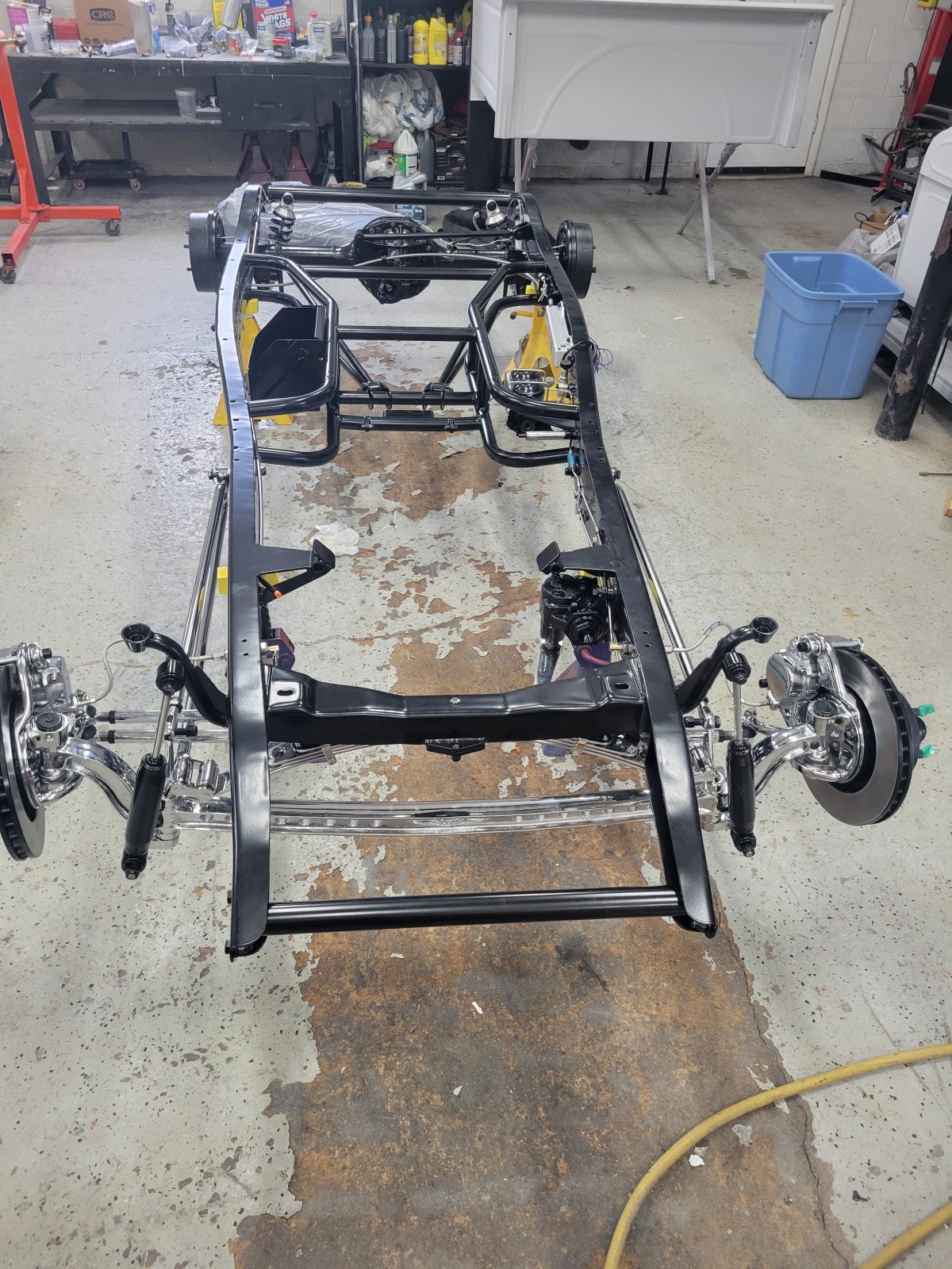

    Thanks for the clarification. I knew the HM290 bolted right up as I used it for mockup and I was almost positive the only difference in the case with the later NV3500 was the holes in the bellhousong for the hydraulic lines. I've been waiting over a month but supposedly the trans is shipping Monday so hopefully it all works out. Like I said I know it's not rated for the power of this crate engine but I don't plan to beat on it. And the tires and light rear end will still be the weakest point. If it does grenade down the road I have access to the equipment for cryo treating and I can attempt to beef it up.
    After 8 years of fab and acquiring parts I can finally see the light at the end of the tunnel. Chassis with all steering, suspension, and brakes are all done. Engine is painted and intake is on. Waiting for dress up items to finish it off and I can put the driveline in and focus on painting the cab and bed next. 20210917_151528.jpg 20210909_163502.jpg
