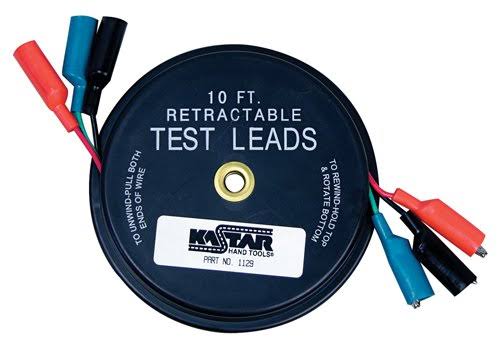

    I got a couple of these , one 24’ long
    they work great for testing all kinds of **** on all kinds of different **** !

    Amazon has 17 AWG in 3.3 foot lengths, alligator clamps each end, insulated. One black one red. $6.50, Prime free shipping.
    E-Z way out.[​IMG]
