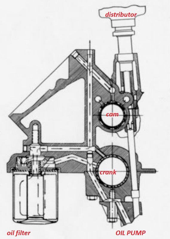

    Have you guys tried checking the pressure at the port above the filter or the port above the timing chain ?
    egads likes this.
  16. Wrench97
    Joined: Jan 29, 2020
    Posts: 685
    Wrench97
    That p***age is a straight shot from the oil filter.
    mad mikey and iagsxr like this.

  18. iagsxr
    Joined: Aug 26, 2008
    Posts: 298
    iagsxr
    I wasn't picturing the oil path correctly.
    If it has oil pressure at the port above the filter and not at the top of the block it can only be the hidden galley plug or a physical obstruction in the port.
