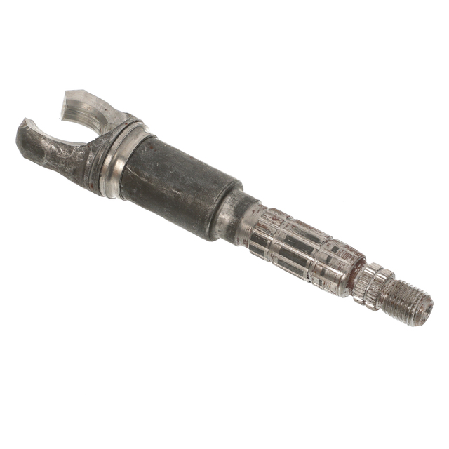

  14. Joe H
    Joined: Feb 10, 2008
    Posts: 1,888
    Joe H

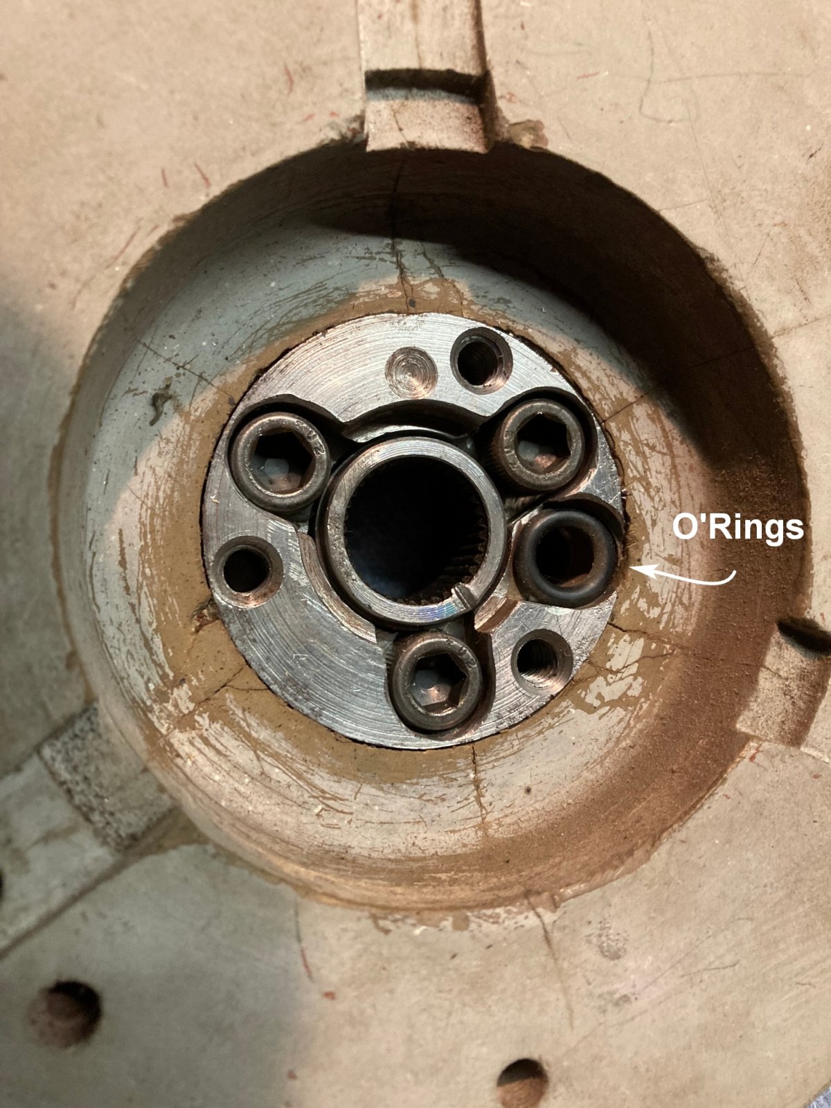

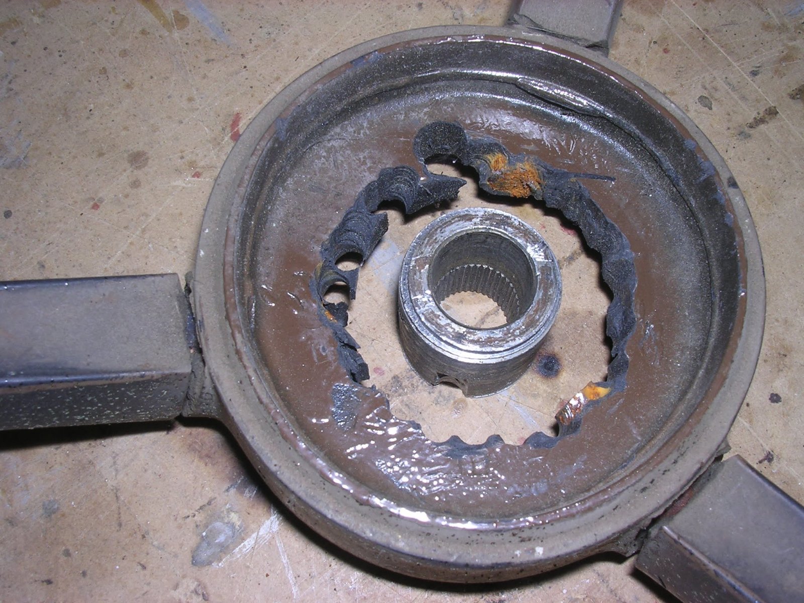

    Not sure I understand the setup you have but maybe this will help? I am building a '40 Plymouth and wanted to use the stock wheel with a modern GM tilt column. They both have the same diameter but slightly different splines. Here is how I adapted them.
    I bought a GM tilt column stub shaft on ebaY.
    Then I cut off the spline section and put it in my lathe. I turned the splines slight smaller on one end, slightly larger diameter in the middle third and left them full size in the final third
    Then I heated it red hot and quenched it in water hardening it. This gave me a stepped broaching tool.
    I pressed this tool through the wheel hole, cutting GM splines in it. Result was a perfect fitting wheel/shaft.
    Moondog13, cederholm, lostone and 6 others like this.

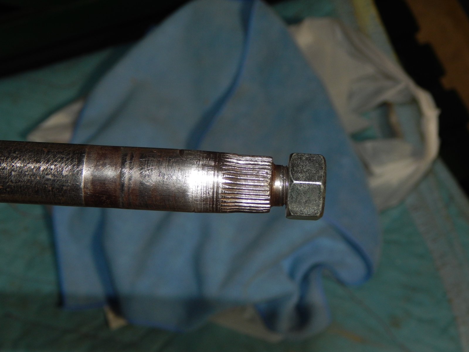

  22. Joliet Jake
    Joined: Dec 6, 2007
    Posts: 544
    Joliet Jake
    from Jax, FL
    I cut the "keyed" end off of my F1 box shaft. I had someone send me 12" of a splined early 60's steering shaft. I weld prepped and clamped the two shaft ends in a V block to keep them straight and welded it up, done deal, now I can use my 1959 GM wheel on my F1 box. IMG_4963.jpg it was easy. Now I can

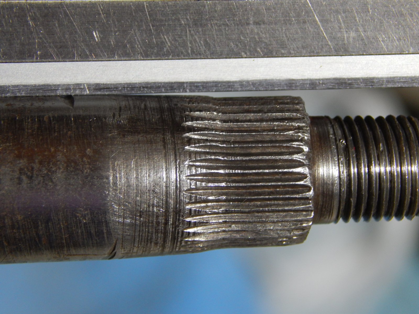

  25. nochop
    Joined: Nov 13, 2005
    Posts: 4,613
    nochop
    from norcal

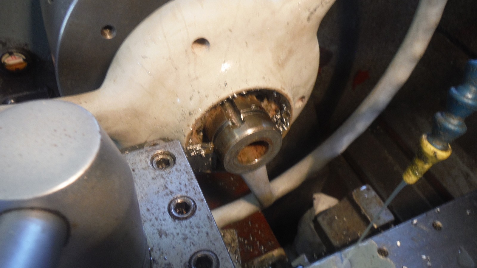

    per willys36;
    "I am building a '40 Plymouth and wanted to use the stock wheel with a modern GM tilt column. They both have the same diameter but slightly different splines. Here is how I adapted them.
    Dang ! great solution!

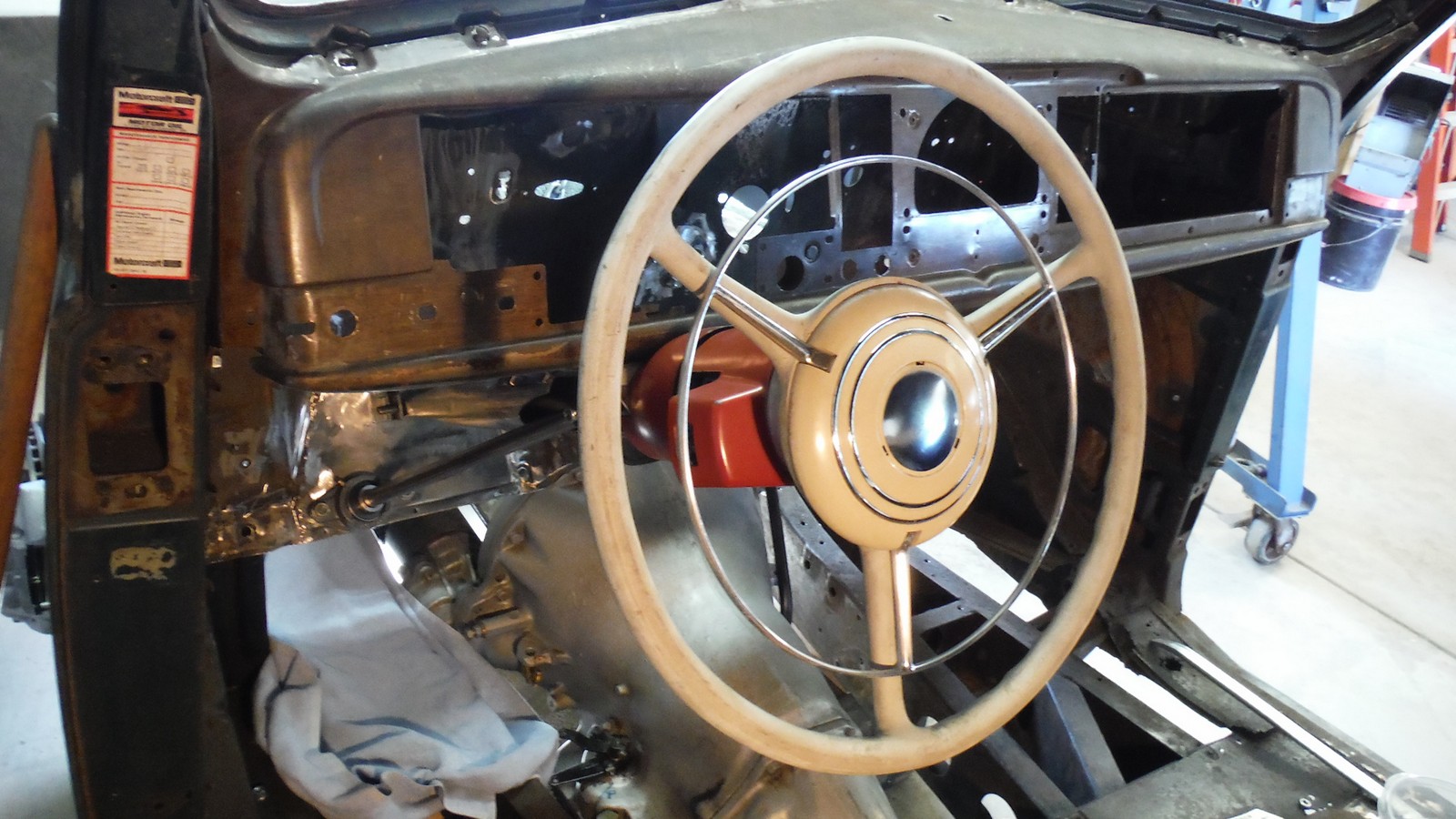

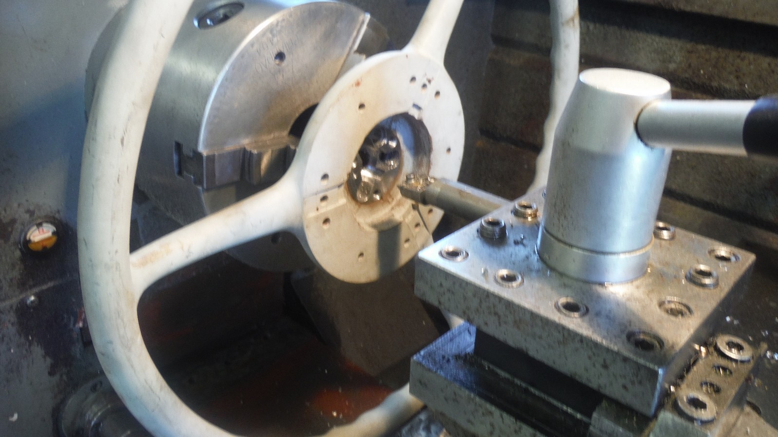

    I took a more circuitous route when adapting the '40 Chrysler steering wheel to a 78 Malibu column.
    Bore out Chrysler hub to fit turned-down GM hub;
    Drill & c'bore locations for Socket Head Cap Screws;
    Mount GM hub to Chrysler wheel (O'Rings are for horn contact stem); Top View_1.jpg
    Finished 16" (from 18") wheel mounted to 78 Malibu tilt column; Steering Wheel Offset_1.JPG

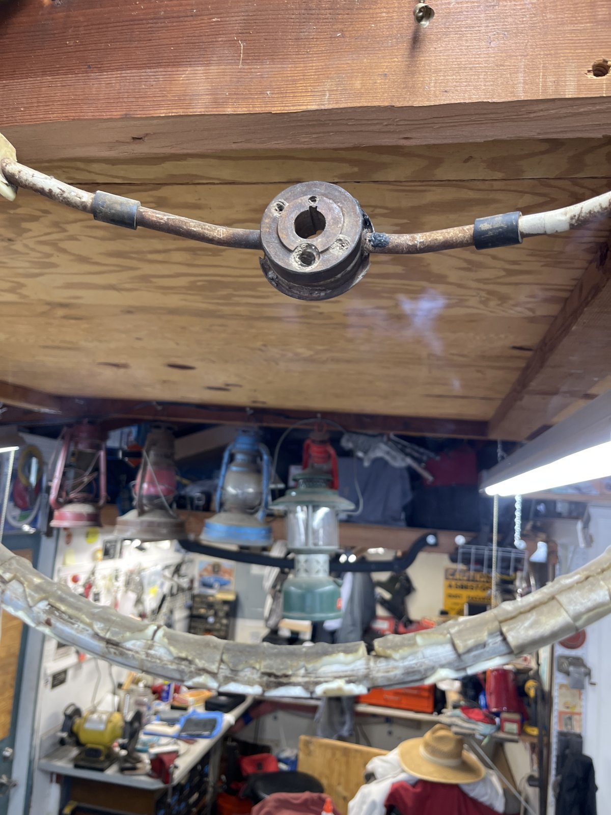

  28. cederholm
    Joined: May 6, 2006
    Posts: 1,754
    cederholm
    Not to hijack, but what do you guys know about Packard steering wheels? I've picked one up. Splined but a larger diameter than my F1. Any idea if its a Packard only, or the same as another manufacturer?
