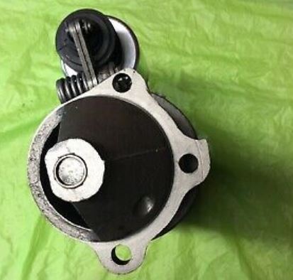

    Is the lug supposed to have these half moons or has it already been flipped? 20210902_095654(1).jpg

    Yuppers, that one was already flipped once. Some of the gypo rebuilder shops actually do that rather than put a new one in. I've flipped a lot of them myself though.
    A search doesn't bring up replacement pieces.

    Thanks guys. Well I promised the wife a drive while the top is off, so I was able to file the indexing rectangle into a square and rotate it 90 degrees. Starting every time, hopefully get a few more months of starts. I briefly saw some rebuild kits online, will look again.

    Rotated 90 degrees. Like said above, with a file and you can get 4 sides instead of 2. Less contact but it can still carry the load.

    It's been rotated 180 degrees once already. You simply unbolt it from the front side and rotate it 180
    degrees and then re-tighten the nut.

  11. What were the symptoms before the fix?
    blowby likes this.

    It would click and engage the gears but not spin the starter. Shorting from the battery to the starter lug would start it.
    For pre-'57? Different animal. Anyway the lug and washer are the only wearing parts. Can always be started with a screwdriver across the lugs, or push started. I am going to replace both when I have the parts and summer is over.

    Funny, the battery stud on mine was near perfect, only the starter side lug was bad, maybe that's the way they go. The washer was fine, just a quick cleanup. I'm guessing that with the 90 degree rotated lug, missing some of the contact area, it may only last a few years..

    This is my first experience with the pre-1957 style starter. It does not use the large spring over the solenoid piston like the later ones. I don't remember how the return spring works, maybe it's this one, and it's back in the car and working now, but I do remember it takes a lot of force to move the gear out by hand, more than I remember the later ones taking. At first I thought that may have been the problem, the solenoid not having the power to pull the copper washer all the way to the lugs, but not the case. I'm still surprised it has that much power.
    Also, as shown in this photo (not mine), where the piston bolts to the linkage it's an adjustment slot, not just a hole. Didn't notice until I had it apart (to replace the rubber boot) so I just put it back where it was, as best I could tell.
