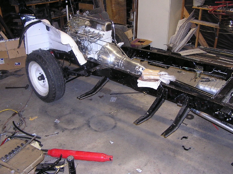

    Put a 200R4 in my '53 king cab behind a warm 235. Used a commercial adaptor plate/flywheel (Chevs of the 40s? Can't remember who's). Worked like a champ. They are very easy to rebuild.

    I made side mounts for my '53 pickup using 3/8" plate. They screw to the adaptor with countersunk 3/8" flat head bolts from the transmission side of the plate. I used old Ford type rubber donut engine mounts on the frame.
