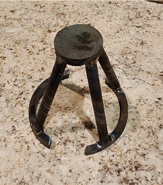

  18. garyf
    Joined: Aug 11, 2006
    Posts: 373
    garyf
    I have made a spring compressor for the clutch drum spring with threaded rod, s**** steel and mig welder. A 25 gallon metal barrel with the round opening flattened on one side, will grab most transmission cases where the back of the pan bolts up. Makes a perfect height transmission stand to load all your rebuilt innards into trans case with tail shaft down..The thin metal tool snap on provided on their toolboxes to remove the drawers,worked perfectly with Vaseline to aid installing servo and drum lip seals. Threaded rod with a driver to make a slide hammer to remove the front pump. Cut the heads off the correct size and thread bolts, to align the front pump back into case on re***embly.If you take the front pump apart to clean or inspect gears,instead of buying a realignment band,with the pump halves loose carefully install pump upside down in empty trans case, tighten pump bolts,the halves are now aligned, remove and reinstall.

  22. gimpyshotrods
    Joined: May 20, 2009
    Posts: 24,568
    gimpyshotrods
    The bench clamp is cheap enough that I bought a second one, to cut up and widen to hold a TH425.
    That has the lugs in the case, but they are out of range of a regular clamp.
