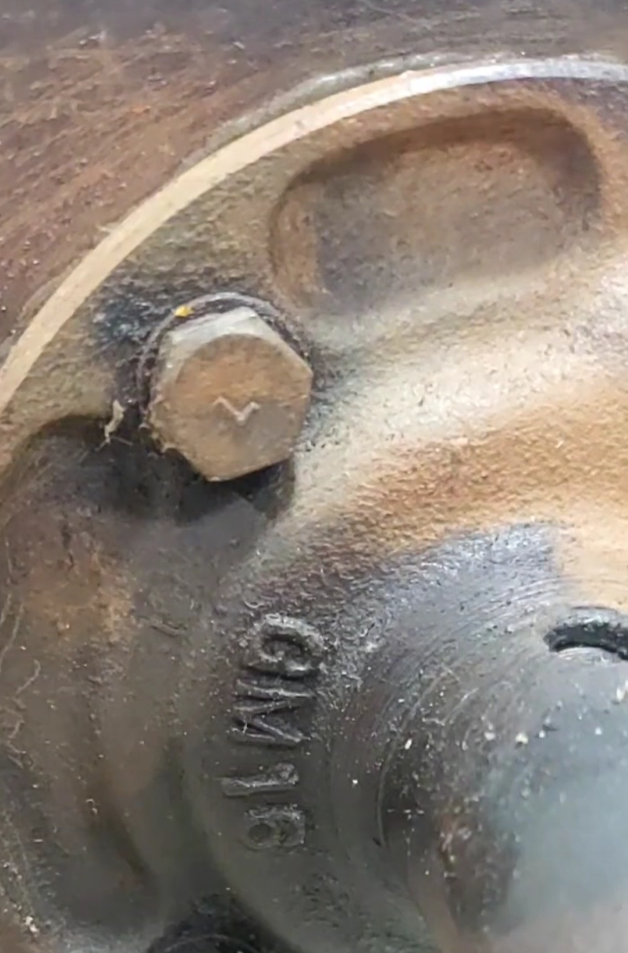

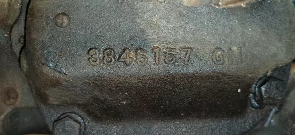

    Im hoping yall can help me figure out what looks to be a GM 3 speed OD..? & whats its application would be.
    I got all of this together years ago. Cleaning shop and wondering if its junk & I should toss it out or if its worth keeping for one of my own builds. I have all the linkages & the driveshaft as well. Screenshot_20231019_114019_Gallery.jpg Screenshot_20231019_113938_Gallery.jpg Screenshot_20231019_113331_Gallery.jpg Screenshot_20231019_113612_Gallery.jpg Screenshot_20231019_113220_Gallery.jpg Screenshot_20231019_113137_Gallery.jpg 20231019_110825.jpg
    I had no luck searching any of the #'s

    Chevy 3 speed overdrive, but it's upside down. Used from 55-64 mostly. the cars didn't have a rear mount pad until 58. Trucks used a case with threaded lower mounting holes up front, to match the bellhousing which had through holes.
    The solenoid is worth about as much as the whole thing is worth, if it works.

    Trans has the std GM bolt pattern on the front where it bolts to the bellhousing, will bolt to a bellhousing with the same pattern, whether 6 cyl or V8. Only issue is the bearing retainer diameter, trucks typically used larger diam than cars.

    The transmission would fit 55-80s or so cars and 55-67 trucks. With either V8 or 6 engine. They were used till the mid 60s, when most switched to the Saginaw 3 speed.
