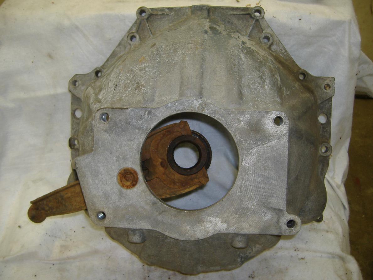

    Anyone ID this dual pattern Chevy, BOP bell housing?

    Yes that is a Chevy and B.O.P. pattern. I have one just like it in my 39. I Don't know what it came out of.

    82 f-body - one year only. cool piece.

    buick-olds-pontiac (and cadillac). In other words, not chevy.
    the BOP bellhousing bolt pattern was used starting in 64 on some BOPC cars, and on all by 67
    using google shows someone lists this bellhousing application:
    1982 V8 F body (casting 14037657; Figure 5-7) for 153-tooth flywheel; Chevrolet/BOP; use with clutch fork: GM 14037647
