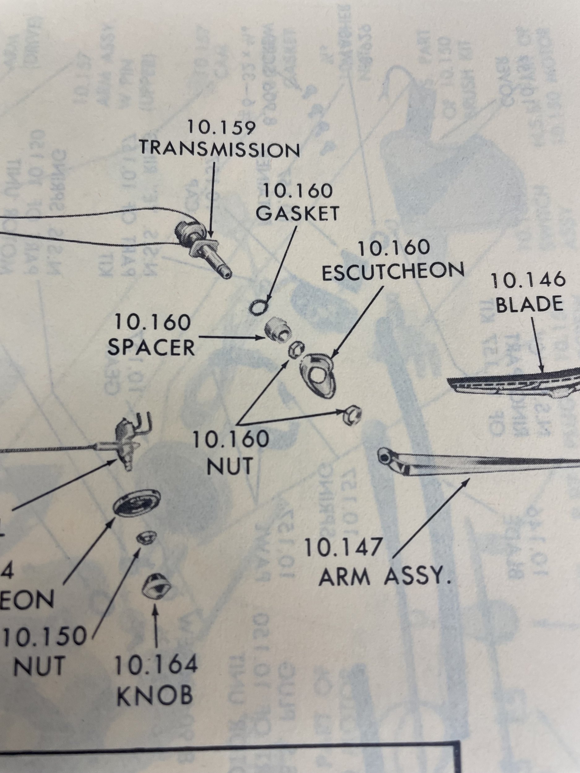

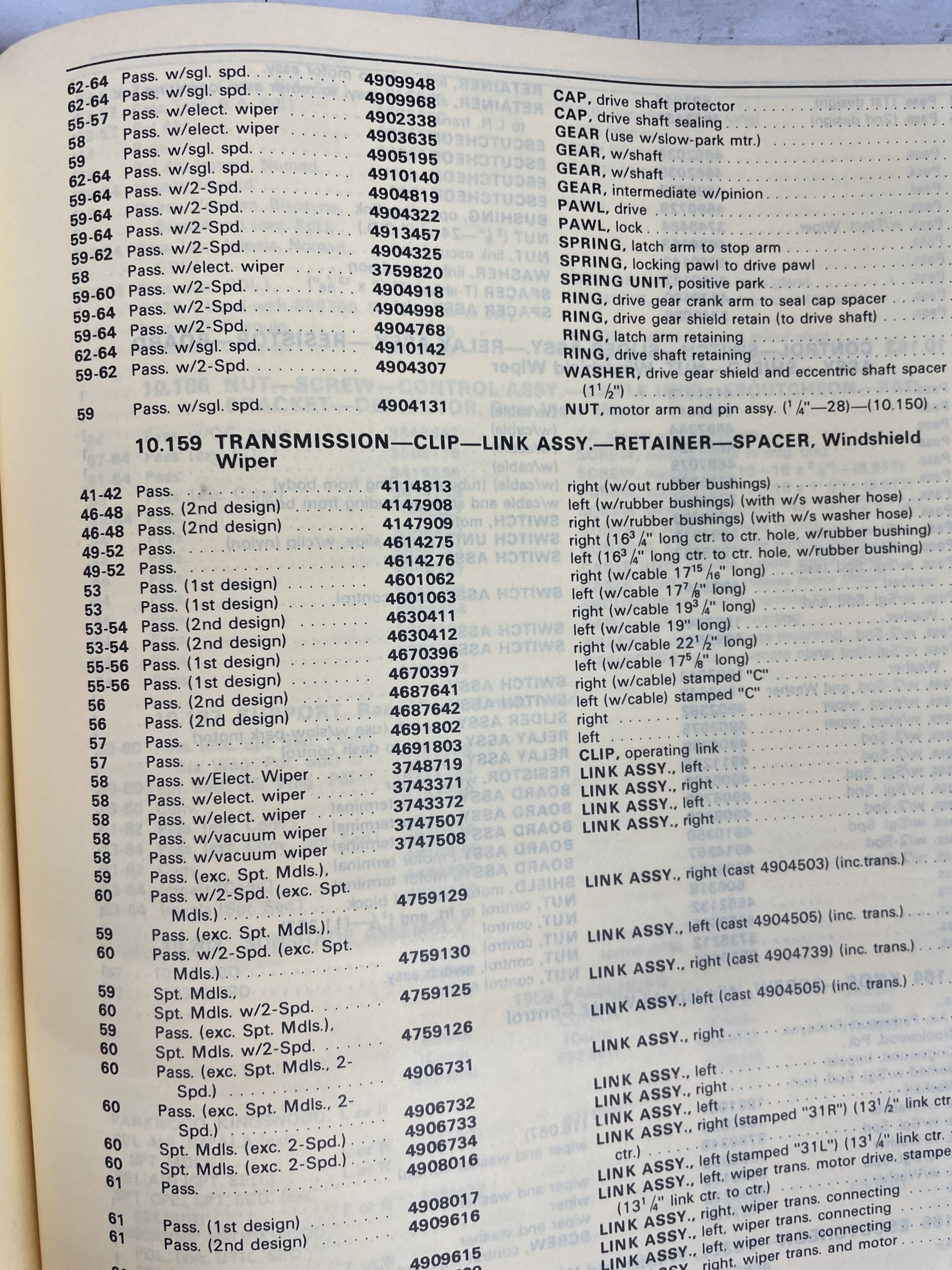

    The only parts book I have is Chevrolet. I looked up part type 10.159 and the oldest listing was part number 4114813 for 41-42 Chevy. I did a google search and didn’t see any crossover for fitting anything else IMG_3088.jpeg IMG_3089.jpeg

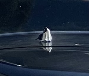

    IMG_0172.jpeg IMG_0825.jpeg I think GM in 1940 specified wiper transmission (10.159 Transmission, Windshield wiper remote control) application by body type - Special, Standard, Torpedo - across the divisions.
    Chevrolet, Olds 60 series, and Pontiac Special Six with Special bodies used one ( Olds # 4101960 R.H. and 4101961 L.H.).
    Buick, Olds 70 series and Pontiac with Standard bodies used another (Olds # 4099339 R.H. And 4099340 L.H.).
    Buick 50 Super and 70 Roadmaster, Olds 90 series, Pontiac with Torpedo bodies, LaSalle 52 and Cadillac 62 used another (Olds # 4099341 R.H. And 4099342 L.H.).
    This info comes from the 1940 Oldsmobile Master Parts List and the Fisher Body Manual 1939 and 1940. I’ve attached a photo of the wiper transmissions on my ‘40 Olds series 60 and ‘40 Olds series 70 (photo with wiper arm attached).

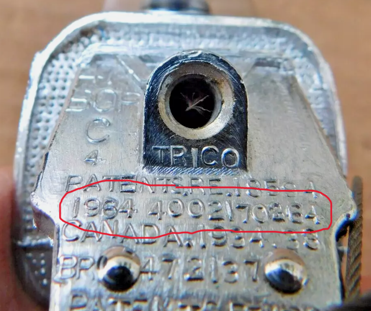

    Interesting that one of the patents is from 1964.

    That is strange! Maybe they can renew them and continue being the only ones that can produce them?

    I thought patents had to be renewed every 50 years? Most are not simply because the design and specific use has changed so much, the original patent no longer applies.
    Maybe Trico purchased the original patent from GM in 84, when the original patent was about to expire, and wanted to be the only people that can reproduce the parts.
