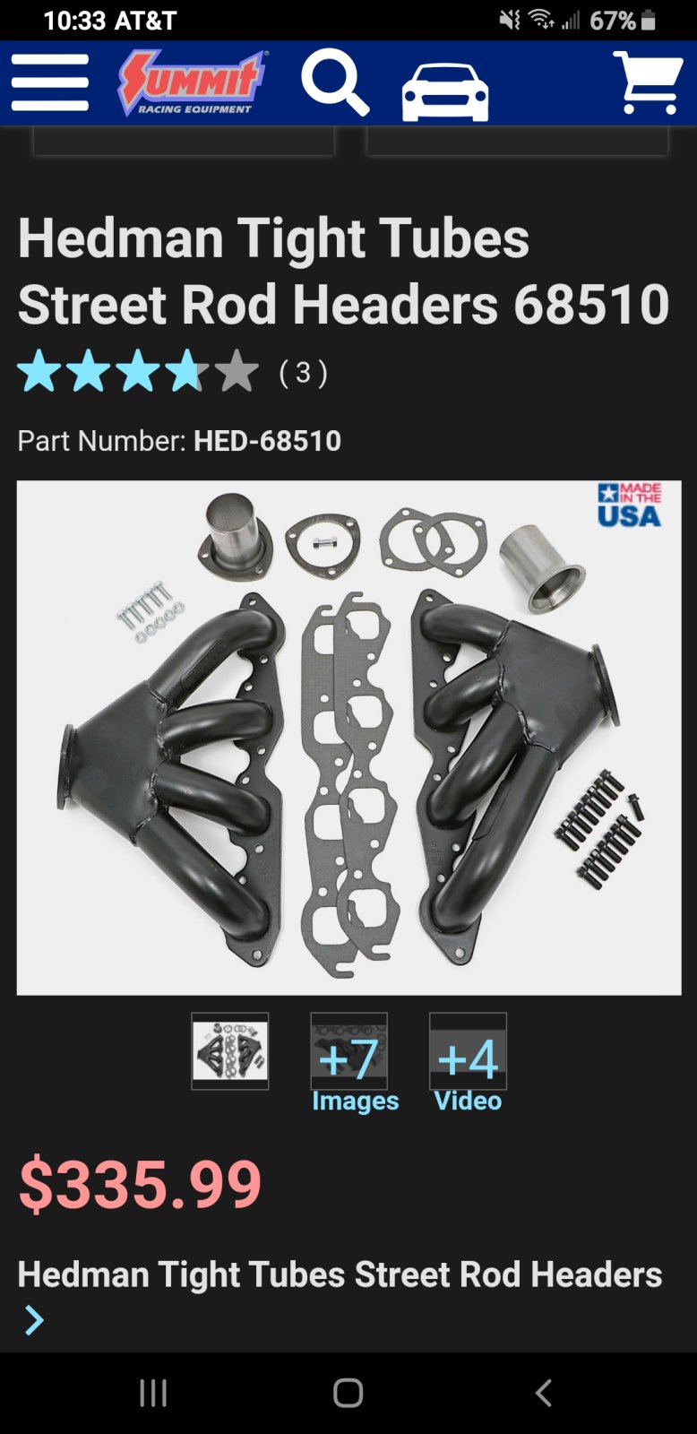

    Got a '64 Coupe DeVille with a Mark IV Big Block Chevy in it and I'm not finding any shorty or 3/4 length headers for it.
    The car is low so I can not run full length headers on it.
    Anyone know of any headers for said application?

    Will these work? I'm running shorty's on my small block X frame

    Thanks, unfortunately I don't think driver side collector will clear the steering box.. I need something that has more of a rear dump...
