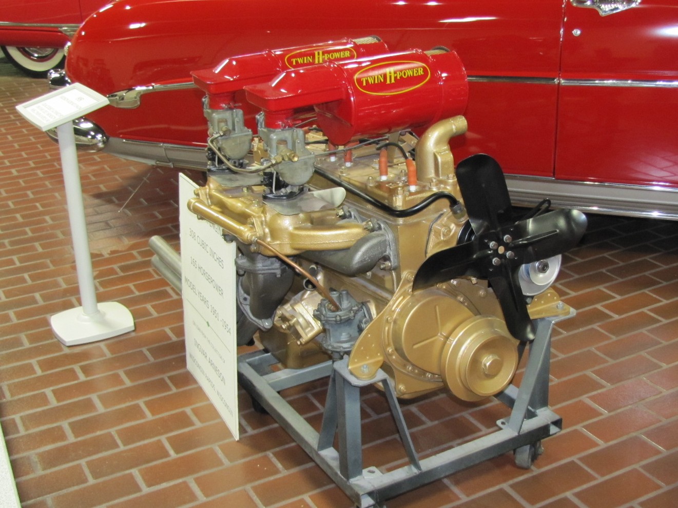

    It looks like all address the cable running to a carb setting on a V8 manifold.
    My quandary is how to adapt it to an inline six that has dual carbs setting off to the p***enger side
    and has the pedal linkage running across the head over to the carbs.
    https://bangshift.com/wp-content/uploads/2019/03/Hudson.jpg

    I am wondering why you could not make a tv cable bracket that would fit/be part of the gas pedal linkage instead of at the carburetor.
    As long as the cable is moving in the proper arc and distance to operate the trans properly?
    What am I missing?

    Doesn't sound easier to making one that works at the carburetor.
