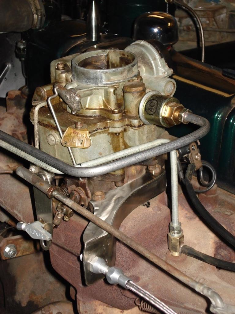

  8. benke
    Joined: Jan 7, 2007
    Posts: 11
    benke
    When I installed an th200r4 in my straight eight Buick, I’ll got a tv-cabel from Lokar.
    Made my own brackets, some tricky adjustments, but it has been working since 2007.
    Before engine was rebuilt
    And after
    Gunnar
