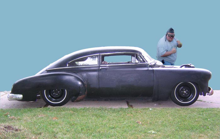

  19. Hey Cyclebilly, sorry bro. I didn't mean to imply that it was 50Chevy's. That's one badd car. How much did you take out? Anything you would have done different or pitfalls to watch out for? You got any pictures of the rear end so I can see how you finished off the area between the trunk and the bumper? Thanks.
    Here's a photochop with about 4 or 5 inches taken out. If you're gonna chopit, might as well chop it, right?
  20. Circus Bear
    Joined: Aug 10, 2004
    Posts: 3,238
    Circus Bear
    Is that chop keeping the stock windshield.
  21. Cyclebilly
    Joined: Apr 4, 2004
    Posts: 465
    Cyclebilly
    from Chicago
    I took 5-1/2" out of it. The a pillers shold be easy,just pie cut them to fit. you will have to move the b pillers back which shouldnt be a problem either. im assuming your going to shave the gas door right? because when you lower the trunk area the tube that the filler runs through might be in the way and you might have to cut it out. It wasnt a problem for mine cus i have the gas fill in the caddy tail light. The area between the trunk lid and the bumper is tricky. I can email you some detailed pictures of the back half if you want. I made a latch for the trunk and never even installed it. the weight of the trunk lid holds it down good.
  22. Nope, the windshield is cut two inches and layed back a few degrees.

  24. Ya got a better shot of the trunk/rear glass area, from side, Trent-It looks a little funny in that pic......like a chopped top with the stock lid in it's stock location? ..........could be jus me!:D
