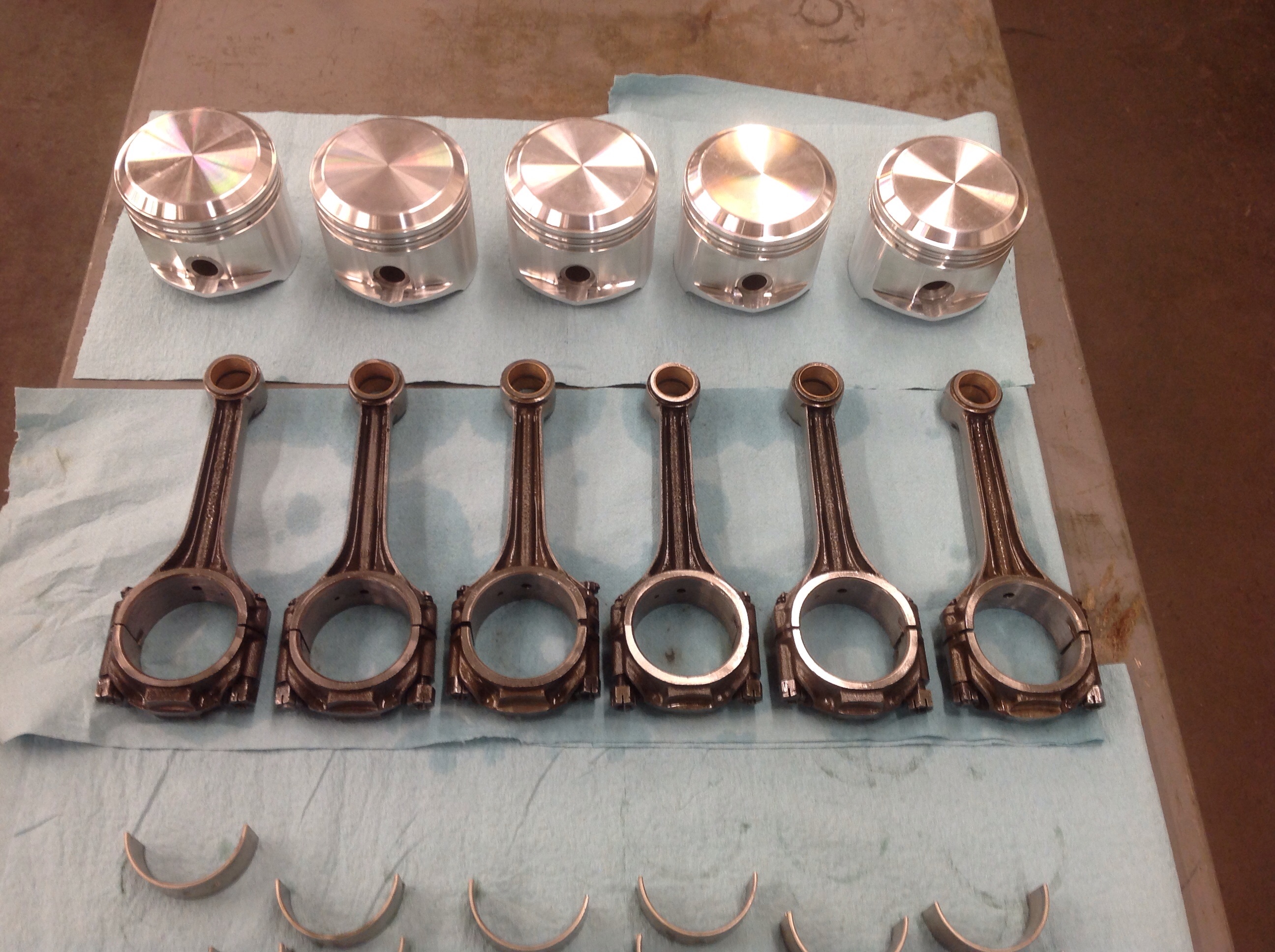

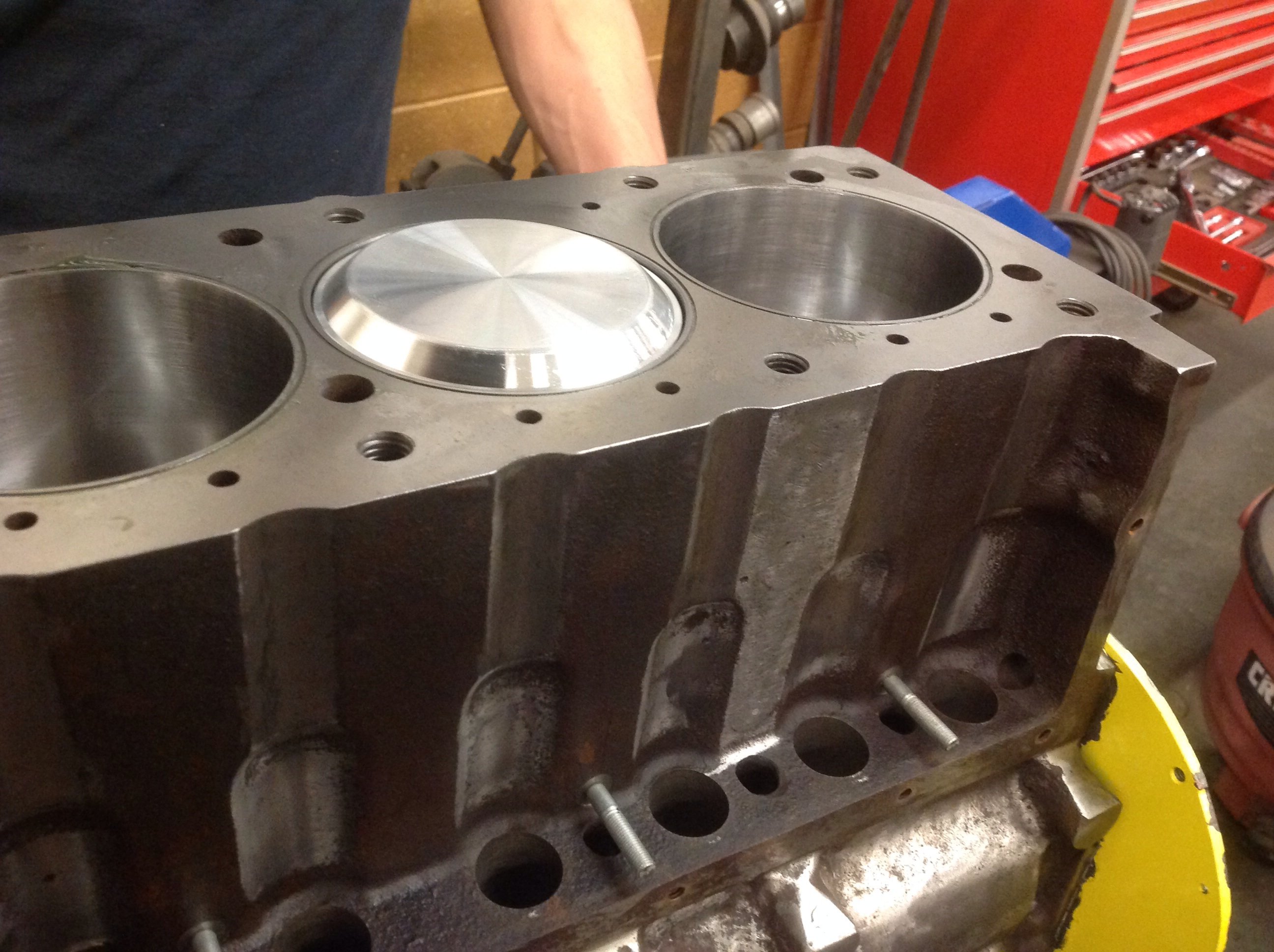

    image.jpg image.jpg New motor 321ci. 14.5/1 .
    We should have it at the northwest nostalgia race this weekend.

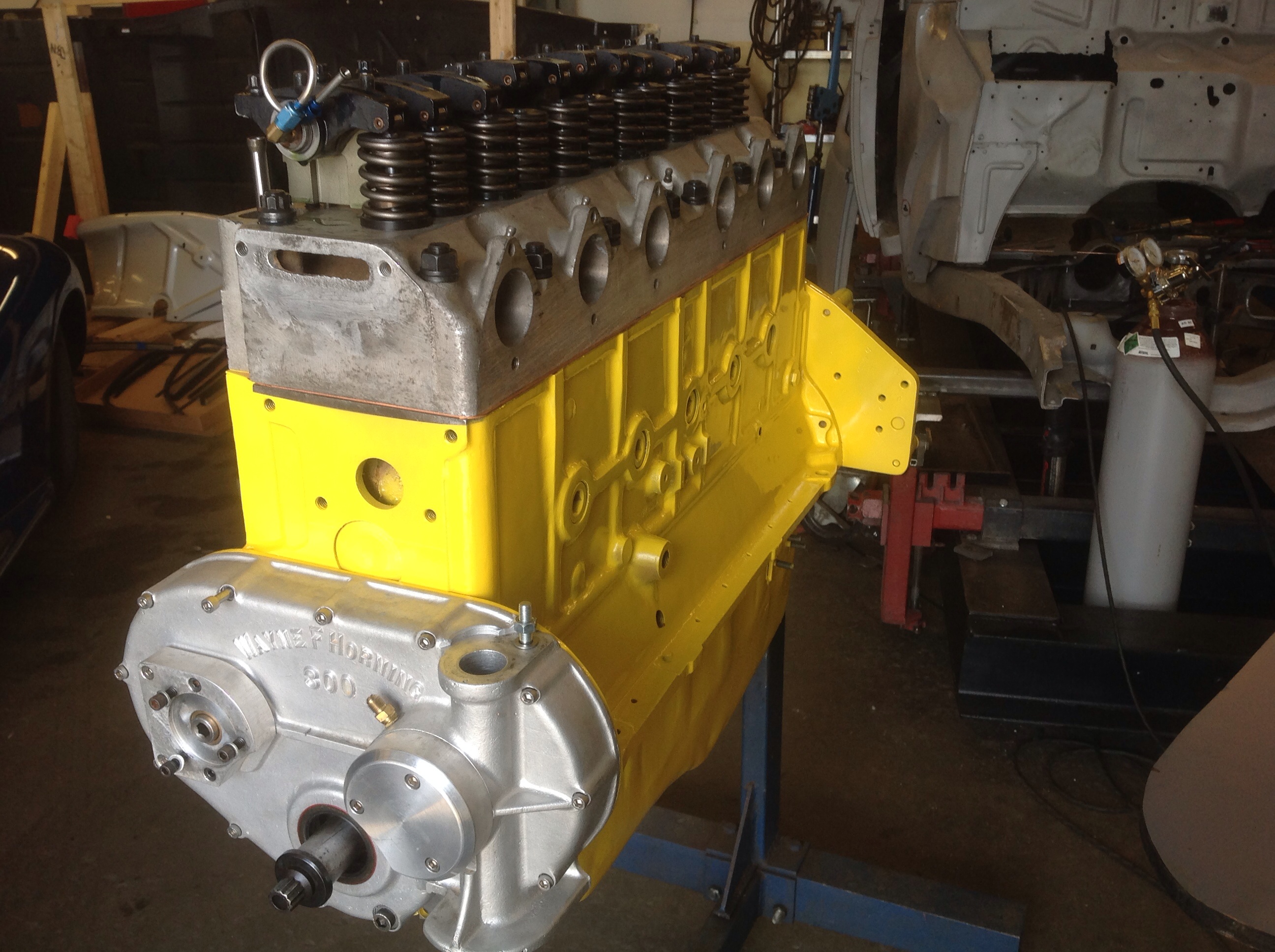

    image.jpg It's getting close

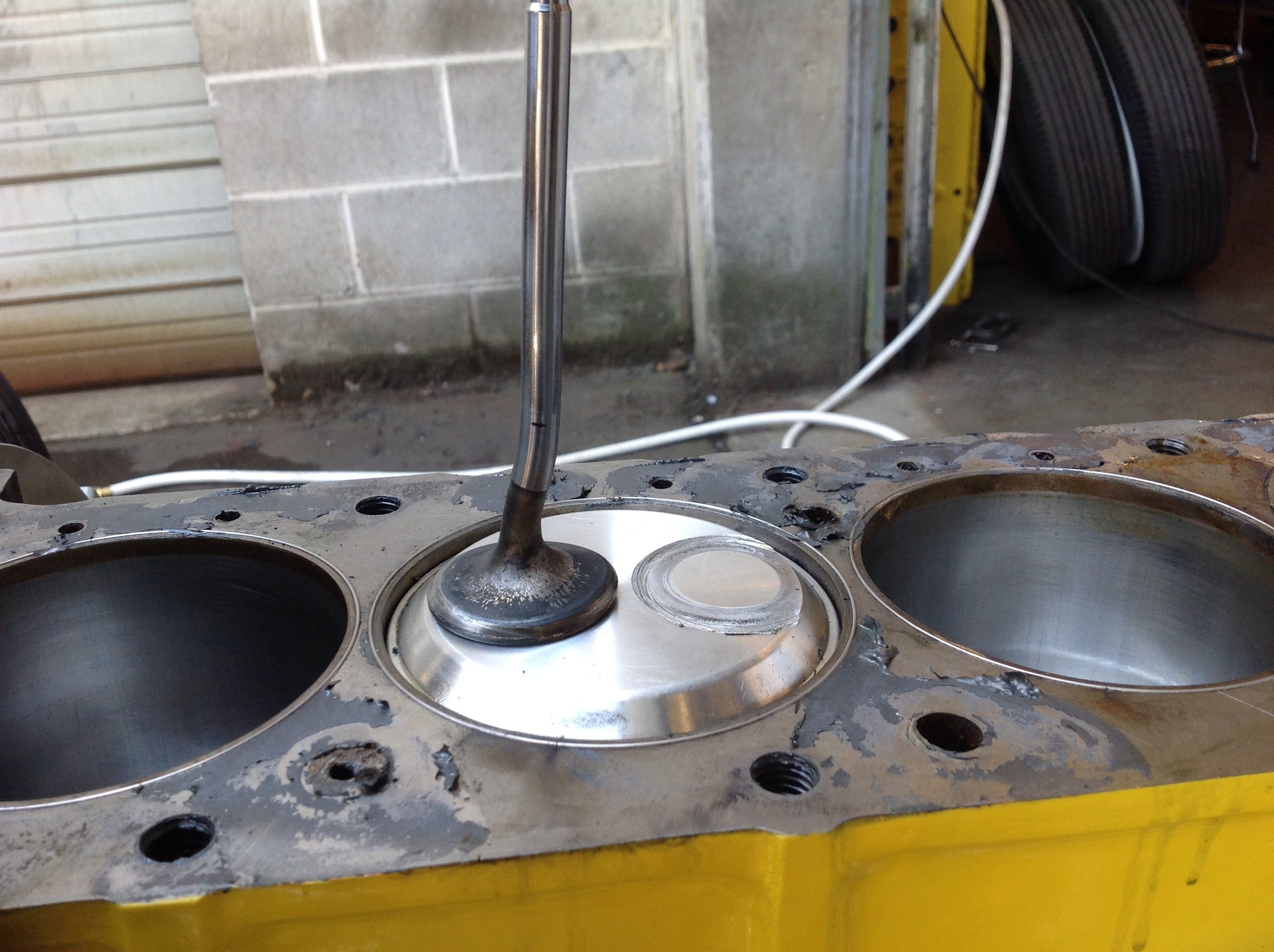

    image.jpg Missed a shift

    Was that with a load of nitro?
  18. marshall
    Joined: Mar 19, 2001
    Posts: 782
    marshall
    from tacoma/wa.
    We're still running alcohol , I missed a shift on the top end, neutral lock out failed.
    8500 rpm bang.
    I'm trying to get it back together for a nostalgia race at Bremerton on the 25th.

    Cool. Any other damage besides the valve and piston?
  26. marshall
    Posts: 782
    marshall
    from tacoma/wa.
    The valve hit the head ,wiped out a seat and guide.
