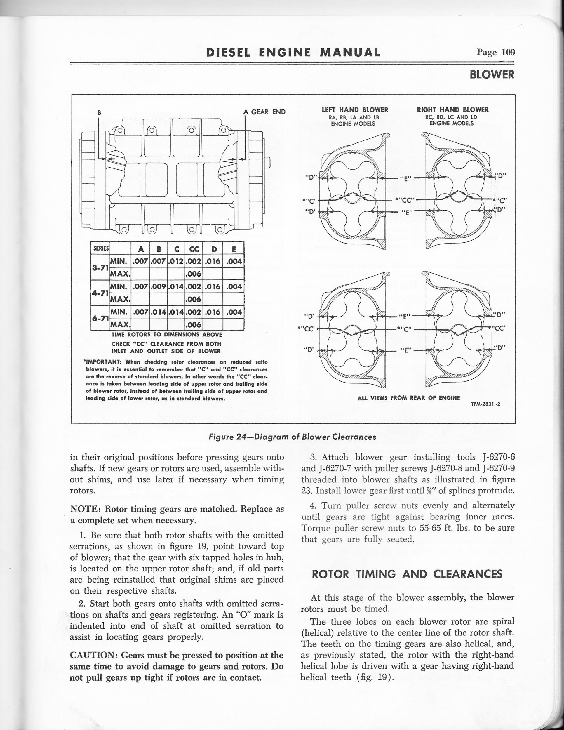

  2. Little Wing
    Joined: Nov 25, 2005
    Posts: 7,551
    Little Wing
    from Northeast
    Blowers mount on both left and right sides of the motor,,so yes there were 2 different rotations
    Though I think when most folks get blowers they need to have the rotation changed ?? ( could be wrong ) so if you have one already going teh same way,,you may be ahead of the game :D
    triple click on image it blows up huge :)

  3. 1. It is a core, not worth a lot, but still worth picking up.
    2. No matter what side it mounted on, it is still the wrong rotation for a gas motor.
    3. You can flip the rotors side to side to get the correct rotation. other work needs to be done as well.

    I believe there is a tech thread somewhere on here that covers the rebuild and conversion for a 6-71 blower for gas engines. Yes, you will most likely have to flip the internals, but pay close attention to how everything is put together including the stock rotor clearances and shims used.
    I've also seen one or two other places on the net complete with pics. I can't remember the sites. You'll have to do a search for them.

    it'll need to be gone through anyway
    but to answer your question
    rotate the blower drive input clockwise as viewed from the front
    the rotors need to turn towards the outside when viewed from the top

    Most buses had 6V71's, not the best for conversion. Most hot rod manifolds use the straight 6-71.
    Any GM blower can be reversed, just pull the guts out and put them in from the other end. The internal gears must be on the drive end.

    Like Paul says. Air goes in the top. Gets pumped around the outside of the housing intil it reaches the bottom and then out. As long as that is what is happening, good on you.
