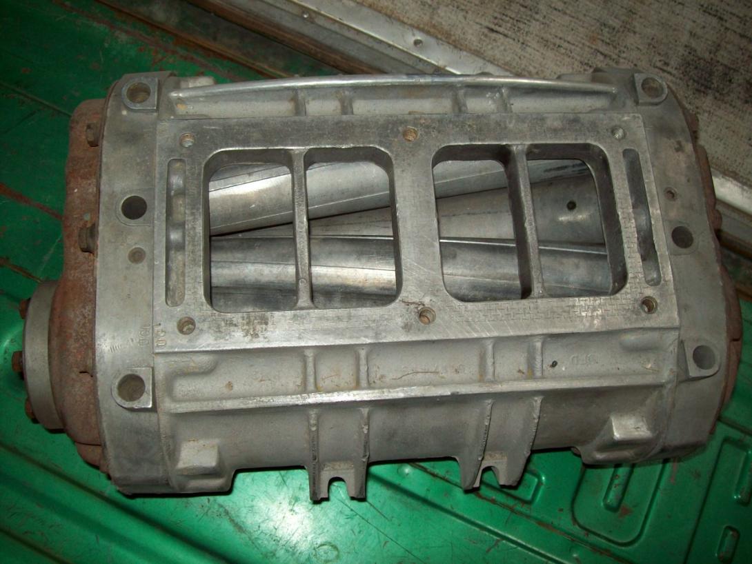

  9. spoole
    Joined: Mar 29, 2006
    Posts: 202
    spoole
    from mesa AZ
    Well, after the holidays were going to get started. I will keep everyone posted and if anyone has anything to add that would be great. If it works...I'll be the guy in the thirty one w/ no tread left to get home from Viva Las Vegas!!

    Hi guys I'm new to the HAMB and thought I would share my GMC 671 experience as it might somehow be useful to someone. About 2 months ago I read this thread trying to educate myself on the old 6-71's because I had run across one for cheap. The thread was a lot of help, so I decided to jump right in on the conversion.
    First I did the machining of the bottom of the case easily with a riciprocating saw and a grinder. It took about 2 hours but turned out really nice.
    Secondly I did have to swap sides with the rotors. I left the original shims and gears with each rotor, and upon re***embly ended up with a near perfect .007" drive side rotor clearance. And ended up with .006 rotor to front plate clearance. I'm not sure if this would work on every blower but it certainly did on mine.
    As mentioned above I bought a seal, bearing, and gasket kit off ebay from dale wilch. Think it was about $80. I also got my pulleys, idler parts, and so forth off ebay from various sellers.
    Finally about 3 weeks ago I got it installed and fired up. Blower sounded and was working great. At 4% underdrive it was making around 7psi. However, I had been making 7psi with a weiand 144, so of co**** I was dissapointed. So I swapped the pulleys and made 9psi at 5% overdrive. Still not satisfied I decided that my problem was lack of induction (single 750 cfm dp). Added another 750 (1500 cfm total) and made 14 psi. Now we're getting somewhere!!
    The second time I drove it in this configuration it sheared the woodruff key (yea just one) and broke the stock cast iron balancer. I found out the hard way that to make real power this area has to be addressed.

    I didn't see anyone talk about the old style 671 that have the 6 bolt pattern.Have any of you ever used one like that.This one came off a gmc bus and the mounting bolts are long, two on each side with one on each end of the case. Let me know if any of you guys have ever used any thing like this.
