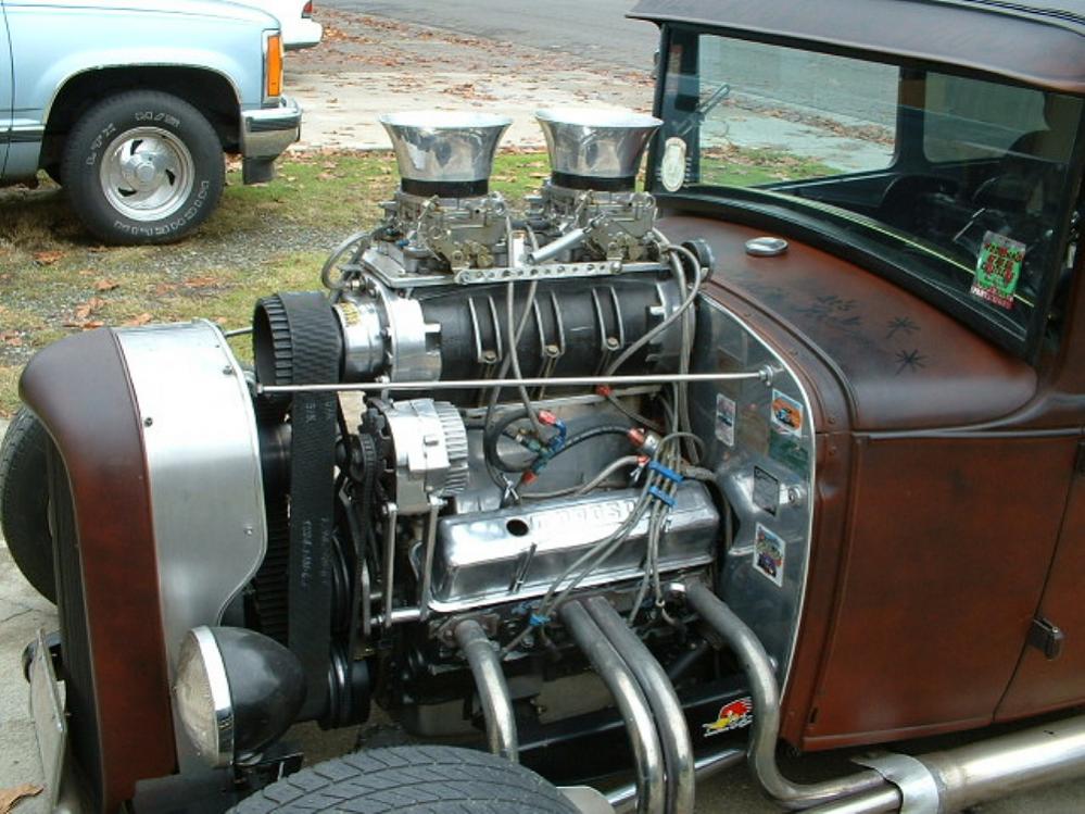

  9. budd
    Joined: Oct 31, 2006
    Posts: 3,478
    budd
    heres a pic i saved of a 6v-71
  10. Screamin' Metal
    Joined: Feb 1, 2009
    Posts: 506
    Screamin' Metal
    from Oklahoma
    OOOOH BUDD..........these things just make my heart quiver!!!!!!!!:p
