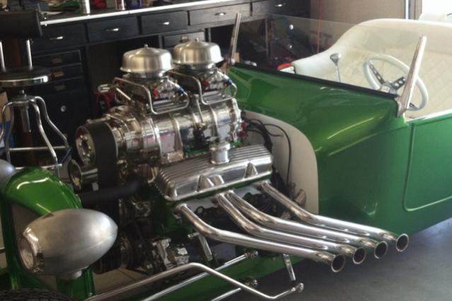

    I know its polished but going for a more 60's look then total SPEED!! Not period perfect but I like it...

  19. What's that run like with the ram horn exhaust? Does it not cause any flow problems since it looks like your running the blower underdriven? I like the look.

    Thanks man.....
    I really couldn't tell if there is flow problems. The first sideway pic is a video of the dyno time...yah it's a good 'street motor' dynoed with headers, but i really wanted manifolds. They are vette 2.5" dumps, and i got some time reworking the inside to clean out all the weird **** to make them flow better. With all the **** cleaned out, the ports are much bigger and gotta be about the same as any block hugger, so i'd ***ume i'm not losing much. Been on the road for a month or so. 1/4 throttle in 2nd or 3rd gear and it will blow the tires off....don't even ask about 1st as i gotta feather the pedal....500+ torque at 2400 rpm....
    We got our own blower expert on the hamb here...don't waste time or $ with the big companys...Gary will hook ya up. Yah, it's underdriven as we were pulling to much boost running it at 1:1 that a GM block will not take. About 10% under and still pulling big boost numbers
    Buddy donated the blower to the build, got used parts (pulleys, idler.....) and hamber to rebuild, low buck build with good power. Got lots of guys asking at shows if it's a GMC one...Love the old look with making good power
    guess that's why i'm starting another blower build already....BLOWERS RULE
  23. I really dig it man. I didn't think about porting and polishing the exhaust manifolds. Makes sense. You won't mind if I steal that idea when I build the blown 283 for my 55 Chevy, do you?

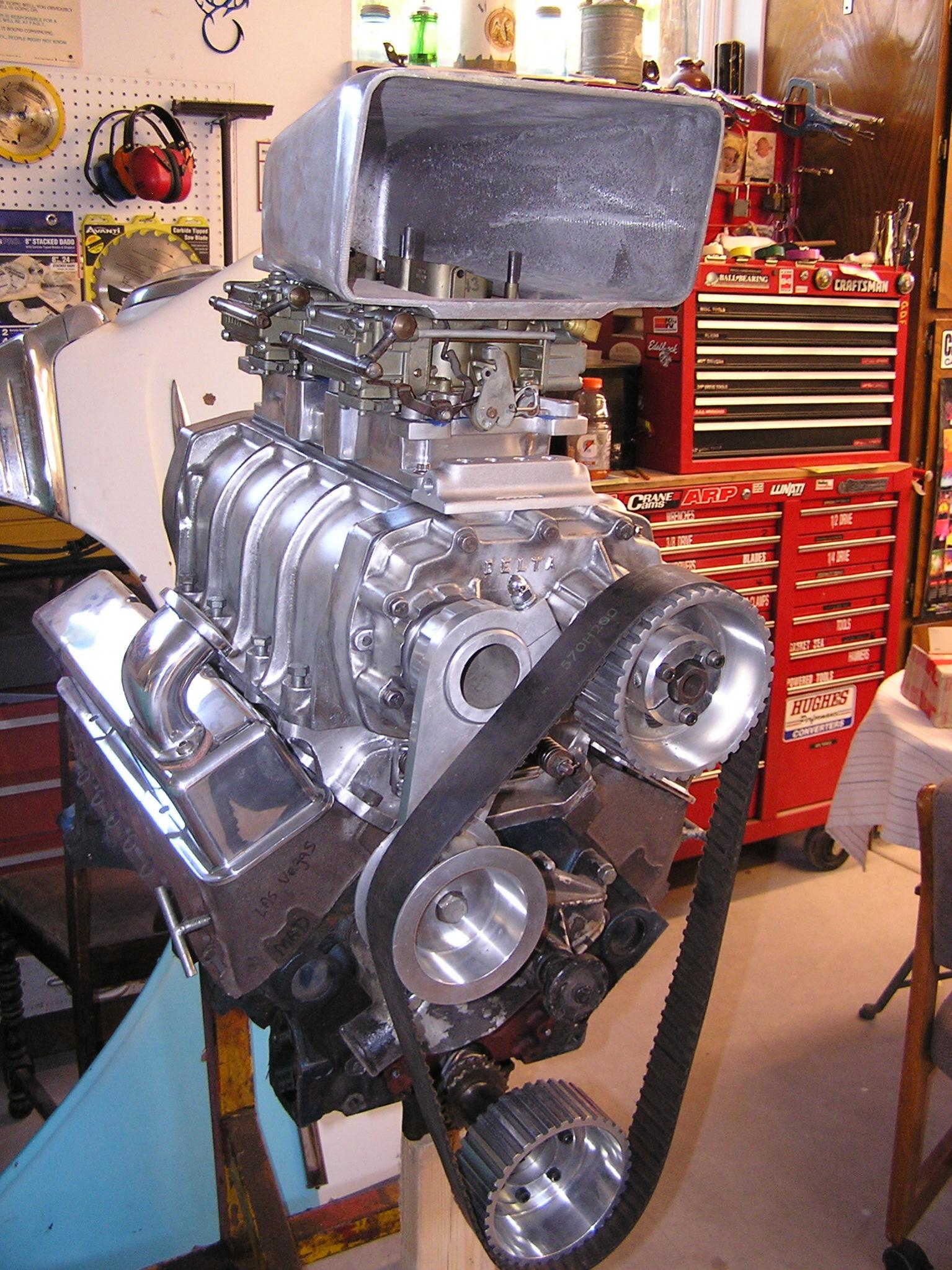

    I like the cast finish as well. Here is my pruned 4-71. The polished 4-71 was setup by the Leffler brothers (Cleveland) in the 1960's. I ***ume that was before heavy duty end plates were available as this unit uses early originals with steel rings pressed over the bearing bosses to keep them together. The rotors were pinned 3 places in each rotor. It has never been run since built in the 60's. The last is for parts but the case will get pruned this winter.

    Not aware they made a "4V71", but I'm very sure the inline 4-71 has 10 inch rotors, while the 6V71's have 12 inch rotors and inline 6-71's use 15 inch rotors....that's 3 inches shorter using my old school math. Do a little more research and check it out.
