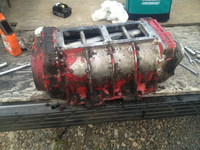

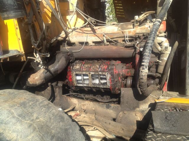

    Here's a quick and dirty shot of the 6-71 I pulled off a cement truck out in the bush 75 miles south of the arctic circle.It's destined for a fenderless Altered-style model A coupe with a stroked early Hemi and a HydroStick. ImageUploadedByH.A.M.B.1380505154.895356.jpg ImageUploadedByH.A.M.B.1380505179.750893.jpg
    I finally got it home tonight,and might get a chance to tear into it later this week.

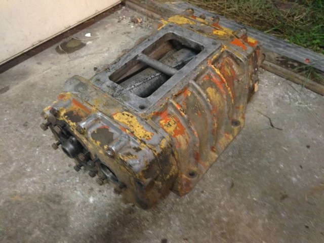

    Hahahaha that's just damn funny I like it anyways here is a 4-71 I picked up today it's good and greasy just like yours

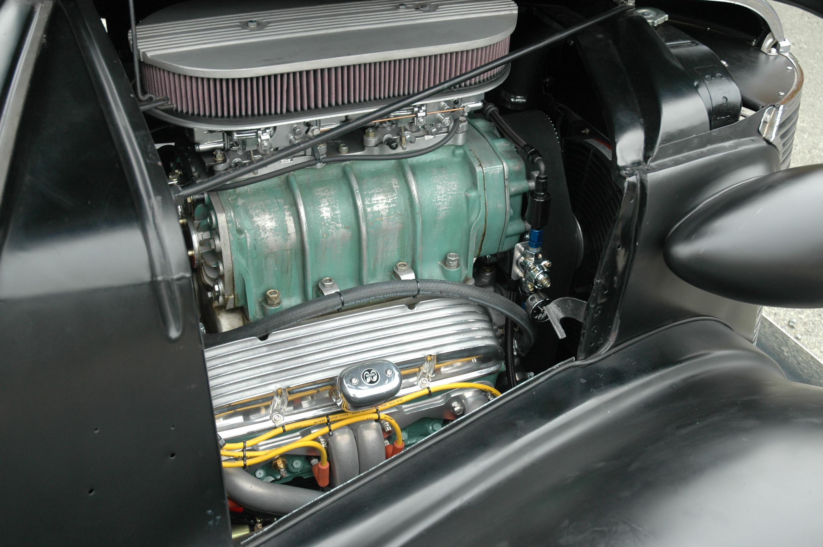

    DSC_0368.jpg In my 38 coupe. I didn't want to cut any holes for it. I had to fab new mounts and moved the rad forward 3/8"..... 600cfm's, it's 15% under driven, has 7:1 comp mated to a 700r4. I can cruise 75 at 2200 rpm. It worked out better than I expected.
