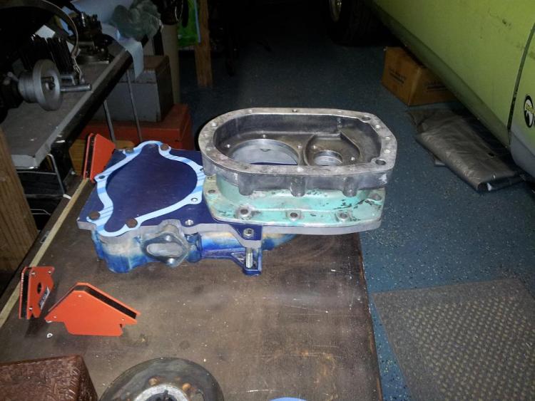

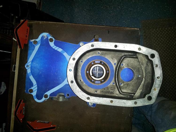

    You can buy an adapter plate to mount that to a 6-71 intake and any blower drive can be adapted the big issue is the front cover that has to be made

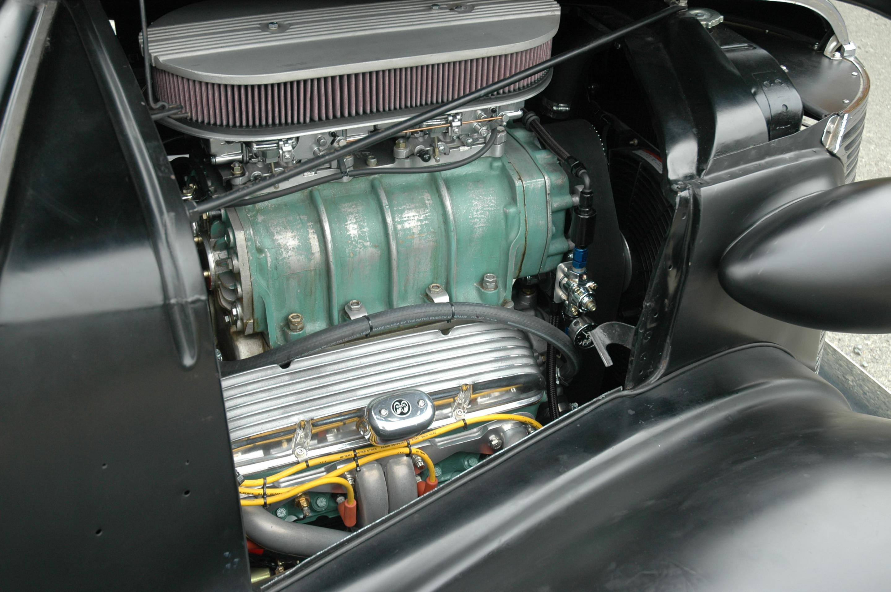

  5. Is your whole engine Alpine green? Looks real cool on the blower

    Yes. The blower still has most of the original Detroit Diesel green on it....It's the way I found it and wanted to keep the original patina on it. I painted the block and heads the same color.
  8. Created it, genuine Wieand 4-71 blower manifold, snout and pulleys all machined by hand. Took a bit to get the belt sitting in the right place when running. Have had this motor/set up together for about 15 years now (in two different rods) and man does it like to Boogie:D
