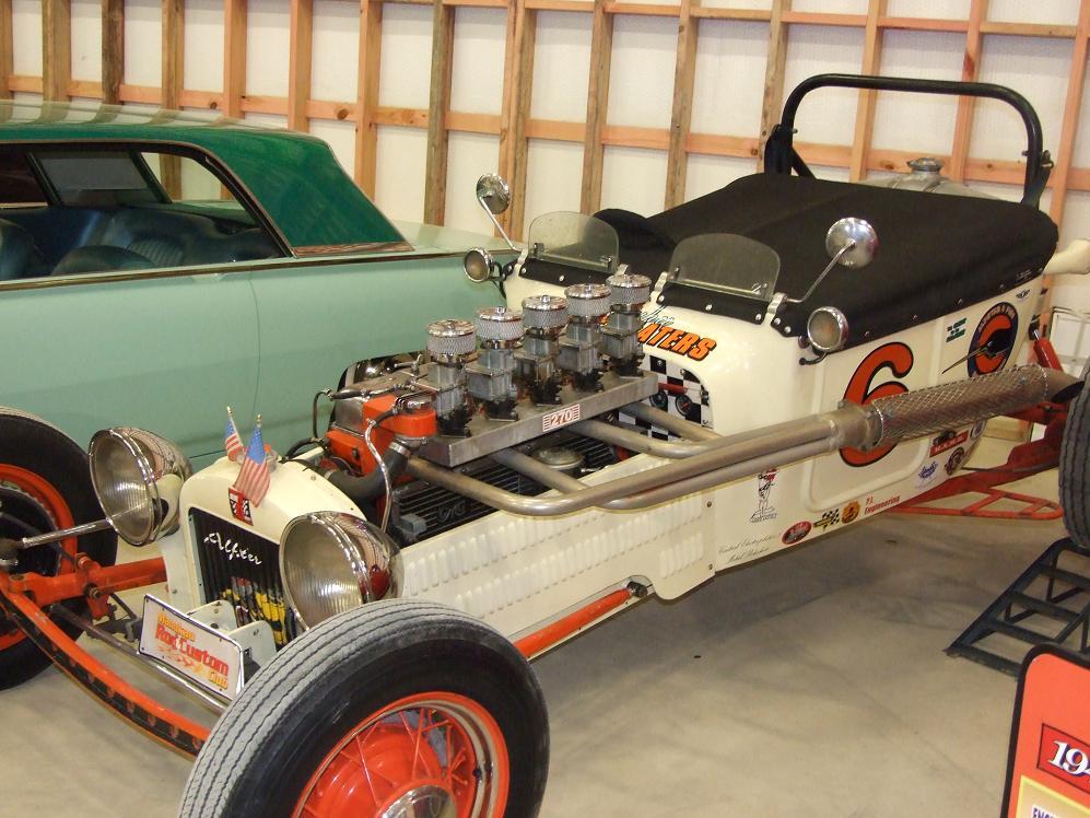

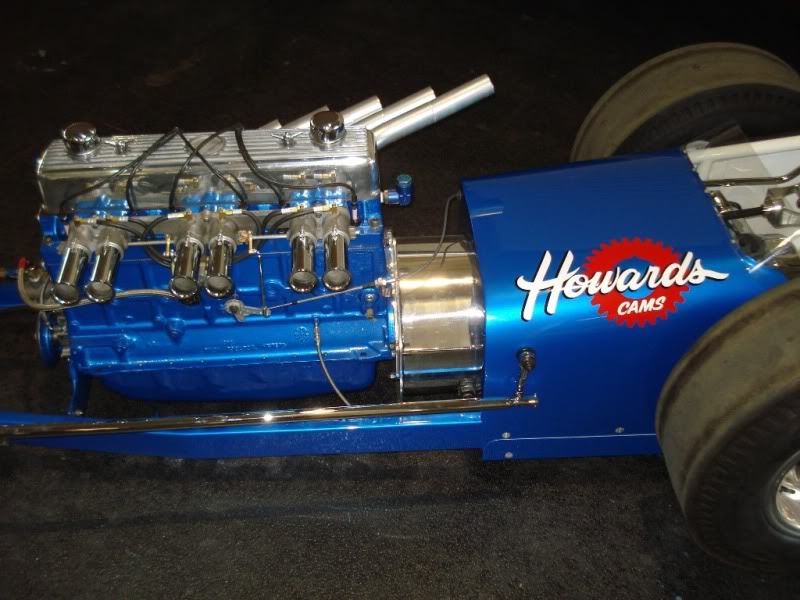

    Here is a Wayne 12 port on a 302 in 1964 and it was a 11.00 second car then. Wayne, and others had twelve ports out for Chevy's and GMC's since the 1950's. There is now a Skinner for a 292 Chevy too.
    Normbc9
  3. Normbc9
    Joined: Apr 20, 2011
    Posts: 1,121
    Normbc9
    The photo didn't go the first time. This is the Rollema and Teague car from the '60's.
    Normbc9
