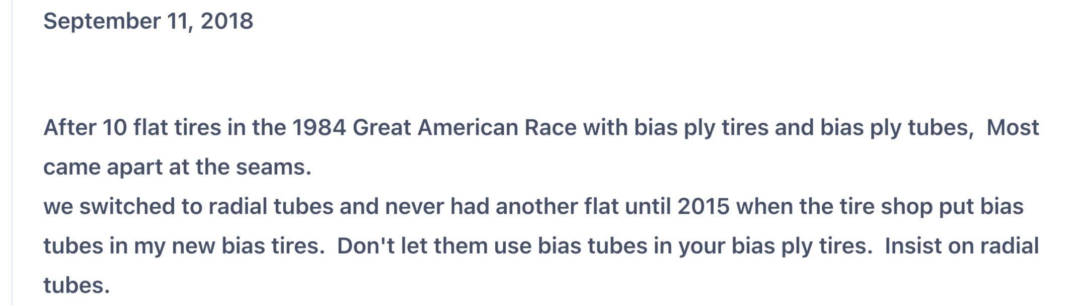

    Also, I’m reading that radial tubes are thicker/better than bias tubes…are way more reliable. Can run radial tubes in a bias ply tire but not a bias tube in a radial tire. Seems like a while back, I read about some of the available bias tubes are really thin/light duty.
    Any tire guys have an opinion?
    Interesting info below…I deleted the author’s name.
