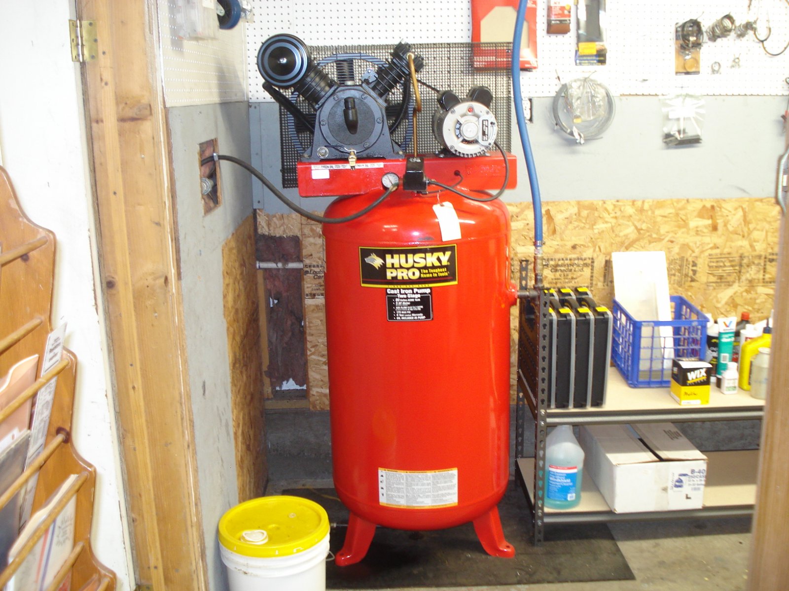

    3) build an enclosure and tank drain for your compressor to keep noise down and make servicing easy. Run air lines down the wall for easy hook up. Good time to build in a water trap.

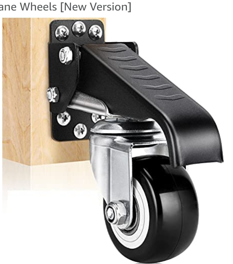

    6) put as much on wheels as possible. I'm converting my stuff to drop down casters slowly, let's it sit on its original base and the casters lift up enough to move it Screenshot_20220406-113135_Amazon Shopping.jpg

    I was considering the arrangement Indy posted but then I began to think they would present another hazard my old feet could trip over. Then I saw the quick release plates; you can remove the casters and the mount stays mounted flush to the legs. Kind of spendy though. But then again if you don't mind sending money to the CCP you can probably get them cheap at the cheap tool dealer. I paid around $55 I believe for the caster set and $20 each for the plates. Mine came from Home Depot, Powertec brand, Taiwan made.
    I also installed a ball valve to the drain port on the compressor and can kick it open and closed with my foot. Lazy, huh? DSC08357.JPG

    I do keep some flat skids with casters for moving / rearranging the shop for different projects. Agree, I don't like how the casters hang out. I'll have to check out the plate / caster set up.
    Things like grinder stands, I'm putting 2 wheels on the base and can tilt it and roll it like a bottle cart.
    I have ball valve on both compressors. Shop compressor has a tube routed out the wall. Home compressor, I use a 32 oz cup with a rag shoved in it.

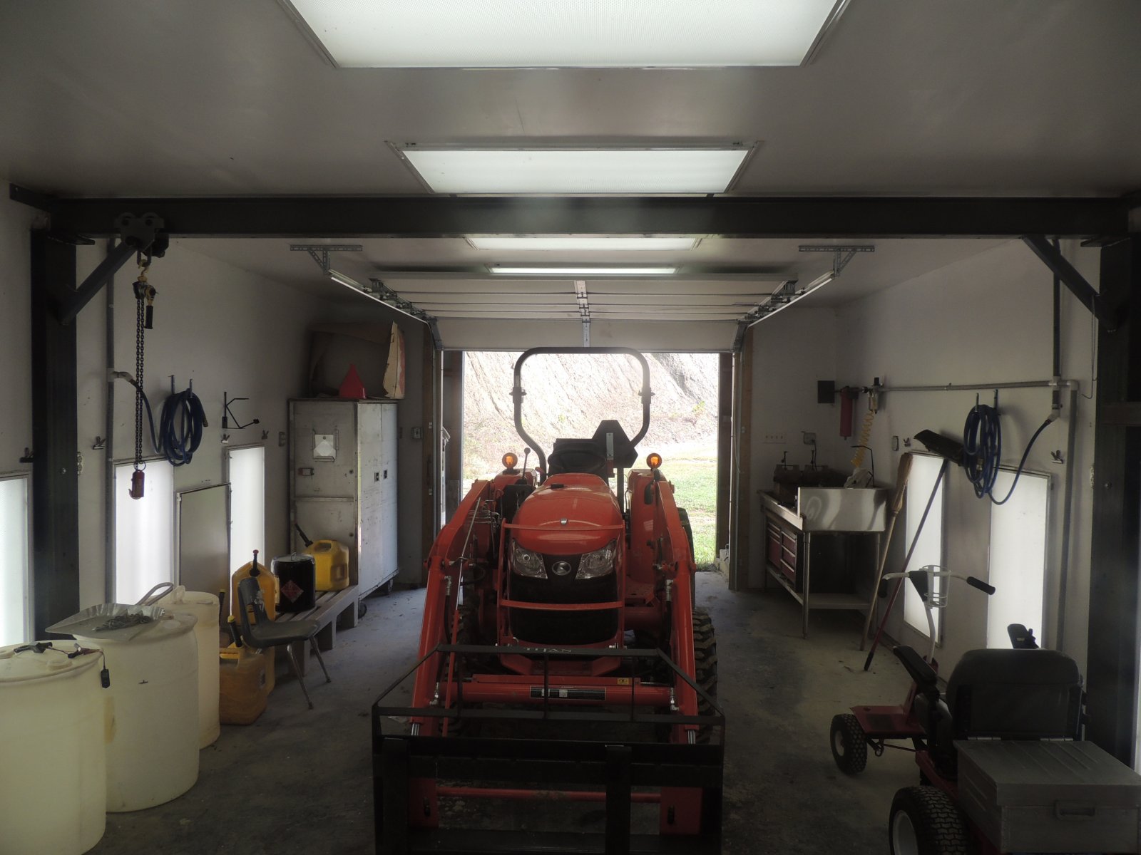

    I don't see a workbench anywhere or a cherry picker or floor jacks.

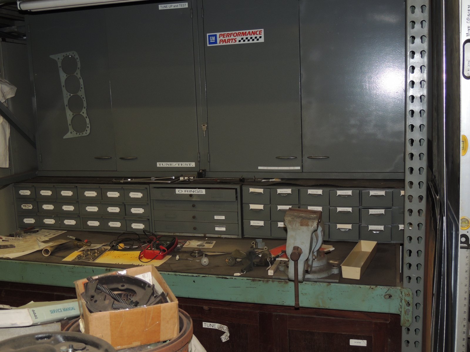

    My suggestions are to find some used pallet racking for a reasonable price. Tall ones can be cut off if the price is right. This allows you to use the higher shelves to store the things you ac***ulate.....
    A lower shelf can be filled with 2x6s and used as a workbench and a little welding will allow you to mount a vise on it.

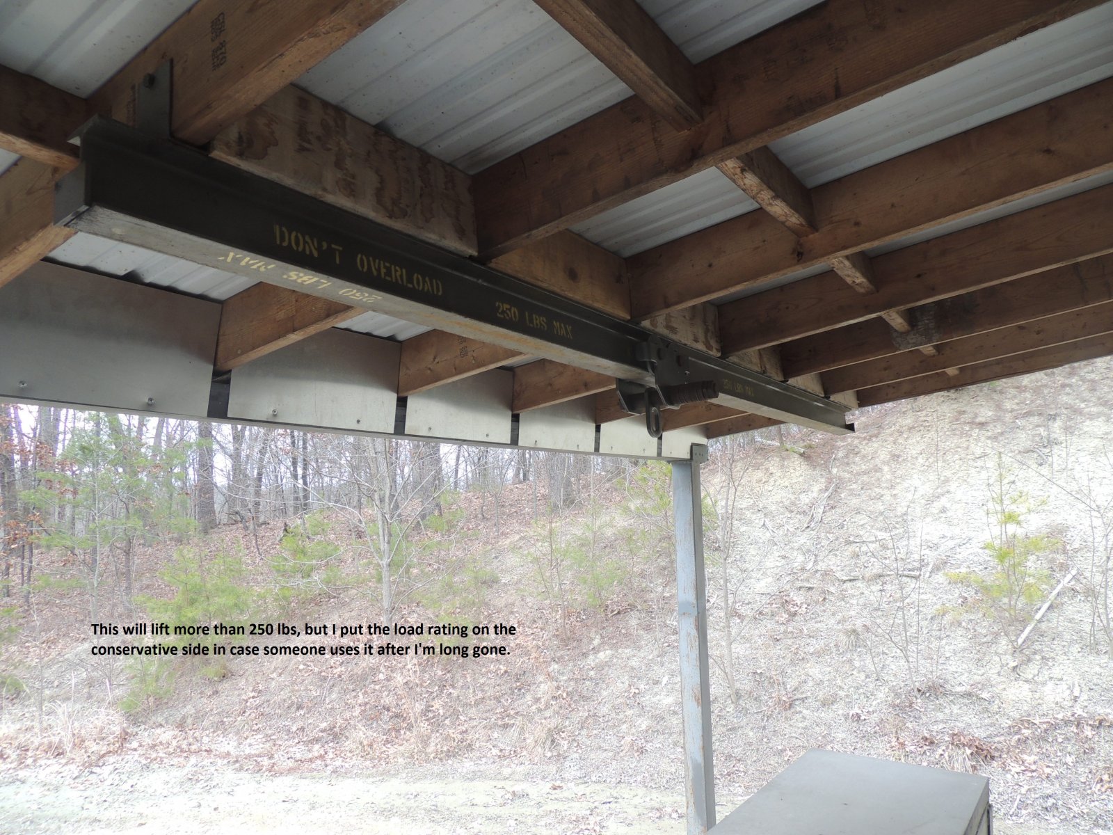

    Second I would buy a used I beam and run it across as an overhead crane. You lose no floor space other than at the walls where you have the support posts. You can use your lathe to make short pipe lengths that slide up and down on the poles and can support brackets for tools like bead rollers and engine stands. Again, it saves space rather than taking space.
    Lastly.......if the building is on your own property, I'd build a lean-to and then later add walls to it. Lots of space fairly cheaply. Once walled in, its a good place for things like lathes and mills and tools that are on wheels. Don't put anything thats top heavy on wheels.
    Small simple cranes properly placed and constructed replace cherry pickers pretty well

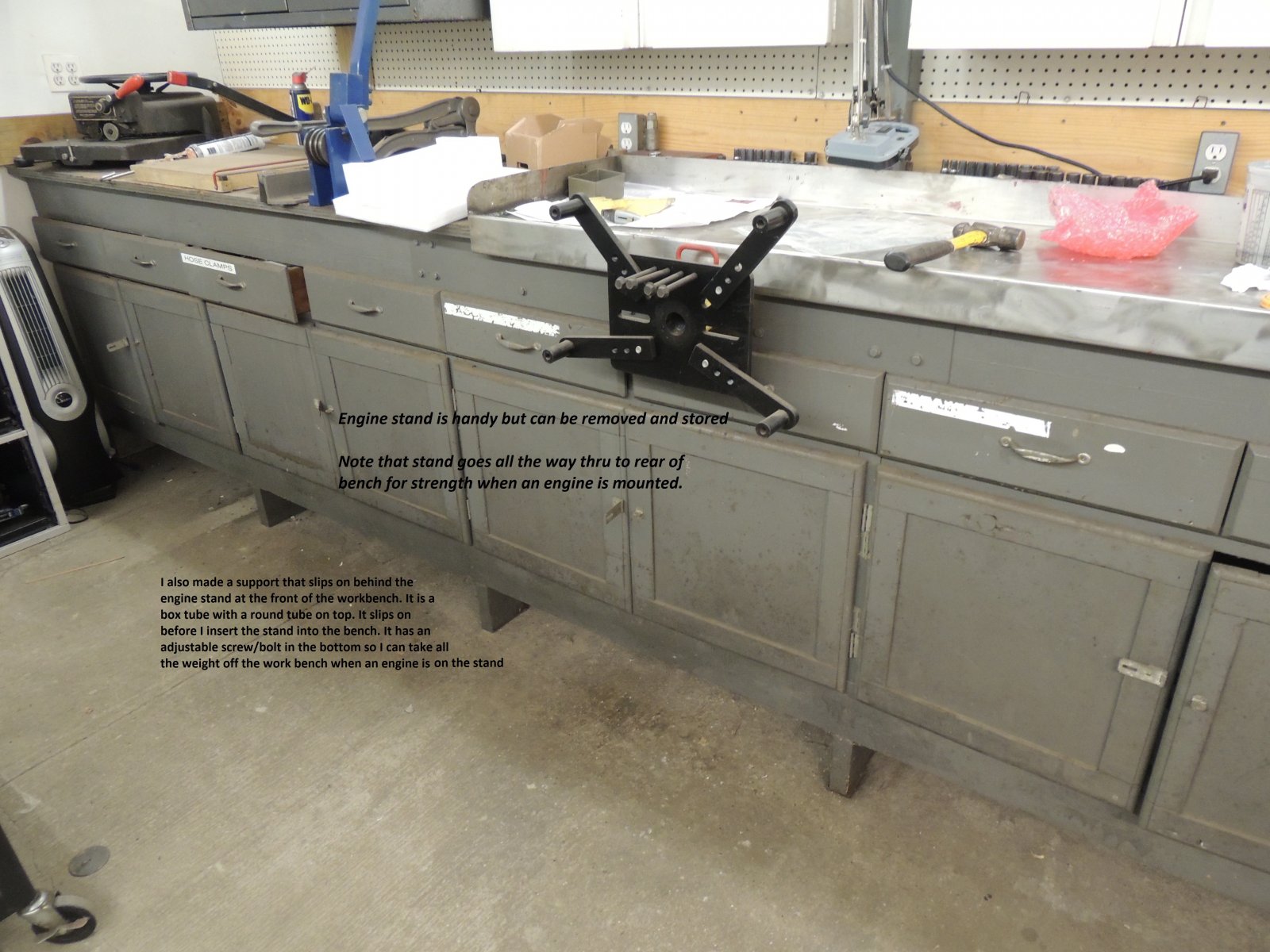

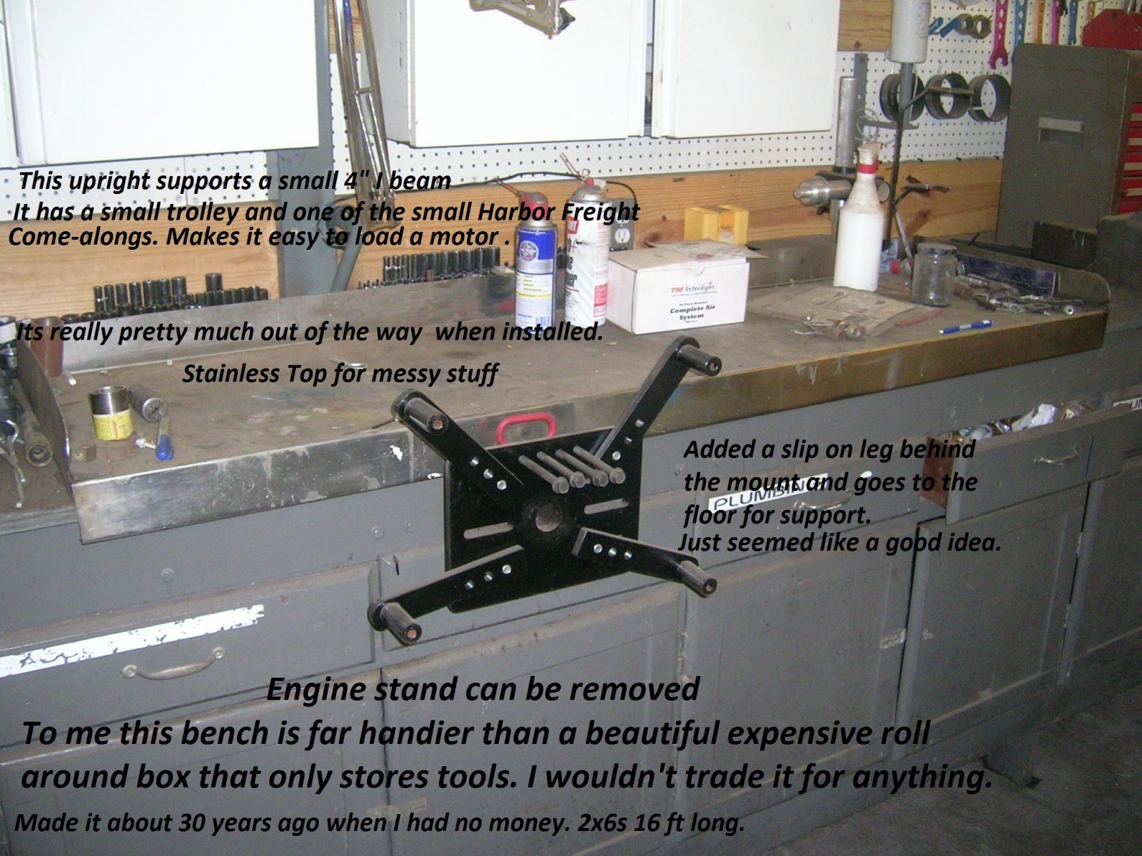

    Pallet Rack workbench with vise. Add other cabinets if you can find some on facebook.
    Engine stand will swivel sideways if the cabinet on the left wasn't in the way. Multiple sleeves can be put on round poles for holding other tools with a common mounting adapter of your design. Up higher, shop fans can be mounted that can swivel to point where you need them. Again saving floor space.
