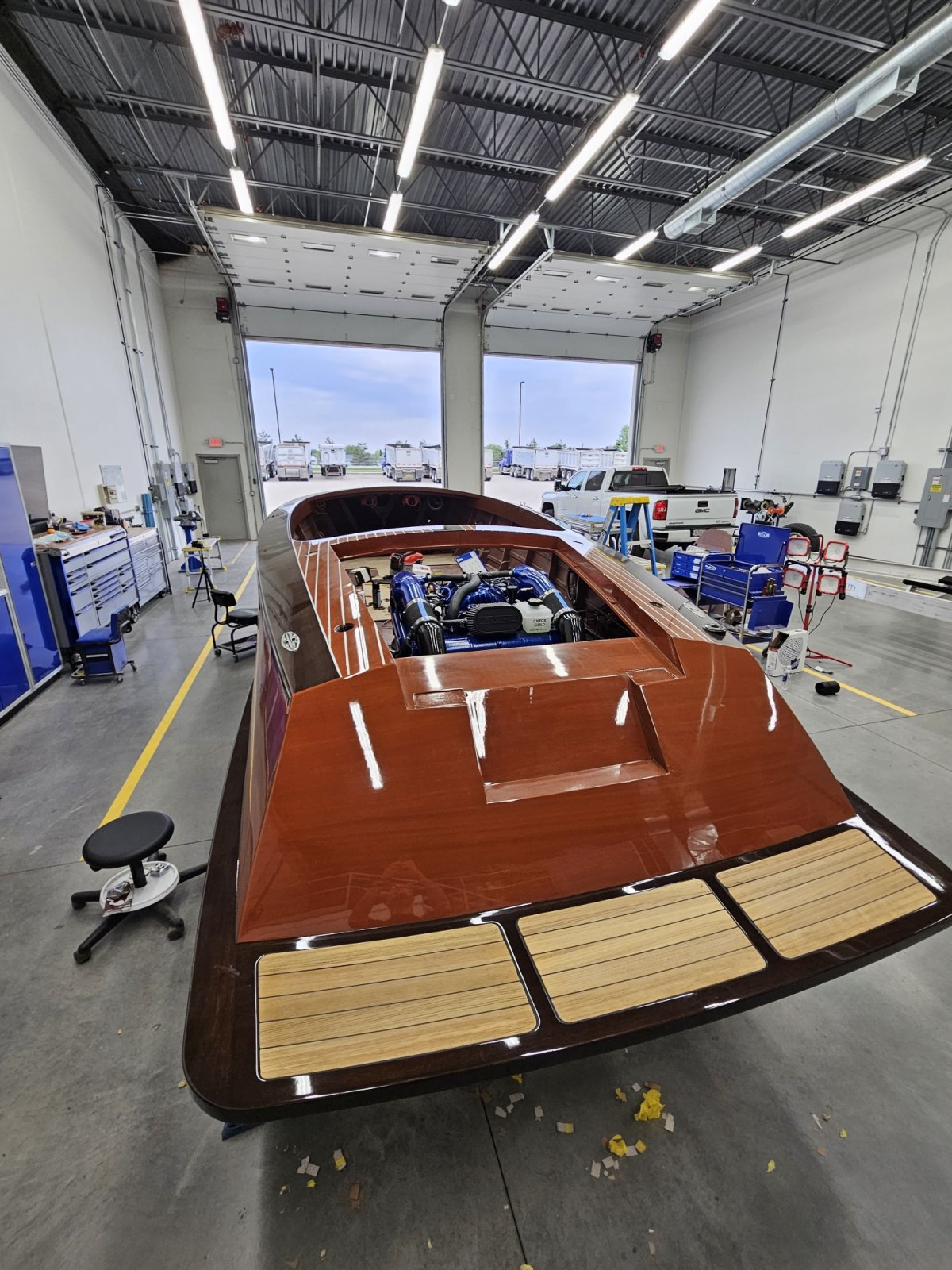

    Thanks for the replies. I have a center engine ski boat and a common problem is rotted stringers. the replacement cost of the stringer job is between $6k-$8k. What I was hoping to get from this post was a ball park of what people that don't do the work themselves are paying to have new bed wood installed. I am guessing it is around 20 hours of work? This is my first one and I may be a little slow compared to a seasoned professional, which is why I am second guessing my billing on this phase. Yes, I tend to give away free hours on stuff if I feel I am not as fast as I should be.

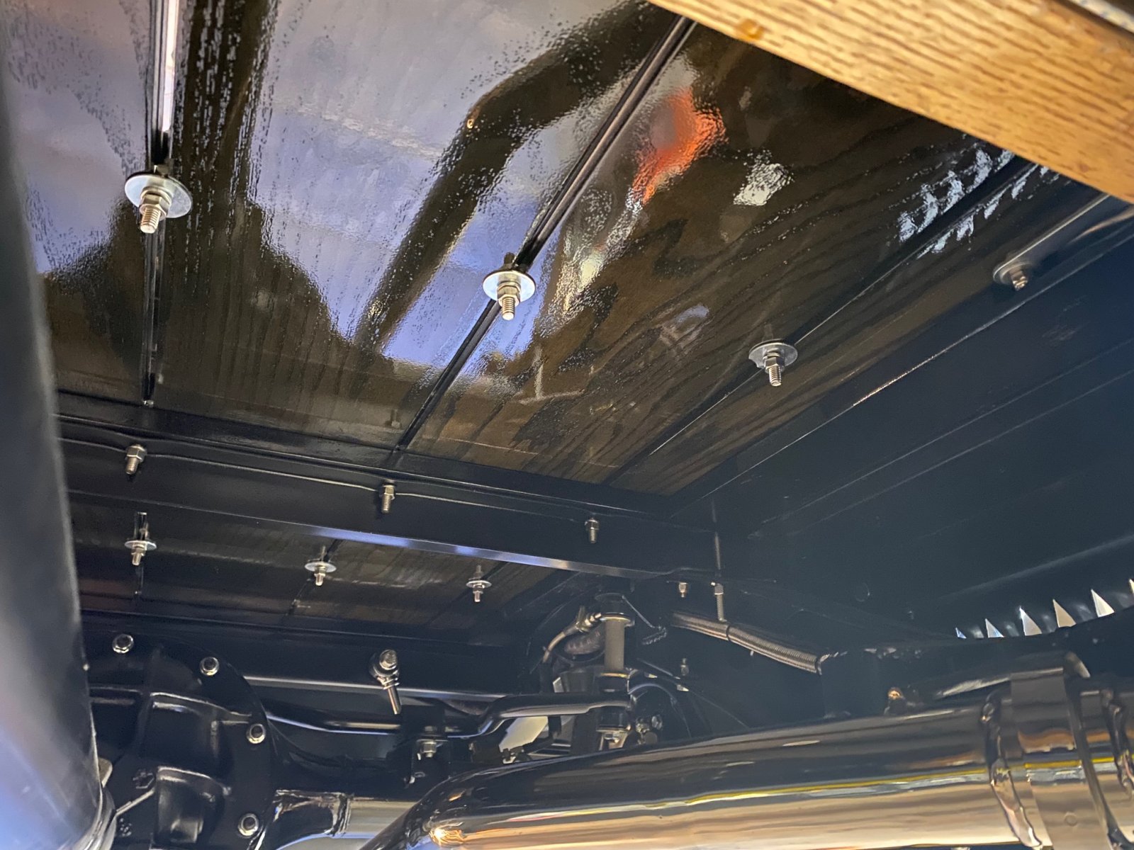

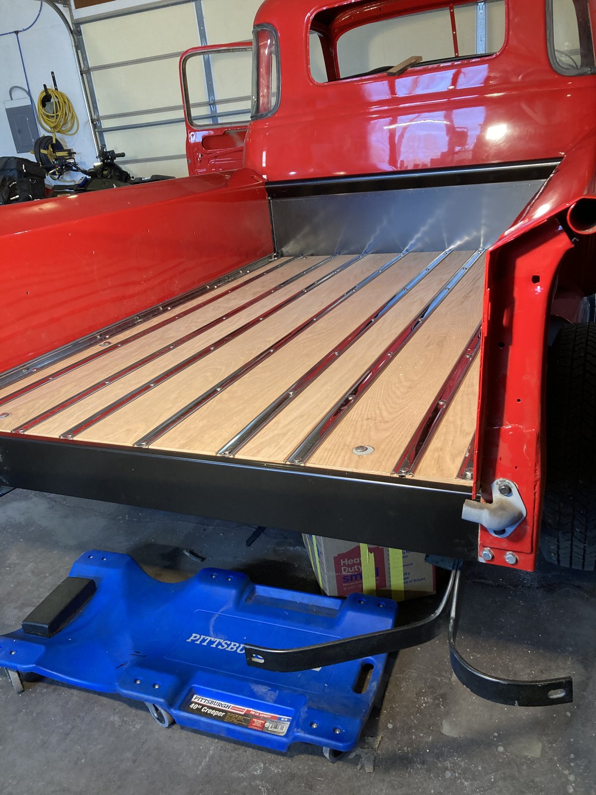

    IMG_0322.jpeg I installed one in my 50 .
    I used hand cut wood without the Babbitt.
    Used stainless screws in the channels instead of the provided hardware. Worked out great. 20 hrs seems like a good number.

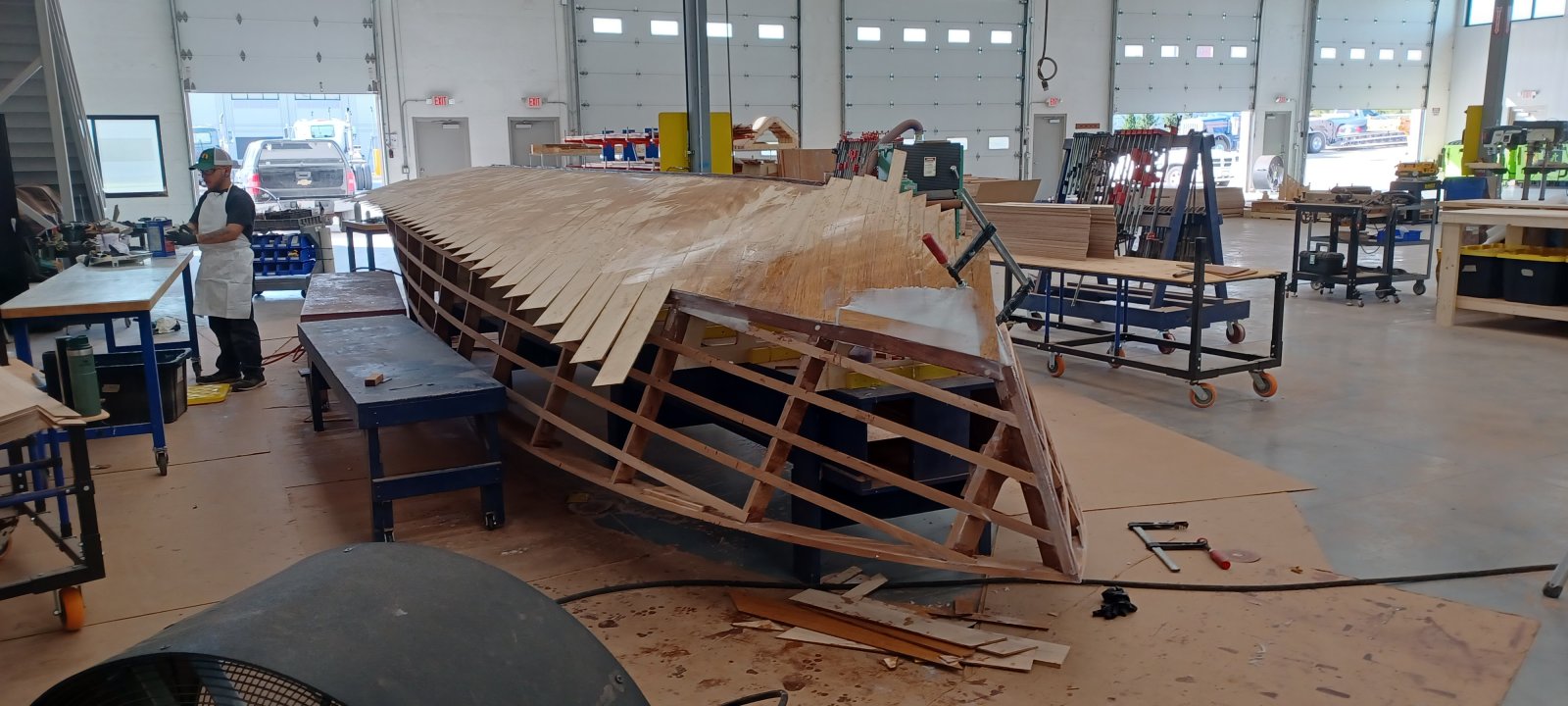

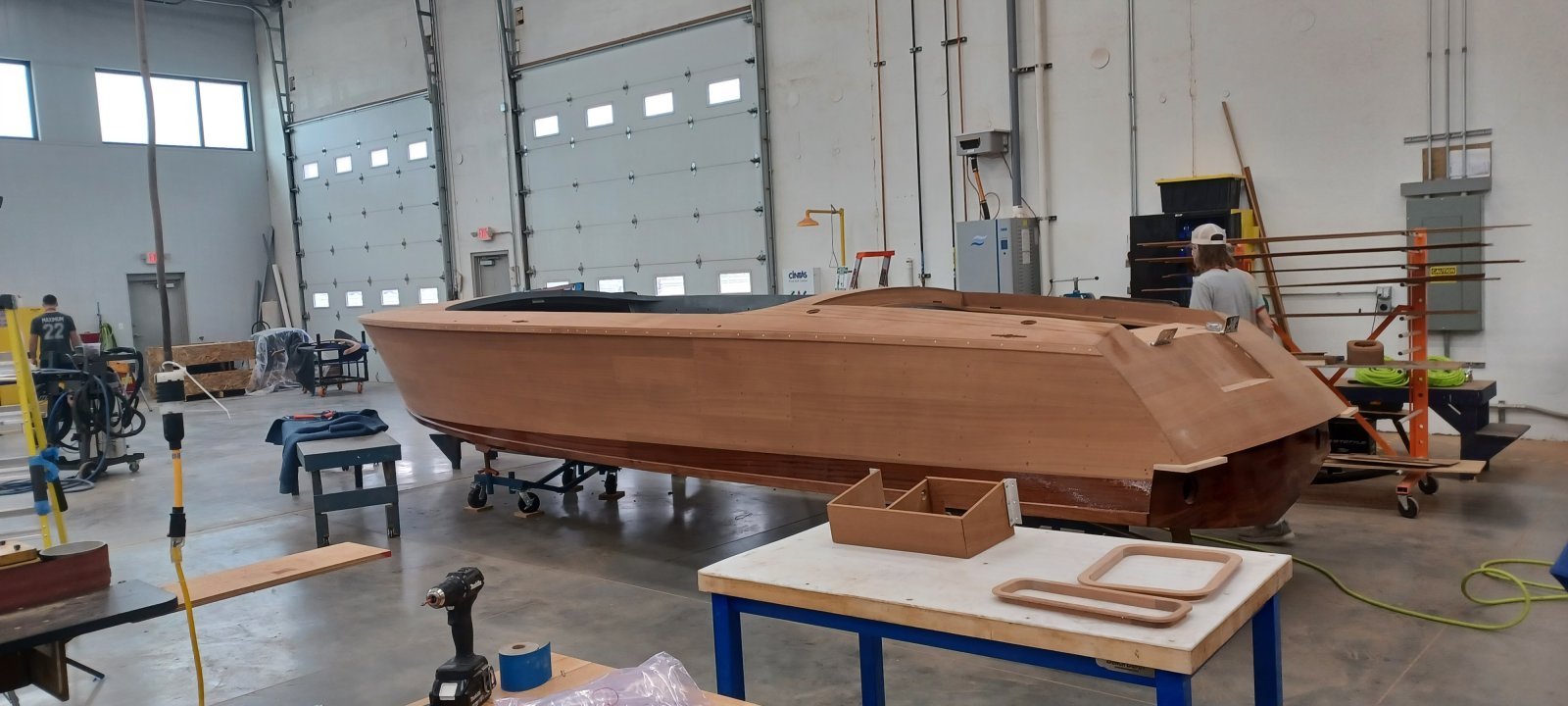

    As said fit and finish of the wood floor will be the variable. As a wood mahogany boat builder. We finish our wood depending on the placement and can it be seen A surface,B surface and so on . So on the A surface we sand up to 320 and then apply varnish. We then sand up to 5000 and then polish. I think a wood bed on a old truck is beautiful . I dig when they use figured or exotic woods .. So it depends if your going to use the bed to haul treasures or ? 4211365D-DD67-4381-B4A3-3B259888F975.jpeg 7BA28312-ED81-4018-B8AF-9D683F617AF9.jpeg C203BAEA-8A3D-4897-9EC5-7AA0A084D106.jpeg DDFBF1AE-1DFB-4AD8-B57F-142846512417.jpeg B91A77E2-69E4-4FBE-862E-D337A79C2330.jpeg

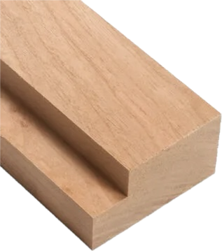

    Posts: 2,105
    X-cpe
    I think the word that auto correct changed to Babbitt was Rabbet, which is a groove cut into the edge of a piece of wood.

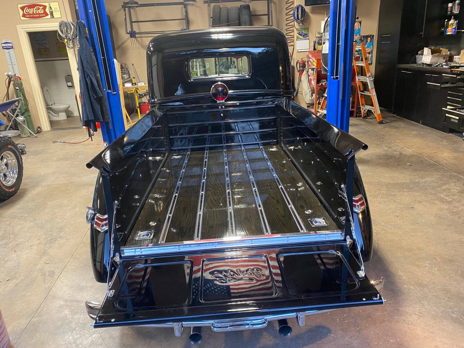

    Oh I see. Yep sorry meant Rabbet
