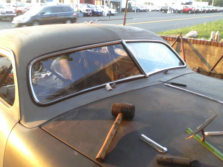

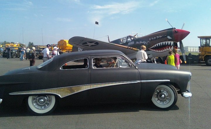

    there's a million ways to skin a cat, but for mine(the grey one) we just angled the a pillars worked out fine...took 5" out of the a pillars and 6" verticle in he back. extended the catwalk too. Make sure you get rear window placement right! If you're doing 3" and 4" i wouldn't widen the roof. My brother did his the same way as mine he took 3 1/2 out of his a pillars and it worked out good in his car. He has all his windows and stuff working
    Here's a few pics of mine, I am no pro, just doing my best. Still needs vent windows and a bunch of other stuff.

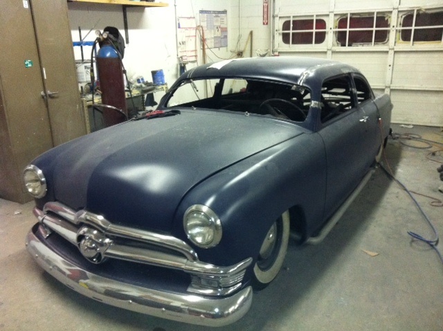

    Here you go. I'm kinda going backward I know. Already painted and done new interior. ;)

    Thanks for the pictures. The color and stance is very similar to how I want my shoebox to turn out.
