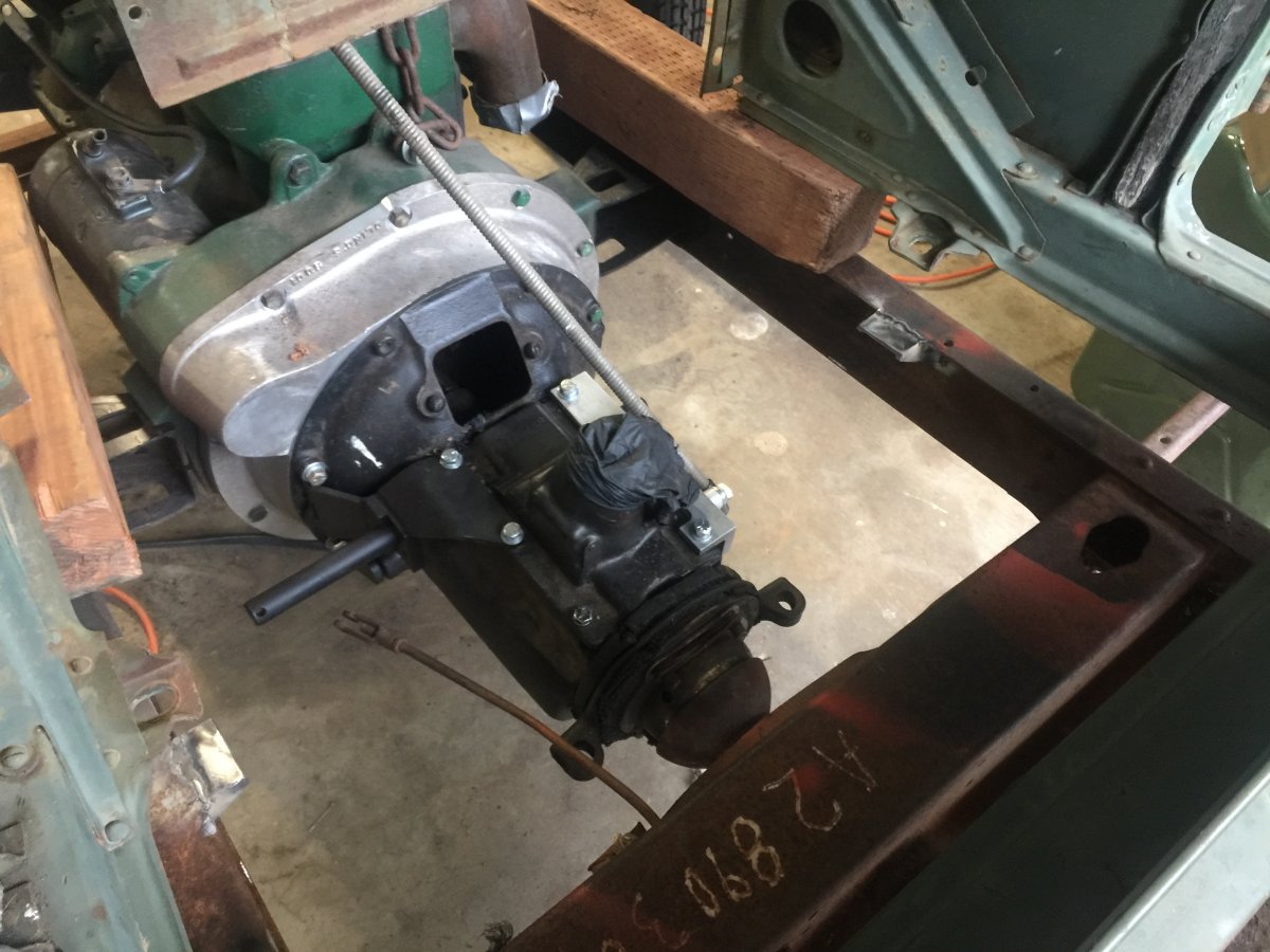

    408C6523-556C-4CA1-8037-848D406BC885.jpeg Thanks for all the info!!!!
    I bought a F1 steering set up and have an idea on how I am going to use it.

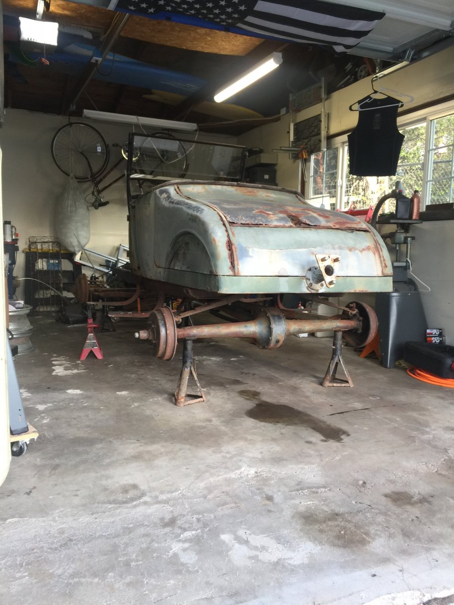

    9E848575-F96B-4A26-B0CF-FBAB5E3F5B10.jpeg CE0051E7-FBE6-49C2-88BD-F82A394B0B78.jpeg Did some work today! Got the body mocked up on the frame!!!
    I thought I had the plate to retain the front springs... I don’t. So if any of you have one let me know! I have the u-bolts and the top price but need the plate that retains the springs on the bottom.
    I also painted my rims and my transmission came today!

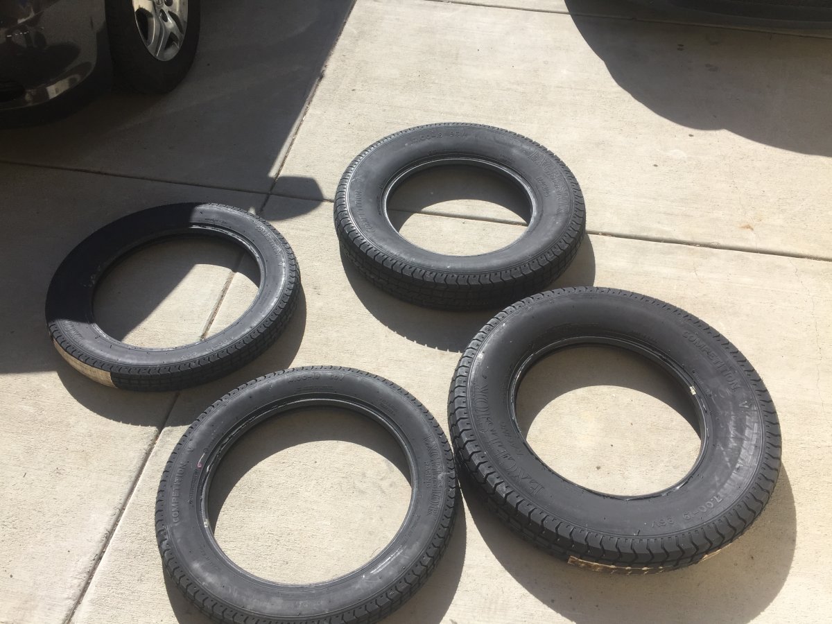

    886BB7DC-7026-4D78-AD30-A13493347A70.jpeg Tires showed up, they will be mounted tomorrow and I’ll have a roller!!!
    The rear tires are taller than I thought! I will definitely need to work the suspenion to get the right ride height.
    I still want to try and not Z the frame. I have a full T and A rear spring pack to work with to get the right height

    Please share the sizes of the tires you're using, looks like the Excelsior radials
  17. trcooperone
    Joined: Oct 17, 2009
    Posts: 158
    trcooperone
    from San Diego
    Thanks 5280A2, I am ok with the height and rake. Might mess with the rear pack a little but so far I like it.
    The tires are excelsior but they are bias ply
    Rears are 7.00-19 and the fronts are 4.00-19

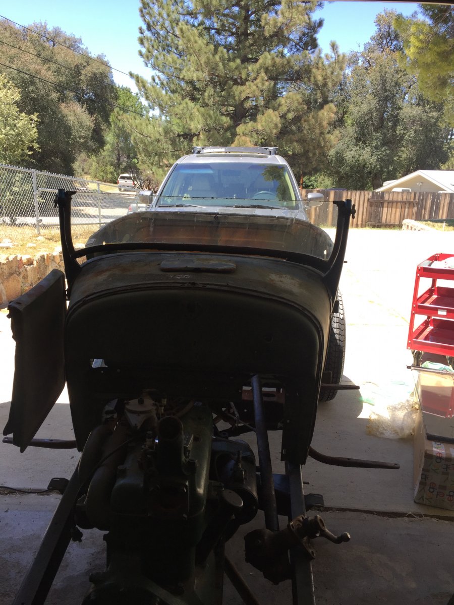

    550AA785-CAF7-4932-9271-31966FB82D5A.jpeg 6C89CACA-6362-4289-B9EA-8E98C78C2533.jpeg I have been slammed at work and home and have not had much time for the 27!! I am still collecting parts and my budget is getting very slim!!! I am doing my best to find parts and I have some parts for sale. So go help the couse and make me an offer on the stuff I have for sale here!!
    stuff I don't have listed is stock intake and exhaust and front leaf mounts
    I am looking for these parts as cheap as possible!!!

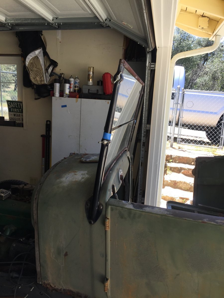

    C242F167-5358-44AA-8730-EFD872A78AFA.jpeg 6807805E-90B7-4D52-8B9B-E2D7387779EE.jpeg 36088014-F1CA-4E3F-9AA1-4D763E928326.jpeg 565E31EC-2305-4689-9C33-35A09F0CD429.jpeg Did a few things on the T but the beat was chopping the windshield!
    Instantly made it look cooler!
