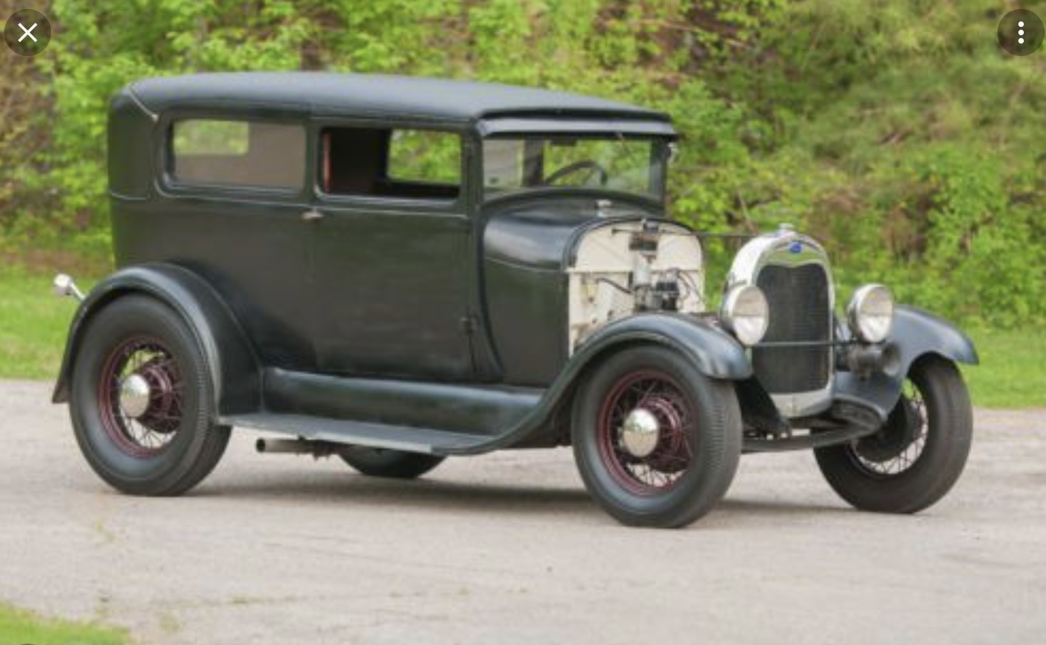

    Will be heading out for a 4 hr drive (one way) tomorrow to check out an all original (zero rust?) 28 Model A Tudor. What should I be looking at? All mechanicals have been redone so should be no issues there.
    Being 6’-6” I’m a bit worried about fit/comfort and there is no interior. If I get it, I would likely keep it essentially stock (no chop) and just ad my flathead V8. This would be kinda the look I would be aiming for.

    This will be my first attempt at purchasing a potential hot rod project. I have no idea about modding such a vehicle. So should be really interesting learning the do’s and don’ts if I do in fact buy it.
