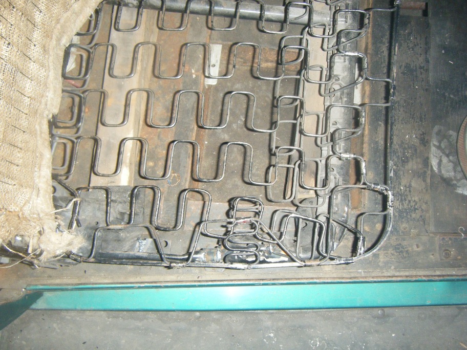

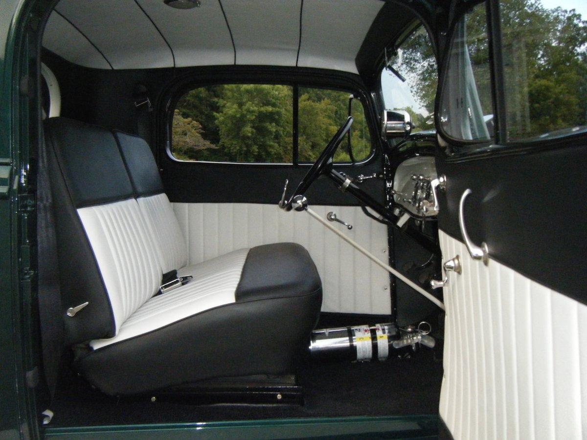

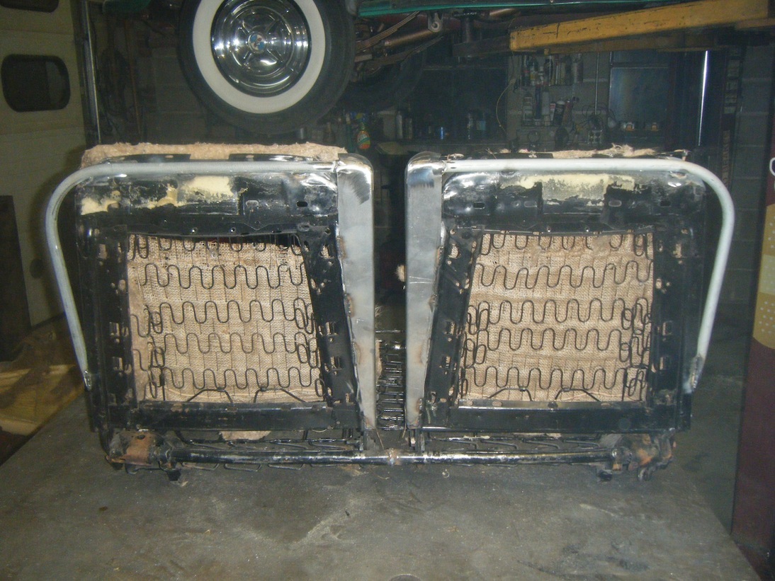

    mid sixties[?] bench seat that i cut down reshaped and had upholstered. first cut the center out, then added to the backs using emt and some sheet metal. then the bottom corners were brought in to match the shape of the door. new foam and some fabric . very comfortable. 1542721-1913eb457fae27738eb18de9d7983420.jpg 1542723-df5dbd5cda0f58e99c0b615270ac5e55.jpg 2014-02-16 18.12.03.jpg 2014-02-16 18.17.05.jpg 1562533-e0eeafa0901aa8d3e6ad174f2c44c5ea.jpg DSCF4407.JPG
