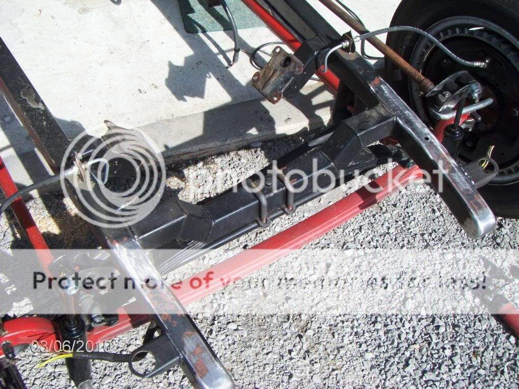

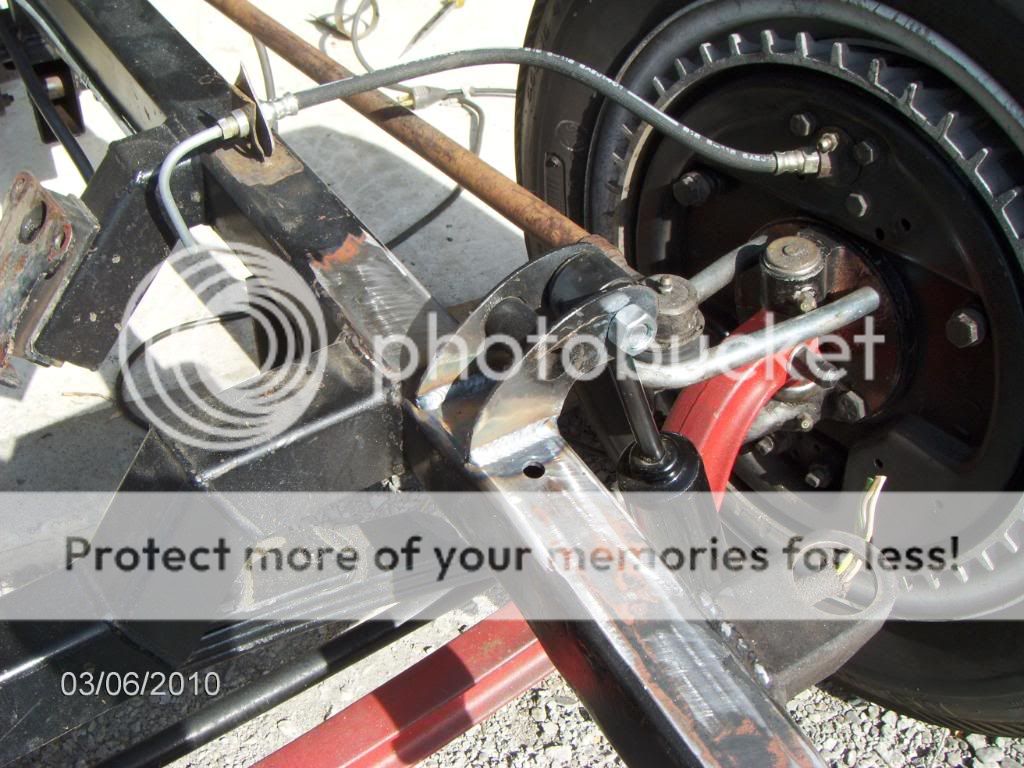

    Then I decided to tackle the frame horns, they have always looked funny to me, I had an idea once to put a door in the floor board where the frame tube meets it that i could open as a vent, but so much for that.
    All marked out
    and cut off and dressed up a little
    Then I took some s**** 2" exaust tubing and filled in the blank, welded it up and dressed it out with rolocks.
    I think that looks beter!

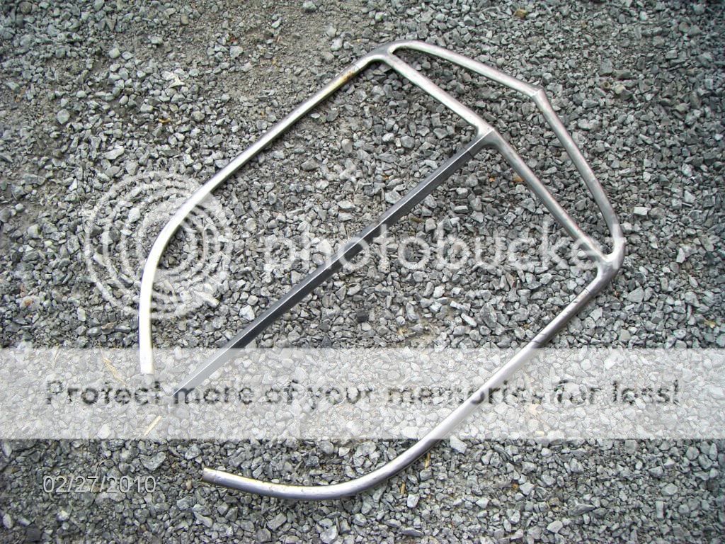

    Next was a little augmentation of the grill
    After years of being ridden hard she was showing her age
    And had scars from previous botched surgerys
    a little excess baggage in her rear(that heppens with age)
    we stared by ****ing out the offending tissue and marking her for the augmentation
    Then with an insision under the left breast
    We are then able to utilize a graff from the neather reagon to replace the aging skin.
    and the a nurse finished the suetures
    Then the incisions were dresses and the patient was sent to the Icu(blasters) for recovery, All in al it went great and she will enjoy her new fuller more youthfull apearance:D
