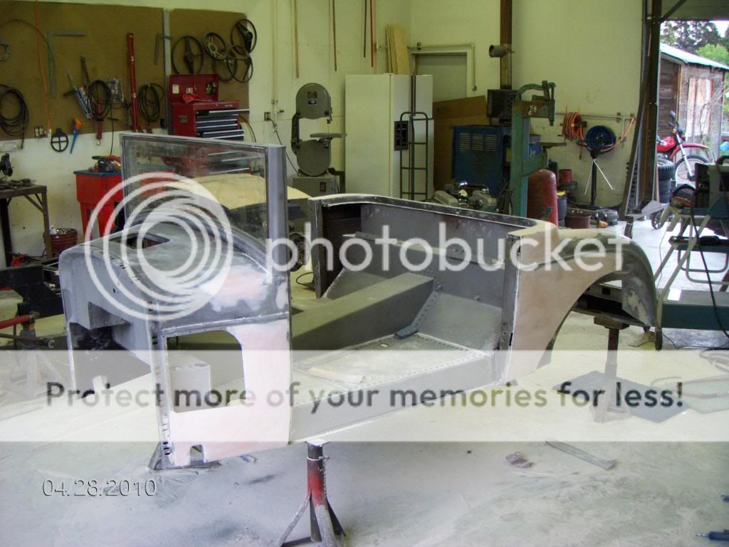

    Here we go again I decided to tackle the roadster doors, I made up some hinges using 1/4" X 2" bars stock and turned out the ends from some 3/4" hot roll, I've just got 1/4" bolts in them for now until I find some 5/16 hardend shaft to finish them with. they still need some finish work I'm thinking about polishing them and triing my hand at electoplating them with nickle.... whe will see.
    I didn't take pictures when I built the first door because I didn't know if my plan would work, but I think I cand get there frome here so I do***ented the second door.
    I didn't get it to fit the jambs very well and had to pie cut the skin at both end to fix it,(I thought I had measured prety carefully but I think it was lost when the skin was streached?...

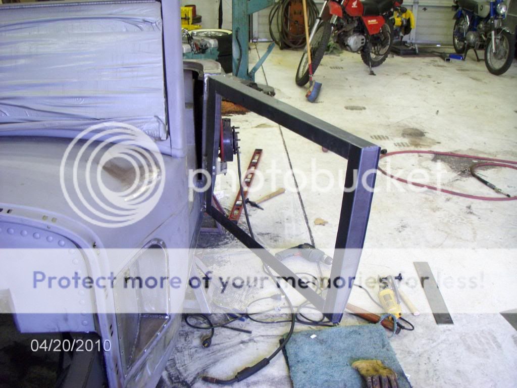

    starting the drivers door, I mounted the hinges and bent the frame out of 16ga
    just used a 4' level to make sure the hinges were verticle to make the door swing flat

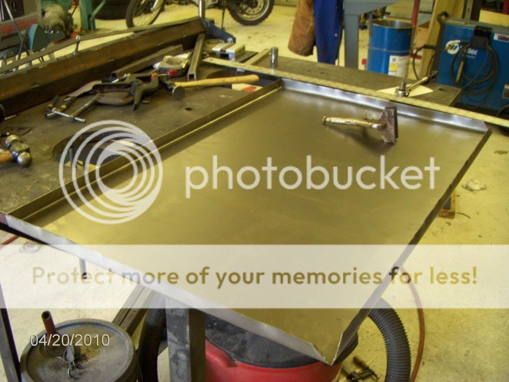

    measured and cut the skin, then folded up the edges
    the top remains square buth the sides and bottom get folded completely
    I don't have my english wheel working yet, and I want to get this going for a local show next month so I had seen a tech article in cl***ic truck's pofessor hammer section that used a drawn on grid where you would strike each intersection of lined with a hammer to form a compound curve, so I gave it a wirl, I won't say its as good as wheeling it but it does work.
    fitted to the door I alsoused the shrinker on the top flange to give it the proper curve.
    The door gaps are ****py just like the outher side was, rather than pie cut I think I will try to use this panel as a template to make the adjustments on a new sheet to see if I can get it closer, I think I can start it over faster that doing all the welds for the pie cuts.
