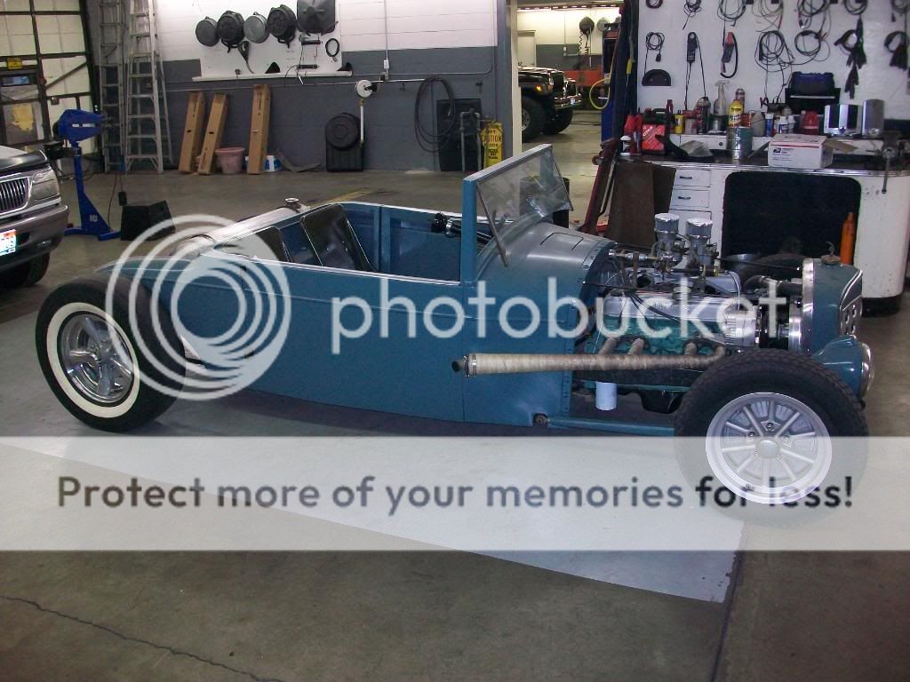

    I havent really done much fabrication to the car since the last update, I had solved the fan shroud problem by spreading the frame horns slightly(kind of a barbaric method) then slapped everything back together to go to a local car show at a used car lot in august, and then shoved the car in the corner while working on some other projects.
    So here is some updated pictures before I get back to work on it!
    when driving the car if the rf tire needed to drive over something you could see it move independantly of the left tire I have always suspected that the heated and lowered stock steering arms were to blame so I'm going to start there.
    I have the car down at work right now and have ordered some forged Magnum dropped steering arms.
    Also the interior is ready for some sprucing up, The plan is to ditch the $8.95 army surplus seats for some custom built in bomber style aluminum seat backs and real padded cushions(now that will be up town). as well as aluminum door panels and kick panels(should be a nice place to get a tan:D
    It will be a little slow for a while as I'm finishing a remodel project in the house but we will get there:p

    I have a rebuilt 4bbl that i keep threatening to put on it just to see what it could do, but even with the two 94's and 2.50 posi it is scary fast and can get out of hand pretty easy. I always described driving it as an overpowered go cart.
    The deck lid is gonna be cool. I'm in the finishing stages of building a large louver press that will punch the old style louvers, once that is done I'll build an bare aluminum trunk lid filled with louvers that will hinge just behind the fuel tank.
    Thanks all for the comments, makes great motivation to get through the rest of the build
    Robert

    Yea I hear you on the front tires, those are some freebees from a Vee-dub I like the size but not so much the tires. For looks I'd like to have bias ply's, but i have had two different sets on it and I'm tired of the white knuckle handling at anything over 70MPH, I'm kind of leaning towards some mickey thompson sportsman tires, or something along those lines, but I'm open to ideas and pictures.
