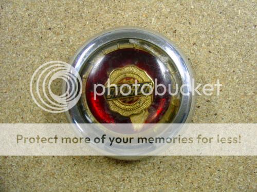

    Very small triumph, I had found a chrysler horn on e-pay, and found it was near the right diameter, the picture looked good so I sprung for it
    The photo looked a lot beter than it was, most of the color was just barely hanging on and would fall off if touched, so I media blasted the color off and brushed back in silver,black and body color. I had to cut off a couple of tabs and it just snapped into place!! looks right at home in the 56 chevy pickup wheel I think.

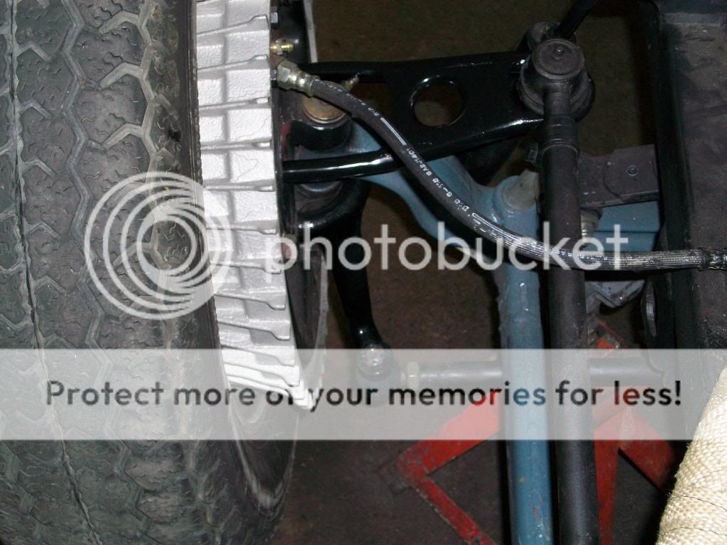

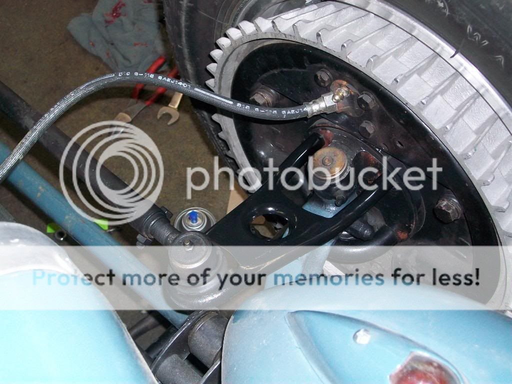

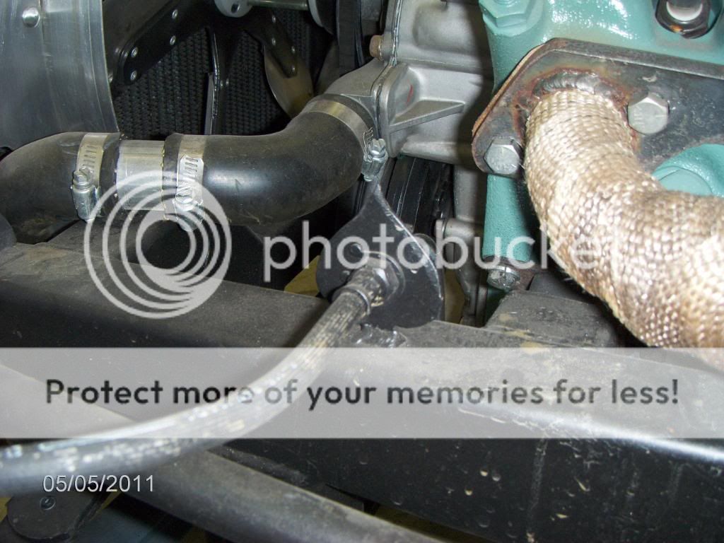

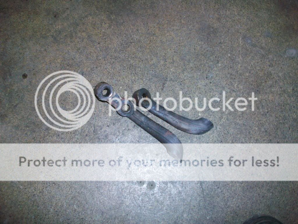

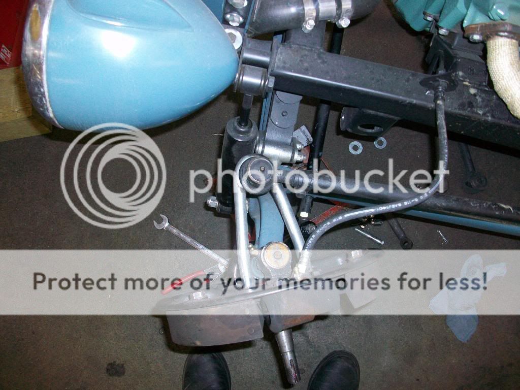

    small update, I got the steering arms cut off and replaced with the magnum arms, they seem pretty beafy, I don't think they will flex.
    Also the steering was a little fast so I built a new upper steering arm that was 1.5" longer, This made it go from a little ofer a turn lock to lock to almost 3 turns lock to lock and eliviated the tire rubbing on the drag link.
    I threw the car on the alignment rack but now the tie rod is too long, I could just cut it off and re tap, but it is one of the speedway specials that I've heard nothing but good things about on here:D, So I called up the folks at Welder Series and ordered one of their 7/8" seamless tubing units, cheap at 50 bucks if it stiffens it up.

    "Not to beat a dead horse, But I needed a shorter tie rod after changing my steering arms, I had a speedway one on before and after reading this thread I figured I would order a welder series rod rather than shorten and rethread the speedway rod.
    Despite the welder series rod being 1.5" shorter it weighed about a pound and a half more than the speedway rod, and the i.d. was substantialy smaller. The speedway one looked to be DOM tubing as was the welder series rod.
    Now the question is will this be enough of an advantage to offset the extra 1.5 lbs of un sprung weight? But I guess when you run straight axles you have to have the additude of "whats unsprung weight?"

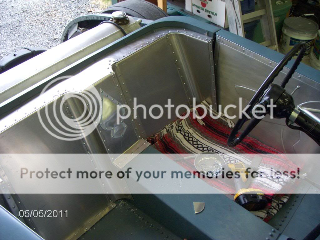

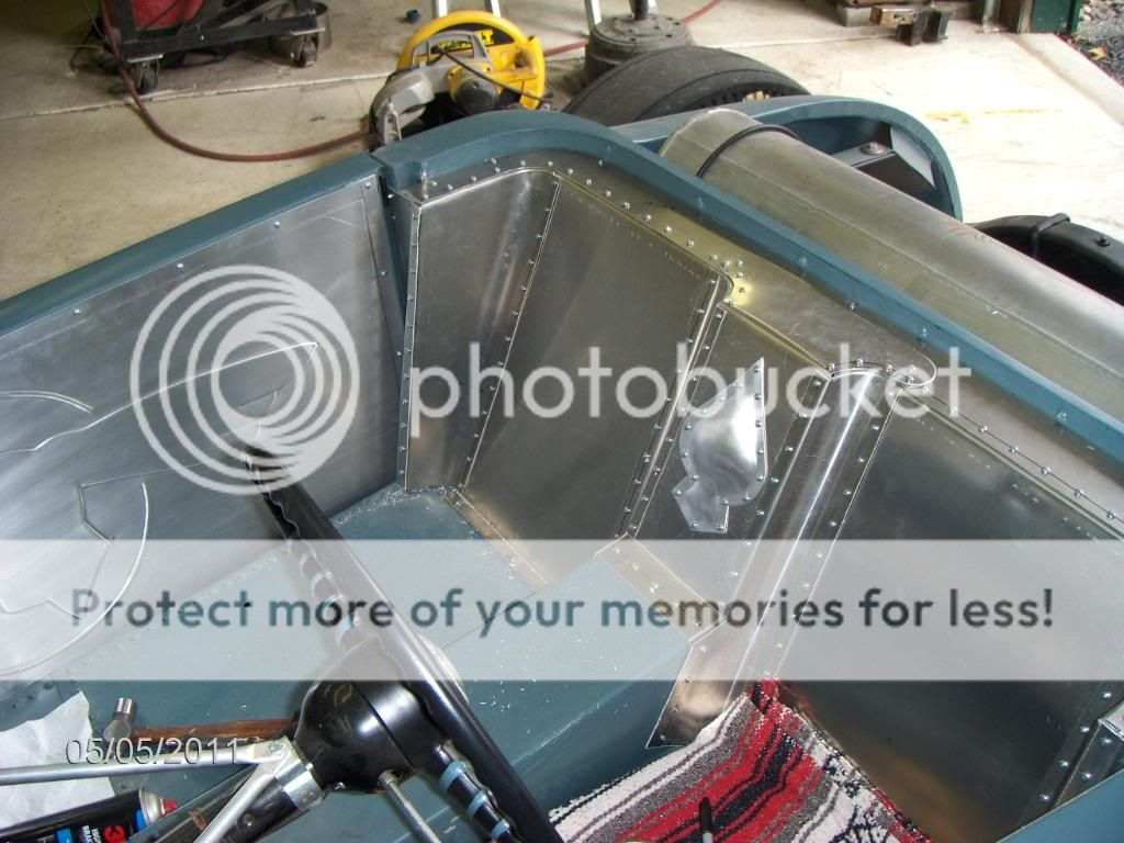

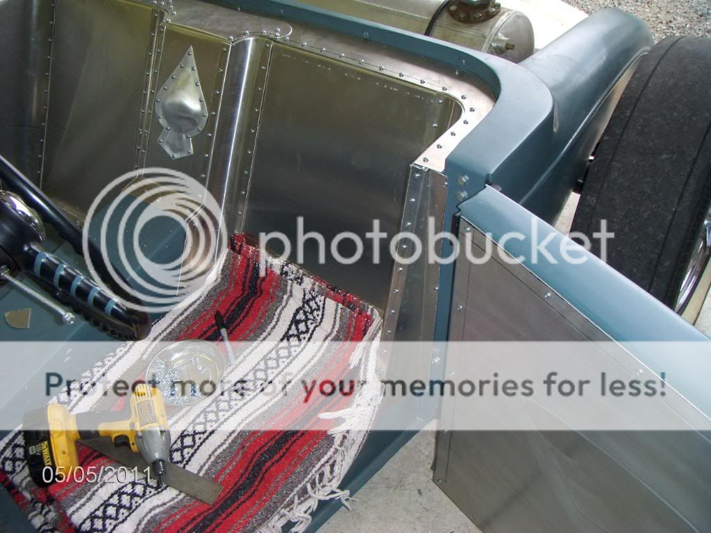

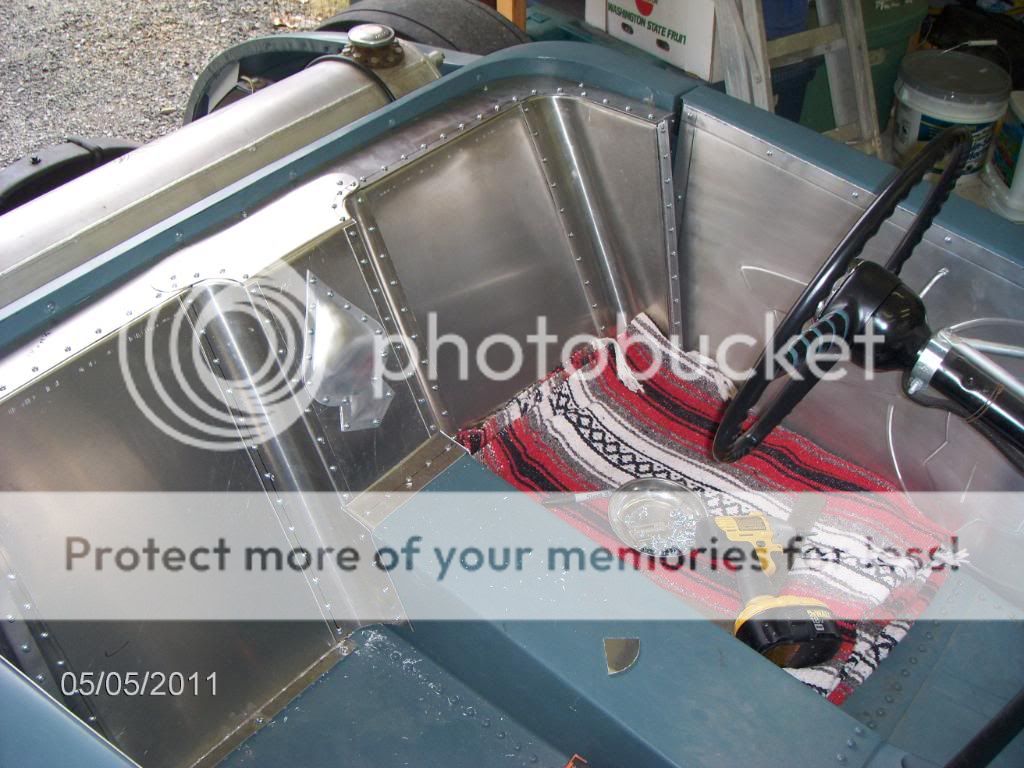

    Time to blow the dust off this old thread. I've been faithfully ignoring the car for a while working on other projects, but have managed some work on the interior.

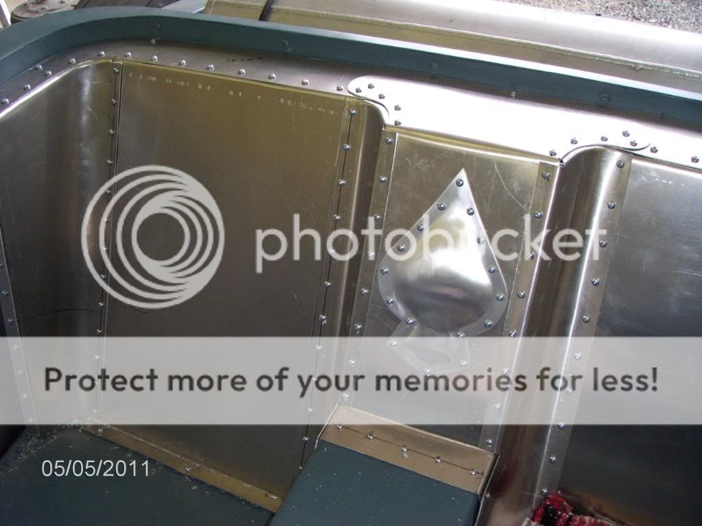

    A few weekends ago the guys from the knuckle sk****rs were giving me grief about my "ol skool rodz" spade shaped brake line brackets:D
    I had built a portion of the aluminum seat and was triing to figure out a centerpiece, after a little mild ribbing I figured some retaliation was in order. This started my first real metalshaping episode(at least first somewhat succesfull peice") I think it adds something, :rolleyes:
    The seats are made from .060" aluminum, at this point they are just screwed together I still need to pull them apart dress the edges and fancy them up with some bead rolling. I'm hoping to make them look similar to radiator shroud. I'm prepping my wife for a few hours of bucking Rivets;)

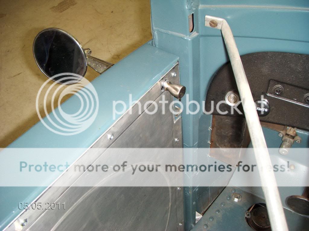

    I also fitted some door panels I had made a few years ago out of aluminum.
    After triing to fugure out inside and outside door handles I settled on a low tech knob directly attatched to the bear claw release lever, It works well from inside or outside. The knob I hate to admit is straight off home depot's shelf.
