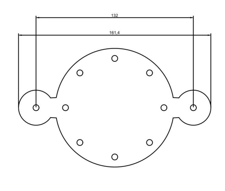

  20. 8B5106F2-E784-439E-9AEF-AB3E70F2D4C4.jpeg As promised, here is a dimensioned
    drawing for the back of the shock. All measurements are in metric MM.
    In terms of how they work at the minute I can’t share too much as there’s possibility of patent approval,...sorry I like seeing that kind of detail myself to! As soon as I am able to share that I will.

  21. hotcoupe
    Joined: Oct 3, 2007
    Posts: 647
    hotcoupe
    That comes to 5.19685". You're welcome. Looks like a quality product.

  23. Kiwi 4d
    Joined: Sep 16, 2006
    Posts: 3,950
    Kiwi 4d
    Do you have side on dimensions please? I can certainly understand not giving secrets at this stage. Off shore would be snooping for sure.

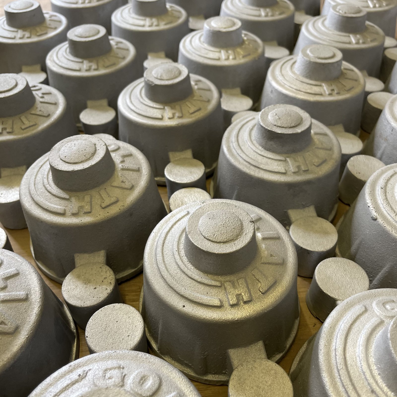

  27. Just thought I’d update this thread as I’ve just received the raw castings from the foundry for the first batch of shock absorbers. Bring on lots of machine work and finishing!

    milwscruffy
    MM x 25.4, being a machinist had it's perks.
