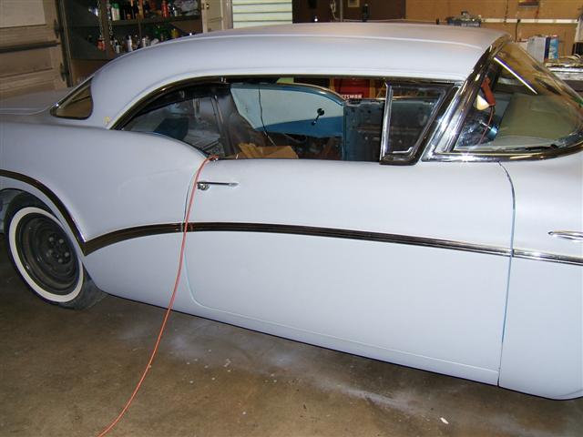

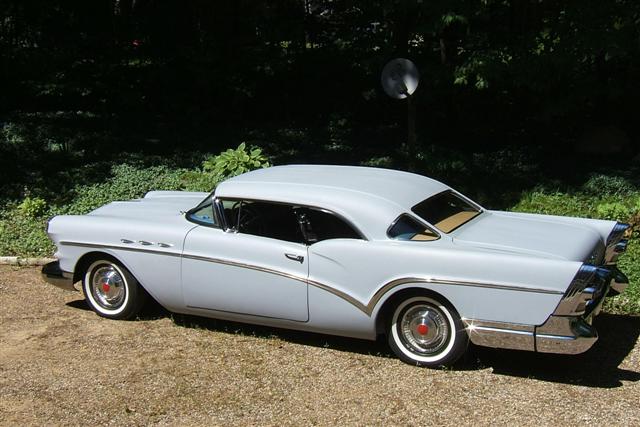

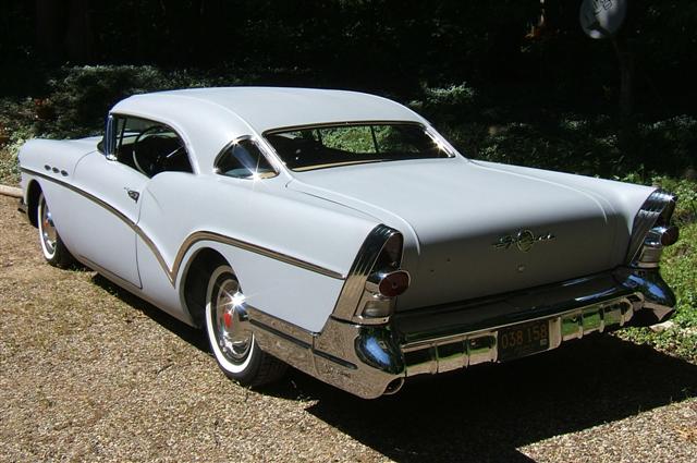

    chopped top 2 3/4" windshield sunk also rear windows the rear
    wrap arounds require to much work -----
    did work myself when I learn how to send pictures on this site
    will post

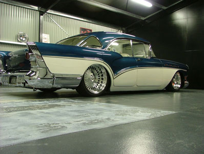

    Pics didnt work keep trying it will happen . heres a pic of mine.
    I would paint a pastel colour looks more old school i think.....:D

    Buick57 and Twochops - your cars are spot on perfect. I'm starting to get real bored with my '48 Caddy convert and really REALLY like the '57 Buicks. Your cars are giving me palpitations. I think I have found my next ride.
    Let me say it again, your cars are perfect!!!

    Where are the tires on your car? I see some rubber bands on the rims... :eek:
    Lexan? Not acceptable.... Not a bad job, at least you used the front glass, but I have yet to see a '57 Buick chopped where there wasn't some glaring issues with it, at least in my eye... Like the vent window and windshield no longer being parallel, or at least it no longer looks that way, may just be the trim. Being as the '57 is my favorite car I tend to notice these things. I also think it messes up the proportions to the body. If you put a 4 door next to four door you can already see the 2 door is shorter to begin with.
    Not a car that needs chopping....

    Most stories about chopping tops with wrap-around windows usually ends by saying just that the windows were sunk, but not how. Why? I think it's because it can't be done with pictures -- it takes words, a lot of words.
    Many have asked how I sunk the windows on my Buick. The advise is what I was told "Just cut a slot and sink them!" I wasn't happy with the answer, but it did work.
    Before continuing, let me state that this was done at home in a 2 car garage, alone without all the men and equipment that a body shop would have.
    Remember the question is how did I do it, there are probably much better and easier ways.
    Starting with the top, a 2x4 wood A-frame was made to hold up the top after it was chopped-- see pictures. 2 3/8" spacer put on the A-frame were removed after a 2 3/4" cut out of the windshield posts. Rear was cut out to drop top an even 2 3/8" -- see pictures.Because of the slant of the windshield posts, when the top is lowered in moves back approximately 1". (the top was never removed from the car, just lowered onto the wood supports.)
    I wanted the top to look stock when finished with factory style gasket and s/s.
    At the upper front edge of the top no changes are required. The front at the cowl is where the sinking begins. A slot must be cut at the gasket mounting flange ( inside the flange) from one windshield post to the other side. Start at approx. 1/2" to 1" slot -- kept cutting and trying to install glass until it can be installed without the glass touching any metal. I installed mine approx. 20 times before this happened.
    When windshield is installed it lowers the lower rear corners of the windshield into the dog leg. This is why on a Buick 2 3/4" is about the most you can cut out of the post it you are going to sink it.
    Things to remember -- what you cut will have to be resupported. Example -- the mounting hole bracket for interior moulding and top of dash, etc. A small piece of metal must be welded to the mounting flange at the windshield post.
    If you are after the factory look some area of the windshield gasket must be cut in two pieces so half of it is fastened to the glass on the inside and the other half on the outside.
    I installed 1/4" hard rubber pads and made a lot of brackets and supports before the windshield was installed.
    This is a very condensed information but as you start your work it will start to make sense.
    So before anyone complains about my answer -- remember the question was how did I sink the window -- not what is the best known way! I hope this helps.
    Enjoy the Ride -- twochops
