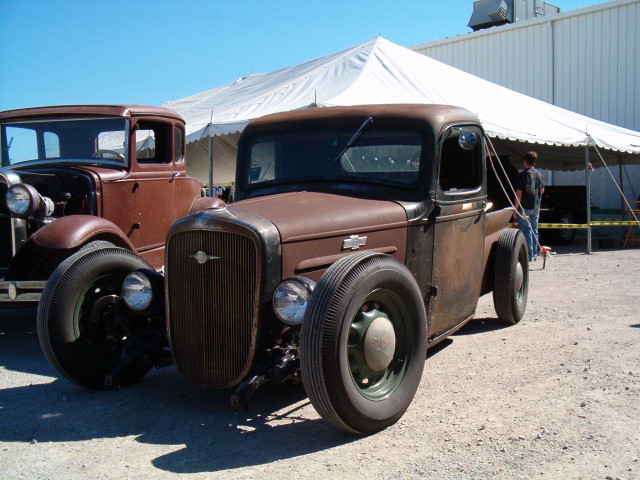

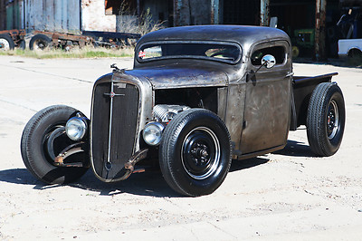

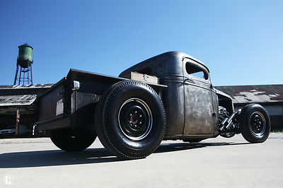

  1. I want to see a dead on side shot.
    That front hanger and radiator are way out front
    Short springs get stiff and then ride like ****.
    Here's a 30s poncho and the springs are huge and at least the tire's radius out front of the grill.

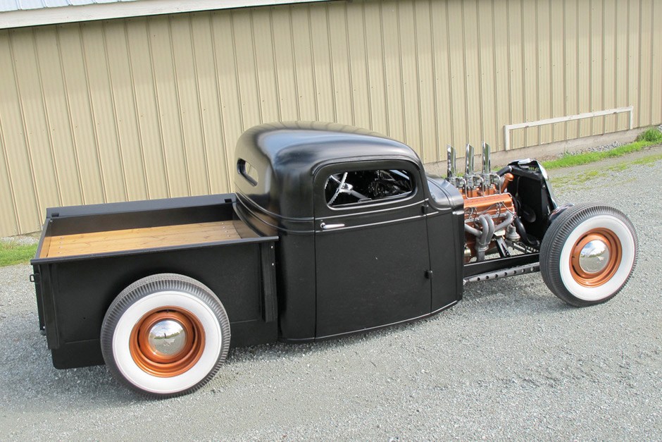

    The only thing I woud do different,is making the bed taller and lower..or fab a skirt that matches the profile of the cab..like the picture of the black one i posted in my second post.

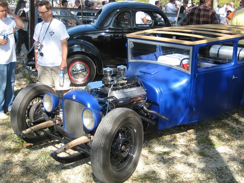

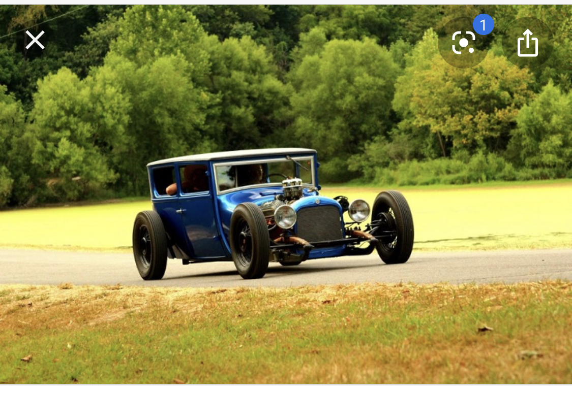

    I'm betting the truck pictured above is Zeed on both ends under the cab. The lowered truck also has the radiator at about the same location as the axle, and the motor is sitting back behind the axle. In all fairness, I would be concerned about this truck p***ing the scrub line, the ***umed to be trans crossmember hanging under the front of the cab will surely be on the pavement if a tire blows out.
    A few things of note on the black flamed truck 31 Vicky showed are that the radiator is sitting ahead of the wheels and the motor sitting above the axle, so its sitting much higher on the frame. The frame also extends forward of the spring end, and the frame is much thicker above the front spring mount. If the goal of this truck was to get as low as possible, it was poorly executed, but I suspect the primary goal of this particular truck was to have a quick hot rod driver.
    How to accomplish the low truck with 4 leaf springs?
    Mount the motor behind the front axle, so just the heads are above the frame. Mount the rad just in front of the axle so the grill can cover the front of the axle. Either Zee the frame under the cab on both ends, or channel the cab over the frame. End the rear frame behind the rear spring mount. Trim the front of the frame just ahead of the front leaf spring mount, and tapper the top to just above the spring mount and box the ends.
    If your not concerned about scrub line, you can mount all 4 springs on the outside of the frame rails and raise them up on the frame sides until you just have enough clearance between the axles and bottoming out on whatever. Technically, you can drop a 4 leaf frame about as low as you want to go, you just have to modify the frame to clear the axles, and shift the motor to clear the front axle and have enough room in the cab for the driveshaft tunnel to p*** through.
    Whenever you want something as low as it will go, compromises will be made. The number and severity of those compromises will depend on how low you want to go. Gene

    You could get really low with parallel leafs by going to undersprung setup. I don't have a pic handy, but the leafs are on top of the frame. You have to completely reverse the springs to make this work; reverse meaning changing the position of the leafs except main to be on the opposite side of the main spring than it is for typical spring under the frame. It also needs the spring hangers to be relocated of course.
    No dropped axle needed with undersprung, but will likely be close or under the scrub line.

    I agree, that black/flamed truck in the pic above looks like ****. Everything is wrong.
    The bare metal truck is done much better.
    Just gotta think it through.....good proportions are a must regardless of what front end you use.

    Chevy trucks of this era had the front spring mount beyond the end of the frame rail. There is a bracket that was riveted onto the front of the frame rail that the spring and bumper mount to so the front mount is about 1-2" beyond the front edge of the frame.

    your cab has a fuel filler hole in the p***enger cab corner and it has a flat windshield. that makes it a '38.
    the doors have holes over the window for the rear view mirror, i believe that is 40 only. the earlier cabs had the mirror on the hinge. they will work fine
    the black truck with the flames is on a '49-54 frame, i am guessing, and the axle sit in the wrong plane as 31vicky noted.

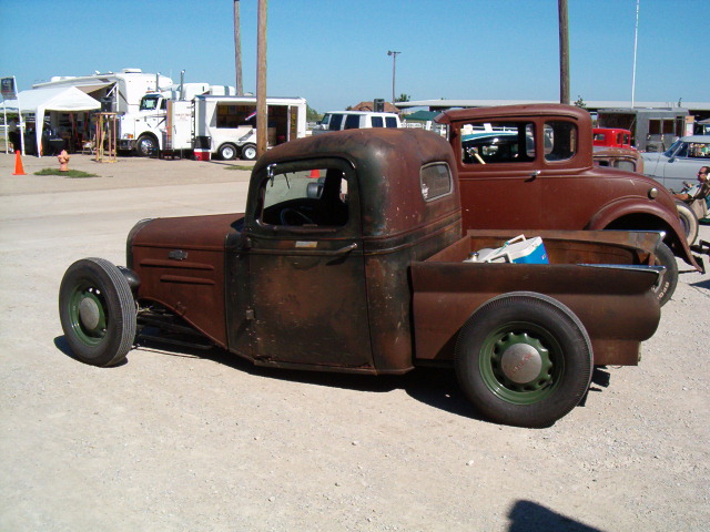

    Can u guys tell if this chop was done cutting the roof and adding a strip as needed?
  10. K13
    Joined: May 29, 2006
    Posts: 9,891
    K13
    It would have to be with that much chop. You can see the fill piece in the window frame in the side shot you posted in #35

    :eek: I think I see where they added a strip......

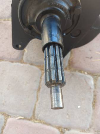

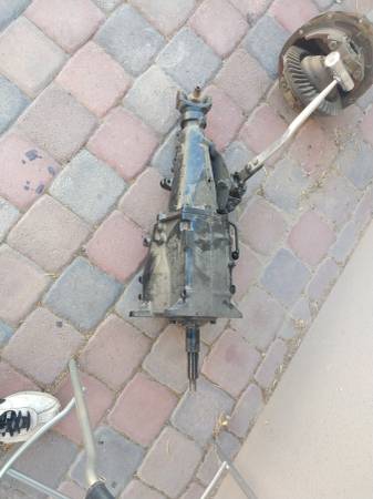

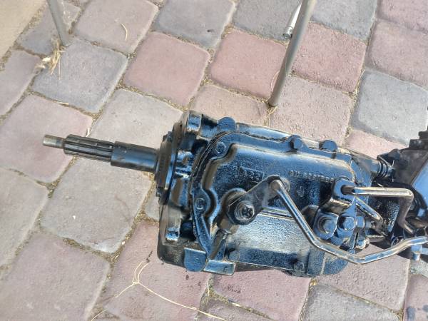

    Hello guys...on a side note..im wantig to buy this transmission...
    Is this a 4speed saguinaw?
    00l0l_X6KbjdMuCF_600x450.jpg 00z0z_iYNOv2vRvc5_600x450.jpg 00d0d_bzLG7k7Chb9_600x450.jpg 00c0c_iN01n01ZOnF_600x450.jpg
    tb33anda3rd and Blownfuel like this.

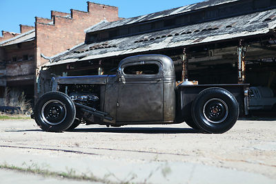

    ...always liked this one...
    Okie Pete and nunattax like this.

    That’s also a Plowboy built truck he called it “Seahag” it was literally put together with stuff he had laying around. It’s been gone for several years now so I may be wrong, but I think it ran a ford axle and transverse spring. His Space truck was built with Chevy parallel front spring set up. Johnny Sparkle built a really cool T Sedan with under slung parallel leaf front end.I know he drove the **** out of it so it must have worked pretty well.
