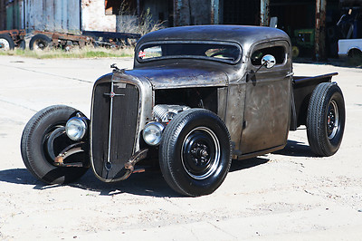

    Another bad *** low cab truck is
    This was built by @STEELJUNKY also in Utah. I'm not sure if he still has it.....I haven't seen him in a while.

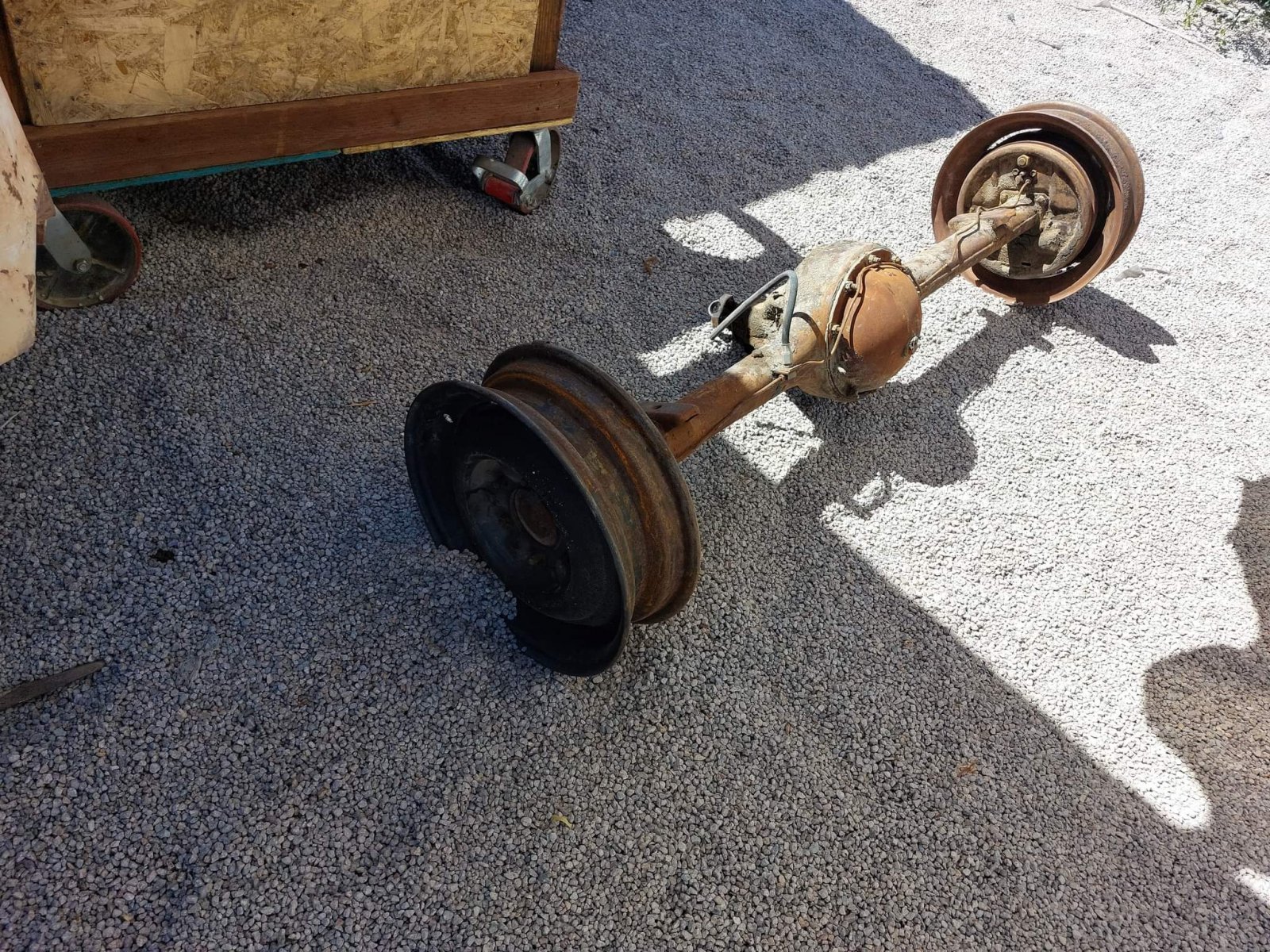

  4. iwanaflattie
    Joined: May 14, 2011
    Posts: 4,204
    iwanaflattie
    Sorry about the late response.

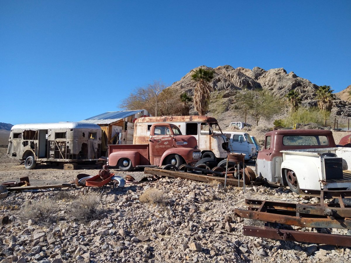

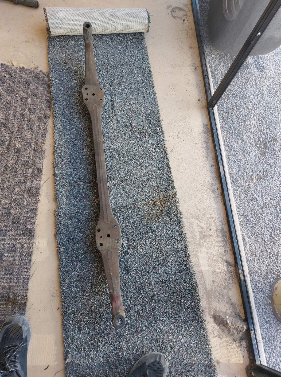

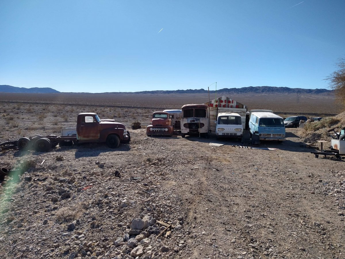

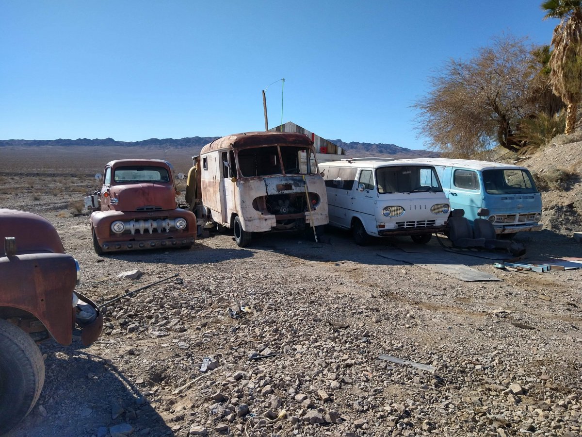

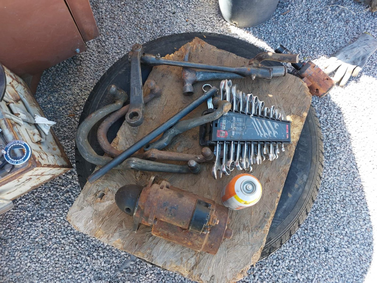

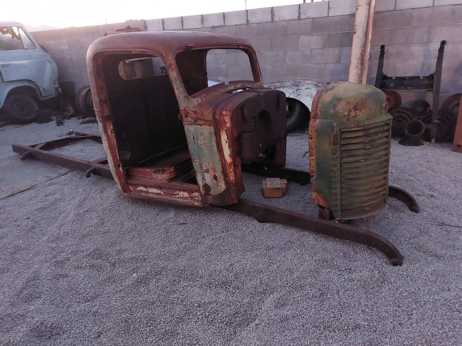

    Im going with the 35 frame with 1950 front axle,juice brakes,55 rear axle,6 lugs and parallel leaf springs all around..
    A 270 gmc with an ellis dual intake and homemade split exhaust manifold,I came accross a 69 muncie 4 speed today so.ill pick it up after work...
    Hope to find some time to work lt...projects keep ac***ulating
    received_407465300542181.jpeg received_459771698528492.jpeg received_261723265306866.jpeg received_120015736685083.jpeg received_127213909271705.jpeg

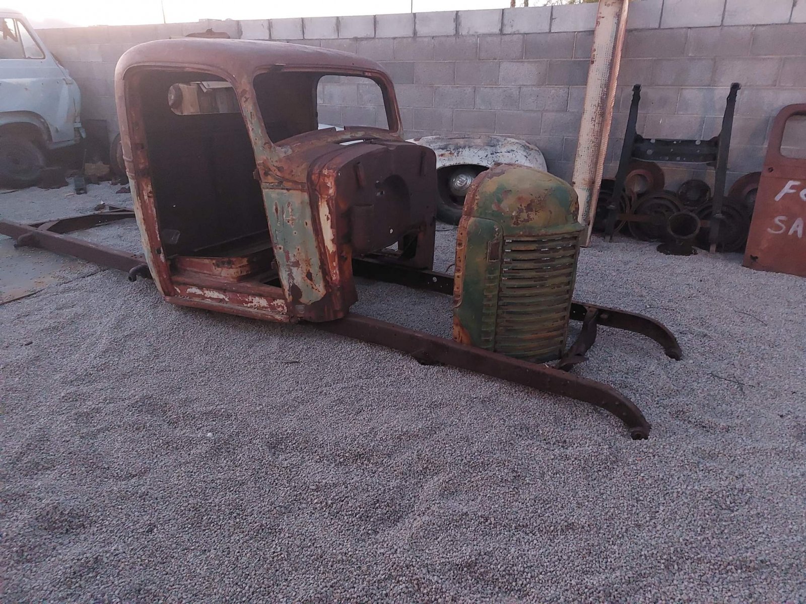

    Found a frame and started mock up...
    I'm going to spot weld the axles so I can bolt wheels and tires to move around the yard..
    This frame is pretty stout.. 3/16" thick..

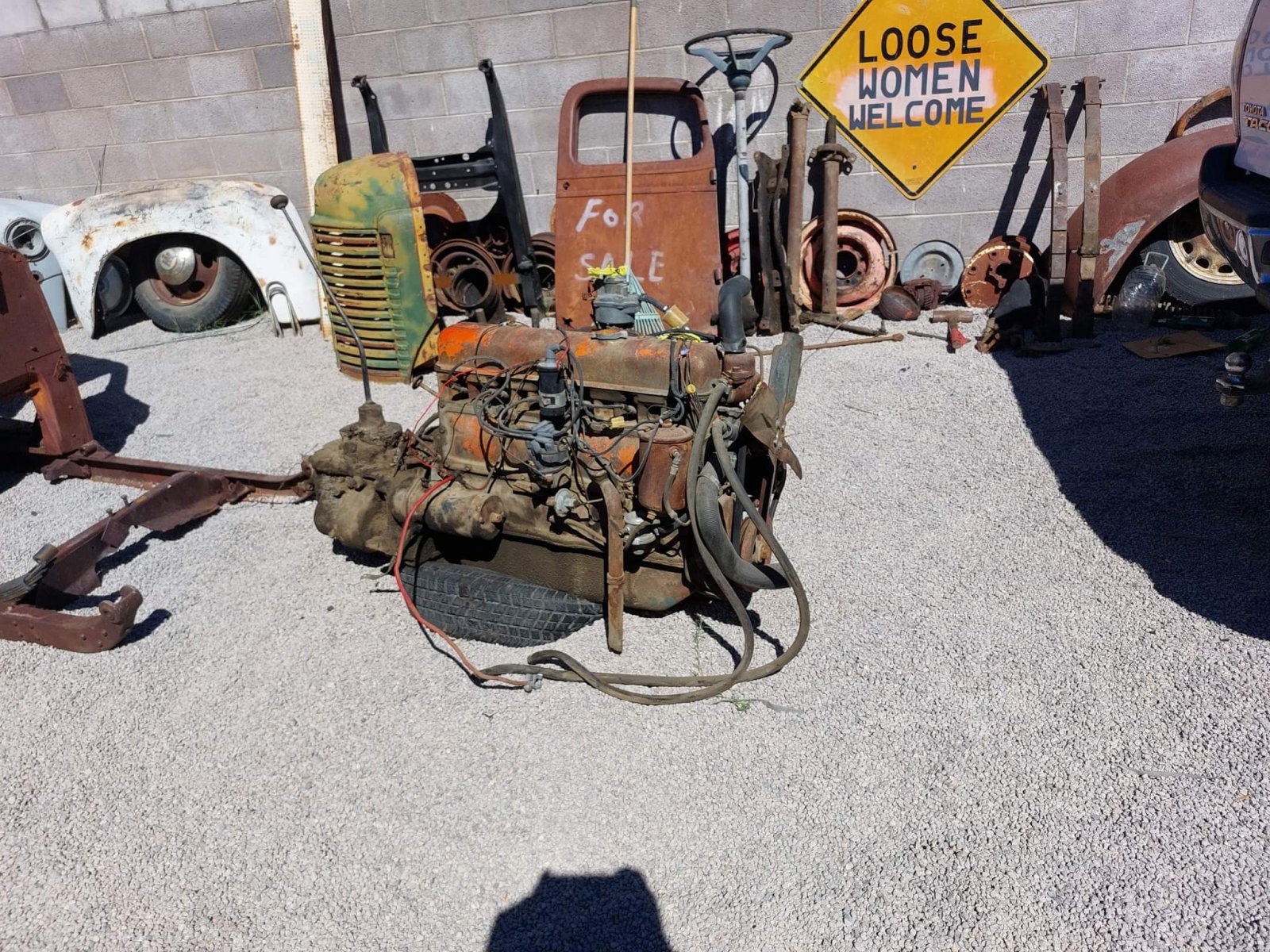

  11. iwanaflattie
    Posts: 4,204
    iwanaflattie
    The big truck frame is wider and the front and rear leave spring mounts are different.

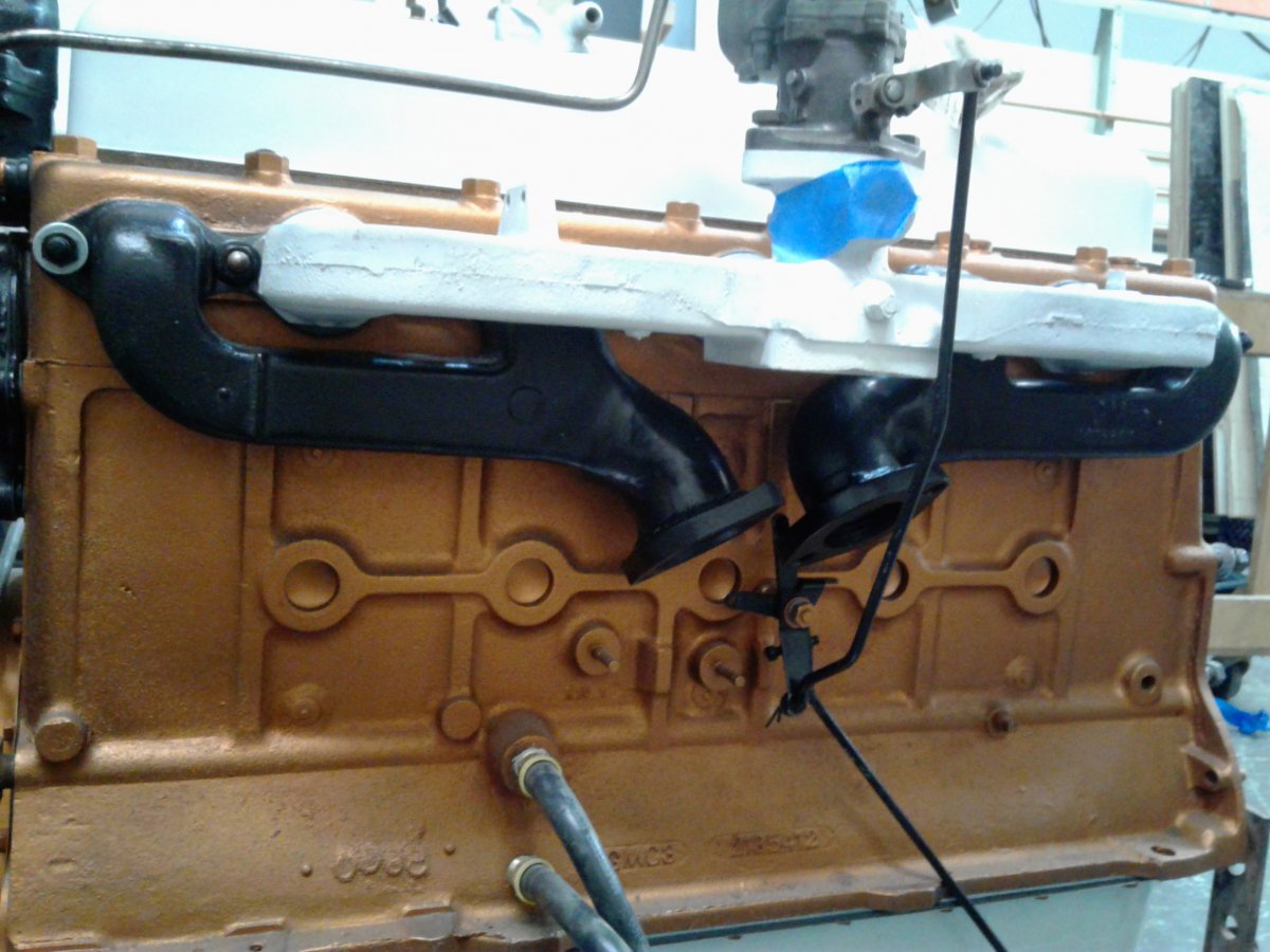

    I made these a couple years ago,I think I'm gonna make another set,
    I also have an Ellis Dual manifold with matching carbs. 20180321_201515.jpg I think I'm gonna have to steal them from my TV stand.
    Just Gary, tb33anda3rd, RMR&C and 3 others like this.
  22. iwanaflattie
    Posts: 4,204
    iwanaflattie
    You can see the dual manifold here
    tb33anda3rd, RMR&C, F-ONE and 2 others like this.
