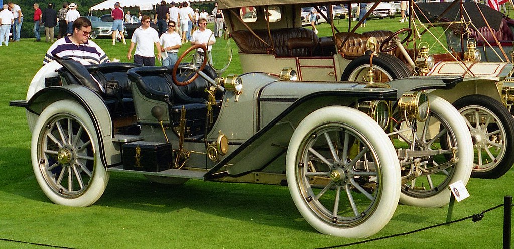

  8. Mr48chev
    Joined: Dec 28, 2007
    Posts: 36,248
    Mr48chev
    If you are going to run the rear as underslung, yes you will.
    I wouldn't be investing a lot of money in wheels and tires until I figured out exactly how low it is going to sit with all the weight on it but my guess is that you will be hunting for at least 18 inch wheels. The American Underslungs had pretty large diamerter wheels on them. When you look at bottom of fame to center of hub distances that car would be right on the ground with 18 inch wheels. American underslung gray.jpg
  9. iwanaflattie
    Joined: May 14, 2011
    Posts: 4,362
    iwanaflattie
    I got 17" artilleries that will put me about 1/2" below the frame..
