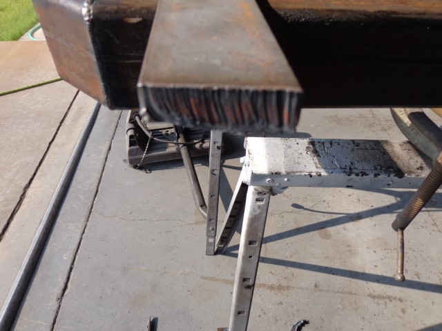

Can you tell us how thick it will cut? Maybe a picture of the results of cutting 3/8 steel. I have heard good things about their Tig machine.
Here's a couple of pics of the Prime Weld cutting 1/2". If I had the speed correct, it would have made a clean cut. This was at full power.

There is no doubt the pics of the Prime Weld cuts are better than my cheap one but as noted above, it all depends on your needs. I didn't need to cut anything as thick as shown.
