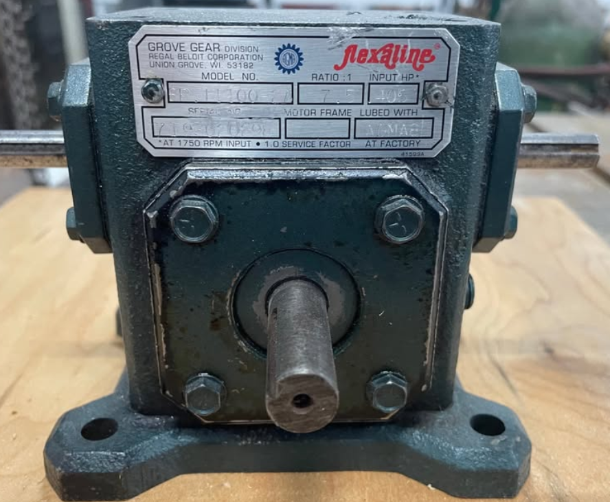

  20. alanp561
    Joined: Oct 1, 2017
    Posts: 5,477
    alanp561
    Would this 7 to 1 reducer work?
    Budget36 likes this.
  21. Budget36
    Joined: Nov 29, 2014
    Posts: 15,199
    Budget36
    That’s a beast! Have to see the output of my reduction motor is.

    gary macdonald
    Too big ( heavy duty )in my opinion.

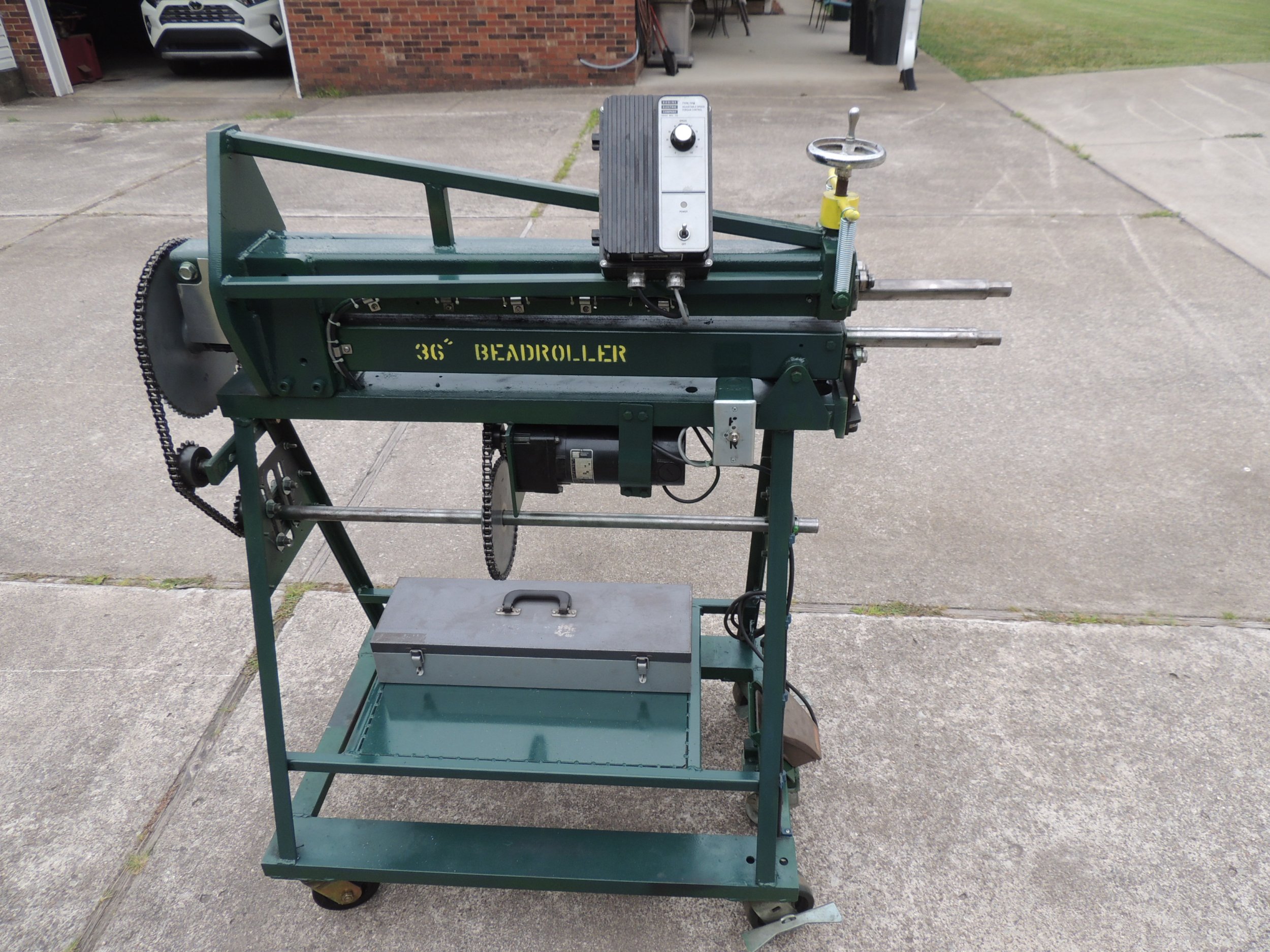

    ekimneirbo
    from Brooks Ky
    What is the speed of the motor that you have ? That will dictate how much you have to do to get it geared down.
    I'd say thats a pretty good reccomendation. Getting there may be a little harder to accomplish. I made this one using a reduction drive motor and still had to gear it a lot further. Notice the shaft driving the sprockets. This turned into a much more time consuming project than I imagined.
    rod1, brigrat and Budget36 like this.

    Budget36
    I need to verify the output RPMs. It’s a gear reduction motor, can’t recall if 5-1 or what it was. Then have to dig it out!
    I plan to make a stand for it and the motor. Put a gear set on the roller and motor. Also thinking of a slide-able fence to assist.
    Say 1750 rpms, 5-1 reduction and 10-1 gear set. Puts me around 40 RPMs.
    Foot controlled frequency and with the gear reductions, would still have enough “poop” when slowed down.
    Both pickup cabs I want to do, will have carpet in them, so perfection isn’t needed.

    Posts: 6,044
    brigrat
    from Wa.St.
    Thats a piece of art compared to mine! And a Linda Lovelace deep throat is a plus!
