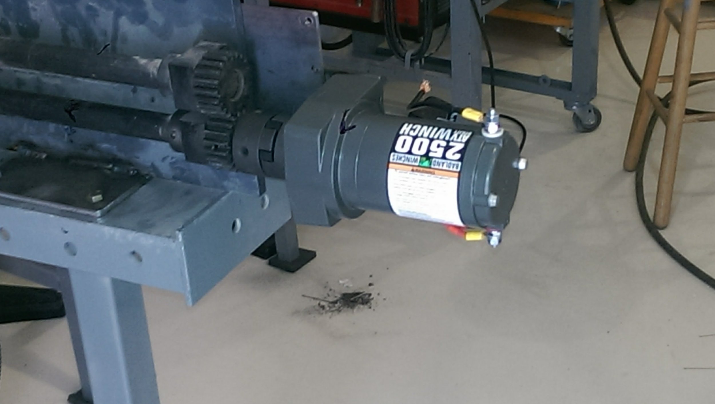

    Mine is a harbor freight special that I beefed up and added a motor too. Lots of mods but sometimes the mods are the fun part !! 20240110_170446.jpg

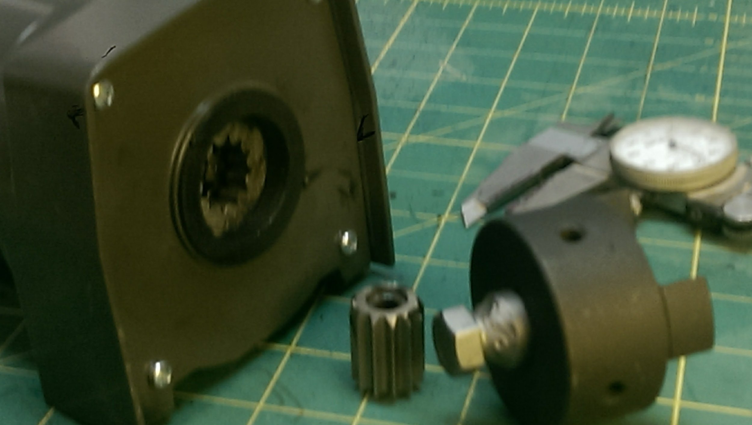

    IMAG0100.jpg IMAG0097.jpg IMAG0101.jpg hh IMAG0100.jpg IMAG0101.jpg IMAG0097.jpg

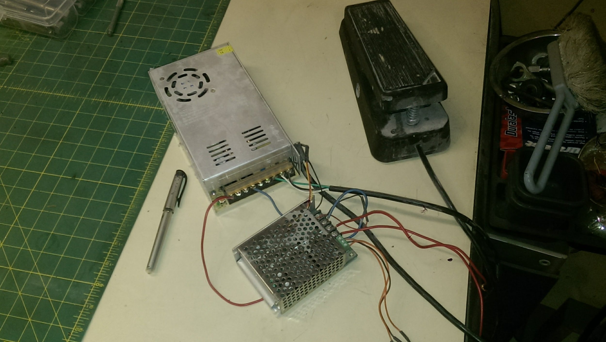

    Harbor Freight winch, spider coupler with a nut welded on to it, Amazon 12V power supply, Amazon PWM module and an old guitar wa-wa pedal

    @ekimneirbo yeah I looked at using different motors but I figured by the time I bought all the different gears, chain, etc I'd be spending more to try and save less.
    So a quick look on ebay and I had a motor that was low rpm and reversible. No gears or chains or a bunch of brackets to make.
    The switch on top is 3 way, left-off-right.
    So I ended up with variable speed and reversible....

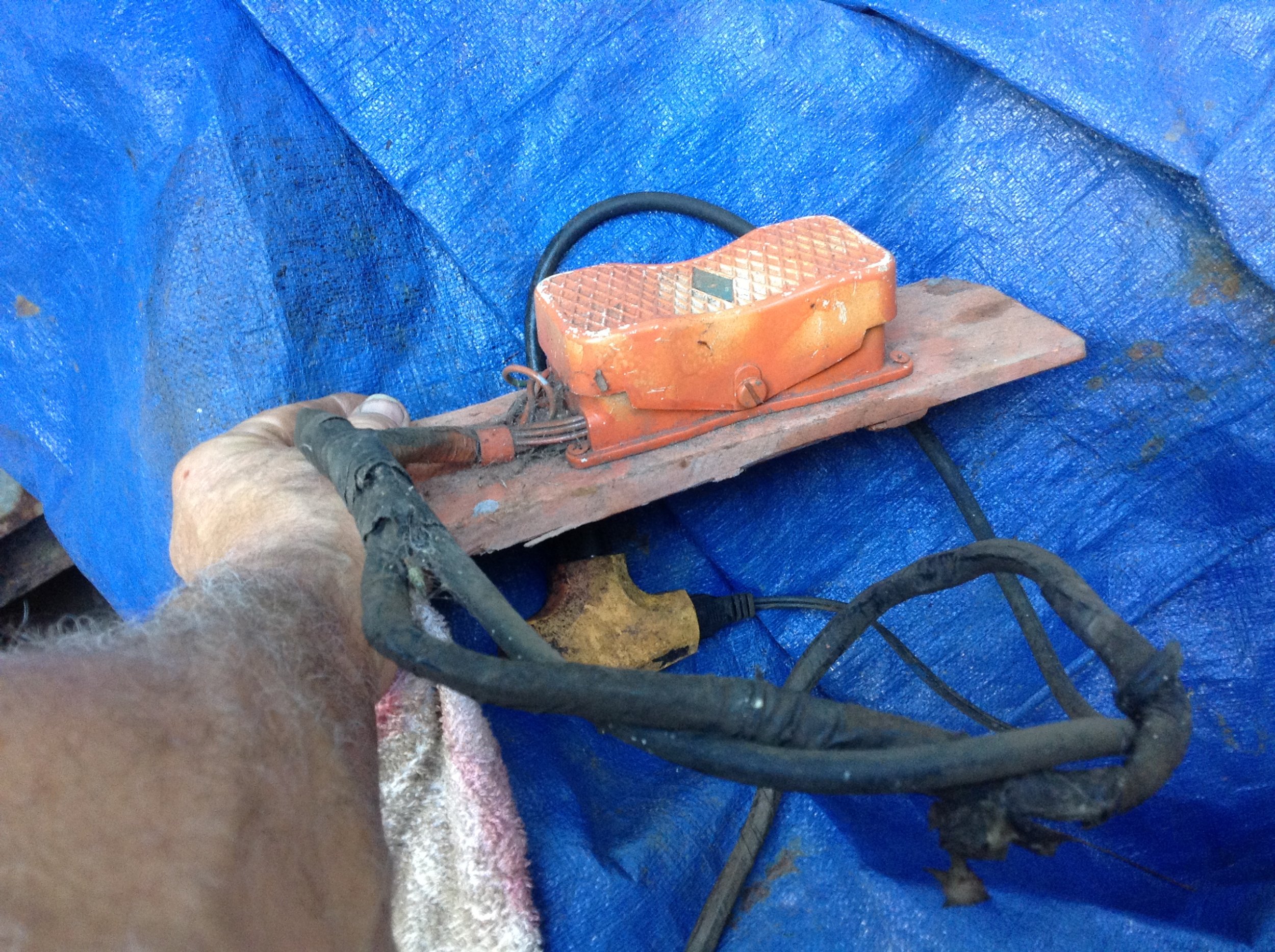

    I prefer a slower speed with decent torque. My current setup uses an 1/4 HP AC motor originally speced for a rotisserie. It's 6 RPM with 600 in/lb of torque which is overkill, as is the HP. I wired up a reverse switch and run it through a foot pedal control. It's directly coupled to the roller shaft with a Lovejoy coupling. I found the motor NOS for $30 at an auction selling off the inventory of an old electrical warehouse.

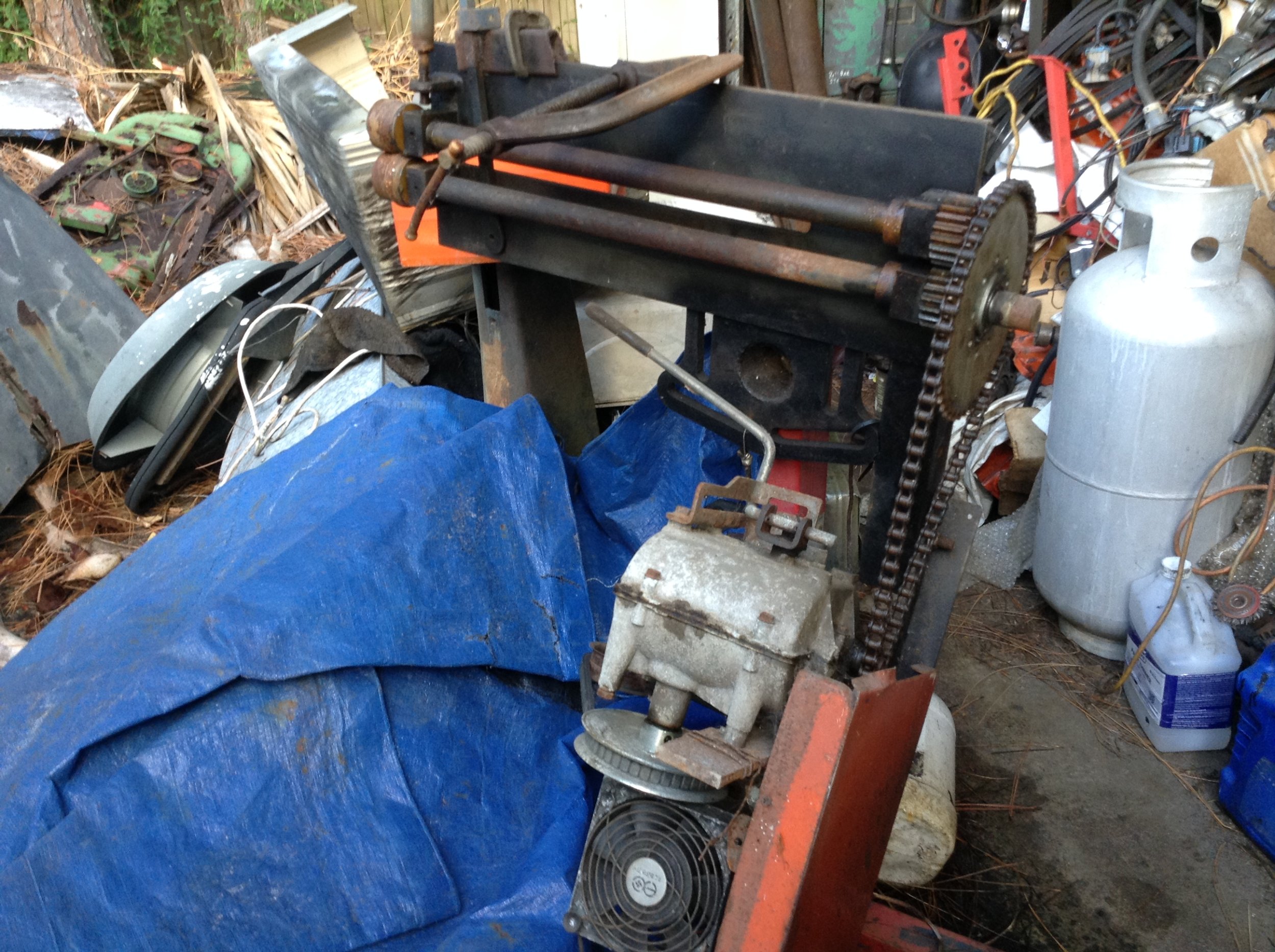

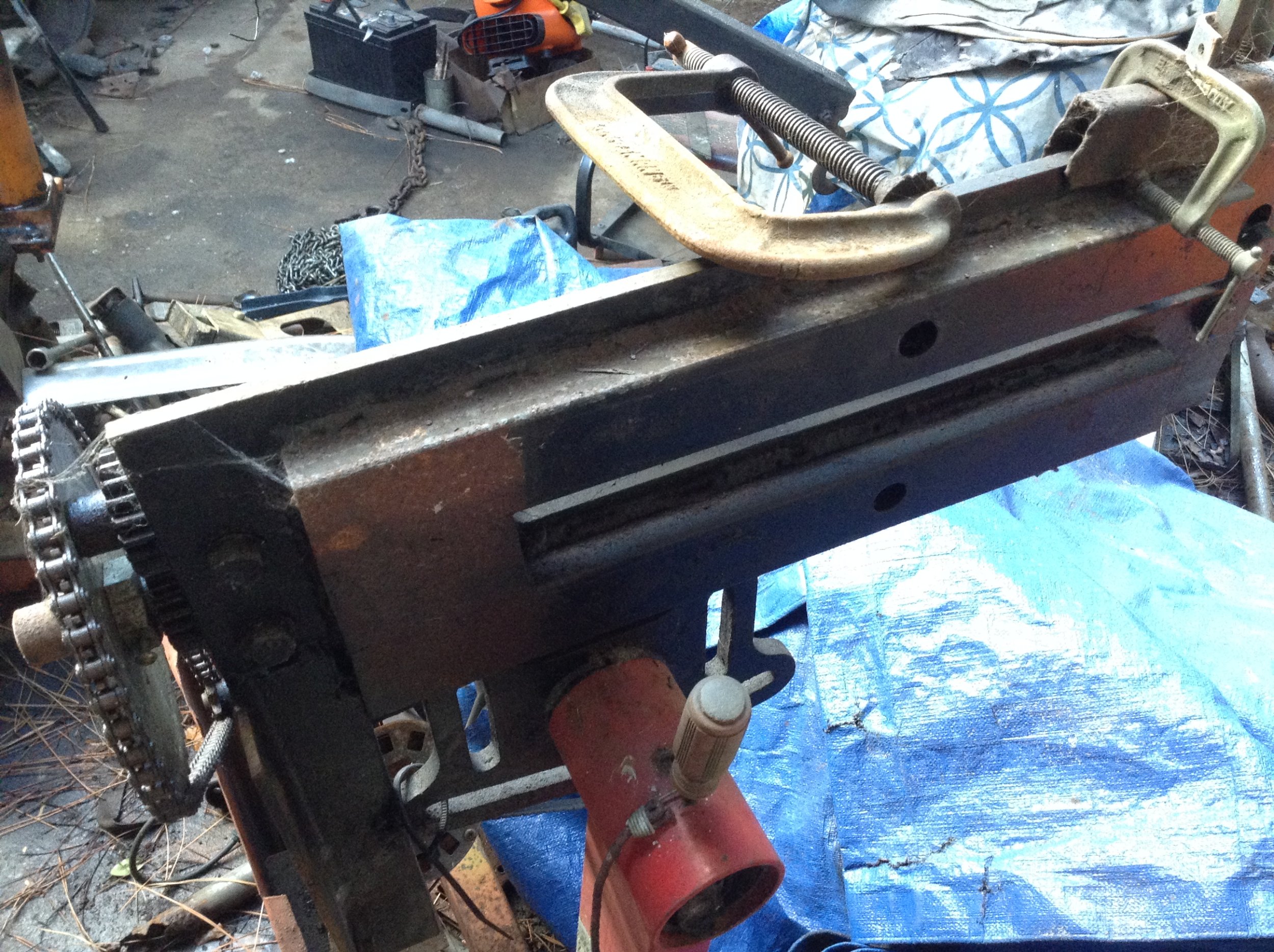

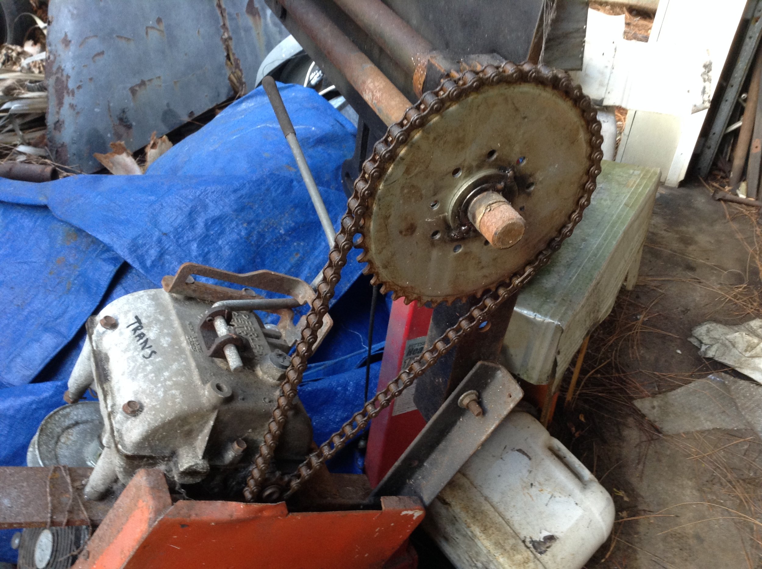

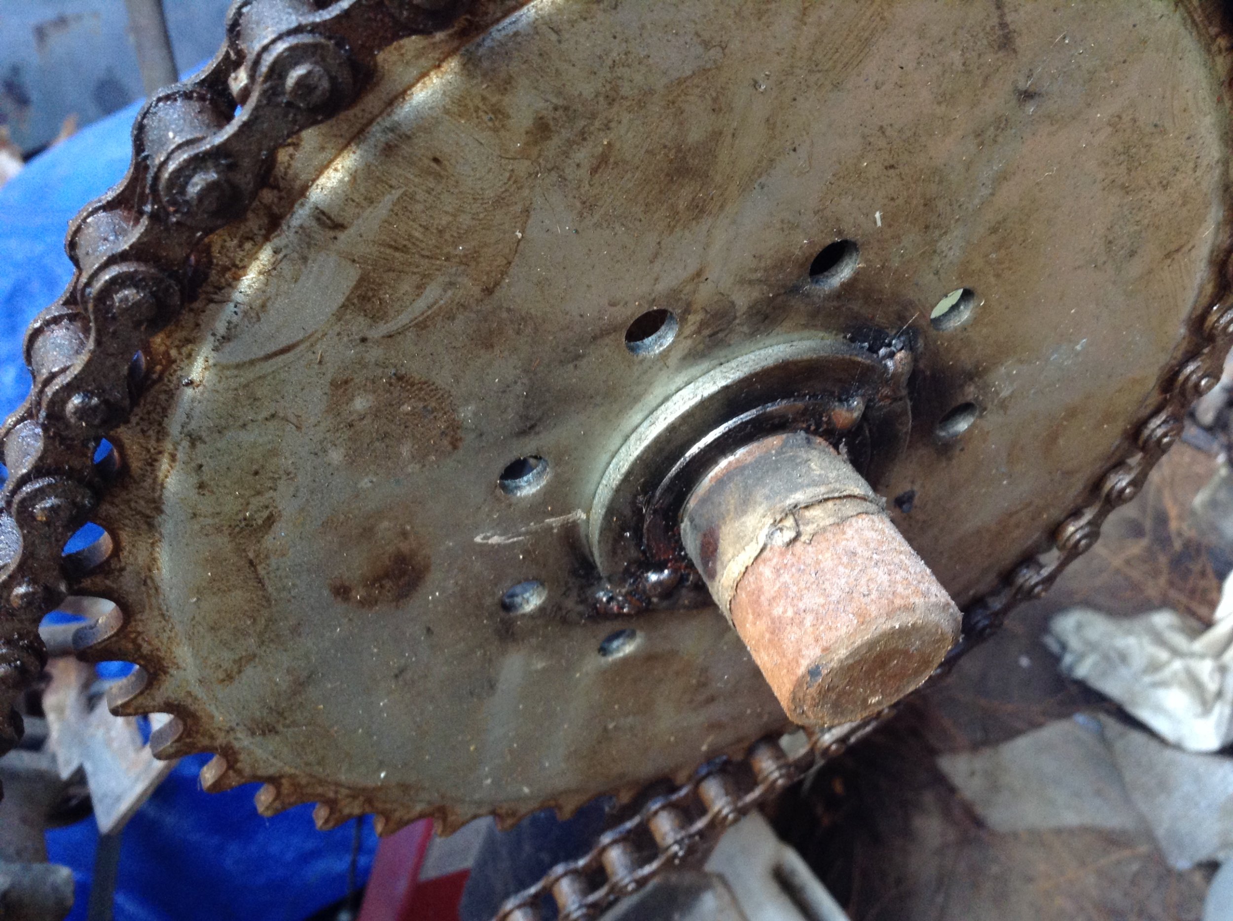

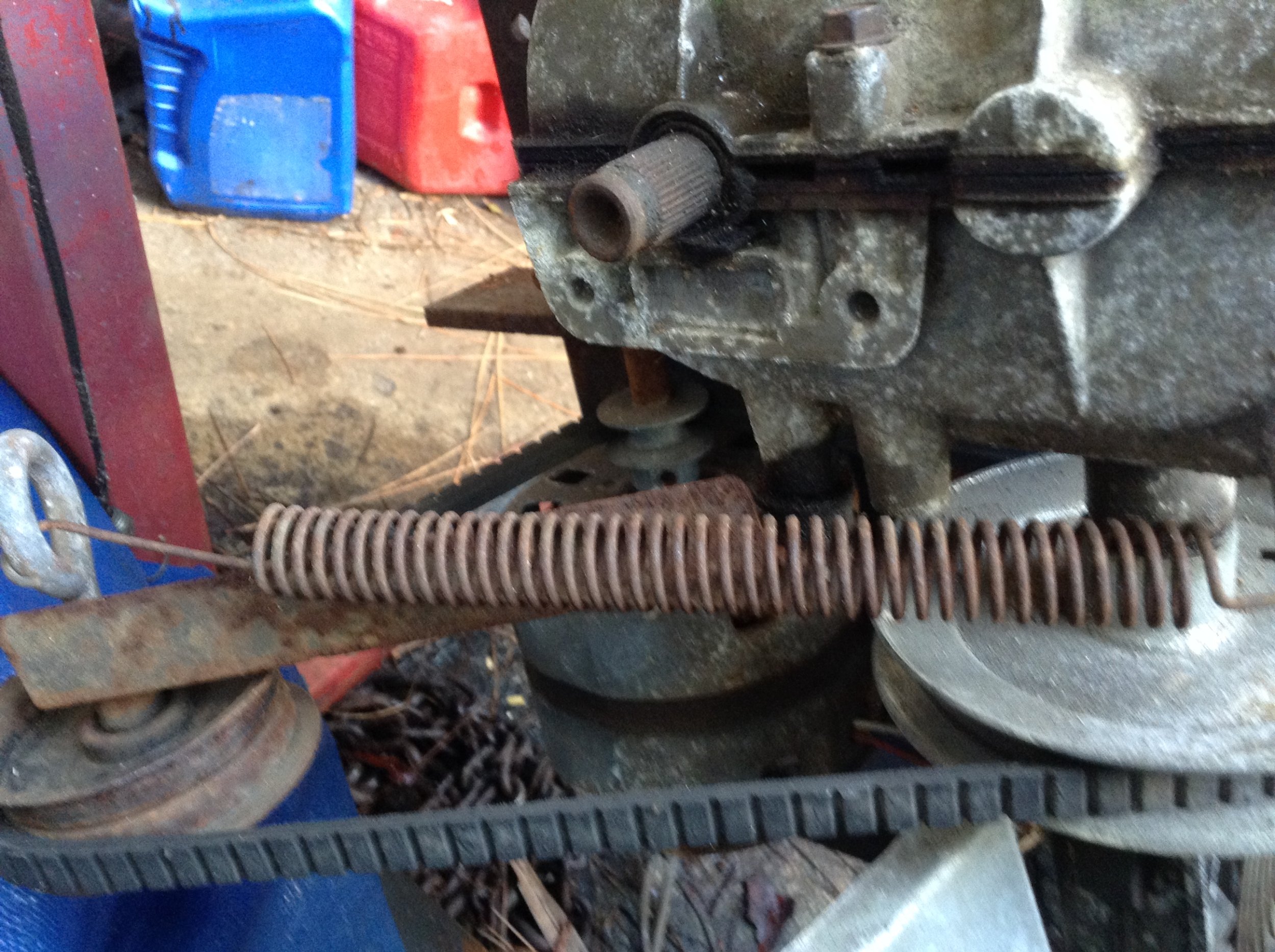

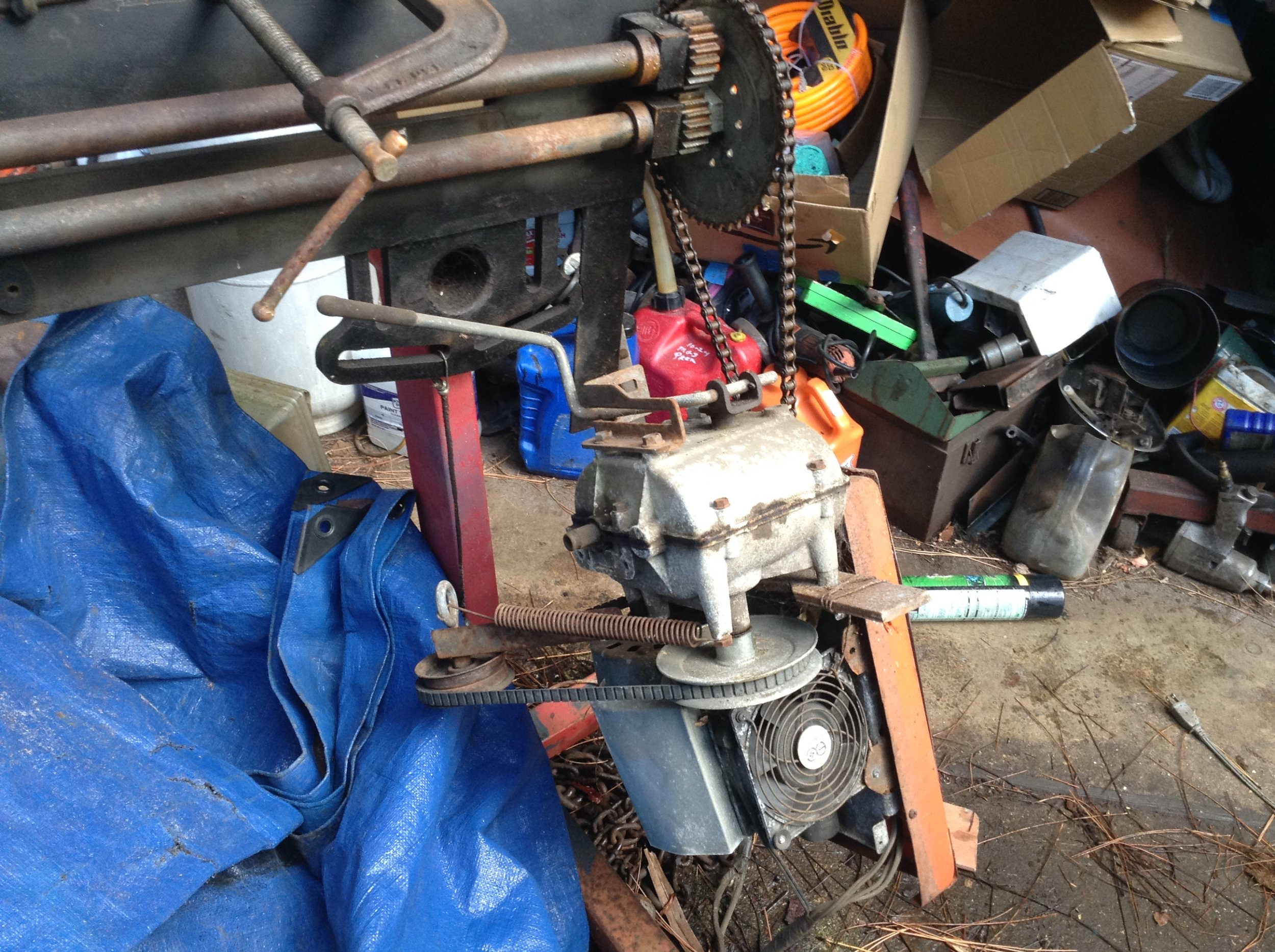

    While out in the shop this evening, I decided to look at the DC motor/reduction drive I used and refresh my memory on its specifications. It was 250 rpm with a 10:1 reduction.....25 rpms. Now that doesn't sound too bad to someone who doesn't know what they are doing (ME).
    But think about it again.........to get down to 6 rpms, I still had to reduce it 4 more times. It took me 4 sprockets and 2 chains to get there. I'm pointing this out so others don't do the same thing I did. Make sure what you buy will get you to about 6 (or a little less 3-4) at its minimum rpm before you go that route. May just need 2 sprockets or nothing, but figure it out before you buy something...............:D
