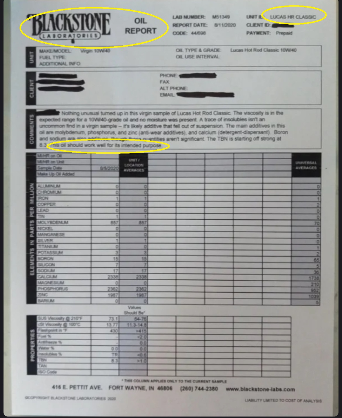

  1. https://pqia.org/lucas-hot-rod-classic-sae-10w-40-motor-oil/
    Lucas hot rod oil. Designed by scientists for older gasoline engines.
    it’s “worse” than rotella.
    which scientists are correct?
    any Lucas guys with messed up engines because of it?

  5. theHIGHLANDER
    Joined: Jun 3, 2005
    Posts: 10,594
