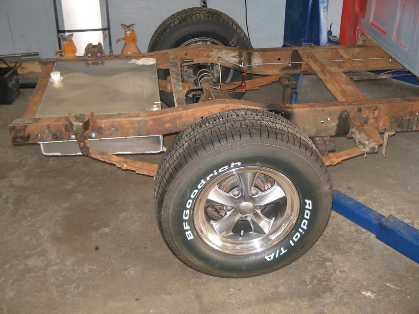

    ...buildin my 55 I flipped the rear spring hanger to the top of the frame,(flipping this hanger causes no clearance problems with the box/bed floor, there's room there)I used lowering shackles (which are only about 2-3" longer), placed the rearend on top of the springs; should work fine. All I had was the lowering shackles so I used them; using stock shackles you will not need the 2" lowering blocks.
    A gas tank from a 68-72 Nova (maybe clones) fits real well and are reasonable new if you can't find a good used one.
    here's the stance with motor/trans installed but no frt. tin., I used a 72 Nova front stub.

    That tank looks like a good fit and it's got great capacity. I think I just threw one of those into the last s**** run I did... I'll have to check. The only problem I may have is mine is a long bed. Looks like a great option for shortys.
    Thanks for the posted pics. I was wondering if I was going to have clearance issues with the brackets above the frame. Would the stock shackles work better than the lowering blocks? I didn't like how my '55 drove with the blocks... seemed more bumpy. Also, you moved the shocks forward because of the tank, right? Looks like a sanitary install anyway.

    Mike,...I think you could just use your orig. length shackles with the flip'd hangers and it'd work just fine w/o the blocks. I used the longer shackles only because they came with the truck and had no originals. As far as ride; I wouldn't think it should ride any different with or without blocks. I just used the blocks to get the ride heigth I wanted.
    I relocated the shocks because of the tank install but these should work fine as I've used this set-up in other trucks. I'm thinkin the rear part of your frame is the same design/dimensions as a 1/2ton; so I think the Nova tank should work. It's 16 gallons.

    ...you shouldn't need to move any crossmembers to install the Nova tank.
    If you don't flip the rear hangers; I'm not sure if that tank would fit as well w/o moving it further forward; as mine sits the fill pipe is just under the rear bedsill. I did notch the bottom of the rear bedsill about 1 1/2" for hand clearance..I'm gonna hide it with a flip-down licence plate.
