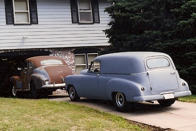

    Well preserved! Keeping the front suspension? I had a 50 delivery and a 52 el cheapo 2 door. Kept the original suspension for both. 52chevy_1981.jpg deliveryN48chev.jpg

  21. 56sedandelivery
    Joined: Nov 21, 2006
    Posts: 6,694
    56sedandelivery
    There is nothing "wrong" with the stock front suspension, as long as it's in good, solid shape. The SAME front suspension was used in the 1953 to 1962 CORVETTE's; the only difference was the center steering link pivot point. The front suspension "cradle" can be blocked up to raise the front end very easily. All kinds of aftermarket, improvement pieces are made for them also. And, I say keep the "big" steering wheel; plain and simple, plus, it provides leverage (power steering). Darn it, I want my 51 Chevrolet Business Coupe back, but I know what it sold for by the guy who bought it from me, and it's way out of my range now. Check in over on ChevyTalk.Org; there's a sticky on rebuilding the front ends, and a ton of other "advice" in the 49-54 Chevrolet forum. I am Butch/56sedandelivery.
